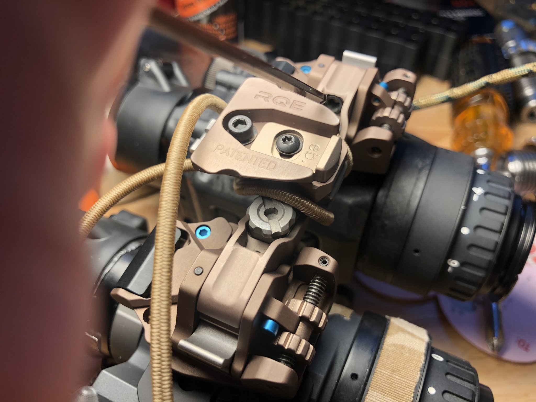

    Would like an opinion from the gurus out there on selecting a bridge system that can be used with a NV monocular and thermal
    Looking at a WP, unfilmed PVS-14 and perhaps a NOX.
    Any opinions on a bridge and my choice for the optics is most welcome
    Nothing wrong with your choice of optics. KAC RQE Universal Bridge would be the ticket.
    Reactions: Dvlray6
    Seems like a marriage made in heaven...thank you
    This is the way. With all of the different adjustable clips and mounts, it is the most flexible system on the market. And very light. And a piece of engineering mastery. And spendy.
    I have both, the Universal KAC Bridge and the Mod Armory D14.
    The KAC has significantly more moving parts, and while it's nice to have lots of adjustment, it's not as "tight" as I'd like. That's a Wilcox Shoe issue. None of them seem to have the exact same spec so there's variation in fitment. Good luck finding one in stock.
    The D14 is far simpler, has better tension adjustment, and overall is easier to use (by a little, not a lot). Easier to find in stock.
    If you're like me, you'll have to try both to verify my statements above. You'll be happy with either unit, I'm sure of it.

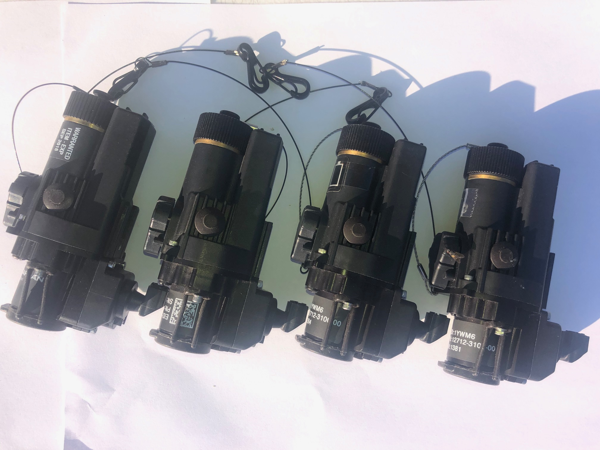

    I find the Mod Armory IC Bridge's to be very simple and sturdily built such as they do not have a bunch of overengineered pivot points etc which will develop "slop and wiggle" with extended use.
    I also run COTI's as well. Both the COTI and Breach perform pretty well in the role they were designed and manufactured for.
    Left to Right. Mod Armory Quick Detach, Mod Armory Original Lightweight, Mod Armory Current Lightweight.

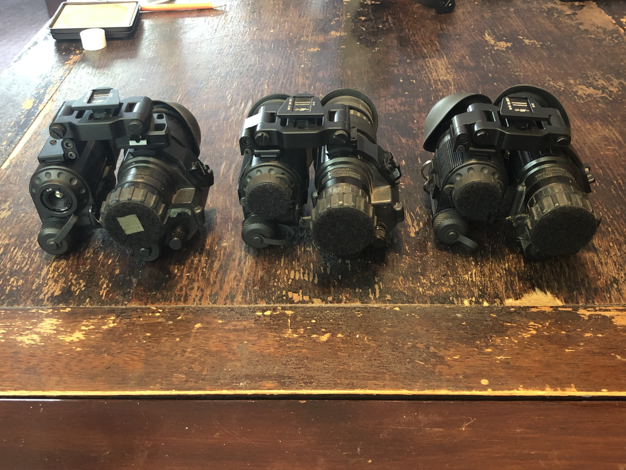

    If positioned properly on a bridge, thermal and I2 work very well together. No headaches here at all and it is extremely usable. For me, it doesn’t magically overlay one on top of the other(like my e-coti and binos do) but my view seems to switch between whichever has the more useful information at the moment. Of course, you can consciously switch as well without rotating the other one out of the way. It makes it extremely easy to navigate and scan for living things without a bunch of useless motion. The only trick I found was getting the two eye pieces in the same plane which was a matter of adjustment in the bridge and mount. I can easily say that since I’ve added the thermal, I’ve never gone home hungry. Before the thermal, it was hit and miss with I2 alone.

    @WhereNow&How
    In the video Will demonstrates “loose” by showing the PVS-14 just kind of falling back into place when he flips it up but not into lock position. There is a screw that can be accessed by disassembling the bridge arms from each other. I tightened this and it fixed the issue.
    The screw where I’m pointing fixes this and can make the movement more fluid/loose if one wants.

    @WhereNow&How
    Cool.
