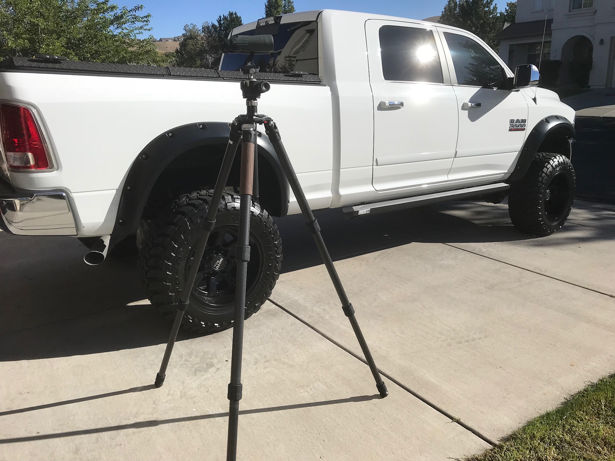

Just received my new more steady and taller tripod for my vortex 15x50 binos.
Just was looking into those, might have to save up becuase those are the only ones I've found with a comparable rifle scope reticle instead of a traditional ranging reticle
they are great binos...you can see impacts out to 850 or so past that it gets iffy but you can see target movement out to 1000yds(farthest ive used them)and im sure a bit farther...camera land has demo models for $400 bucks.
