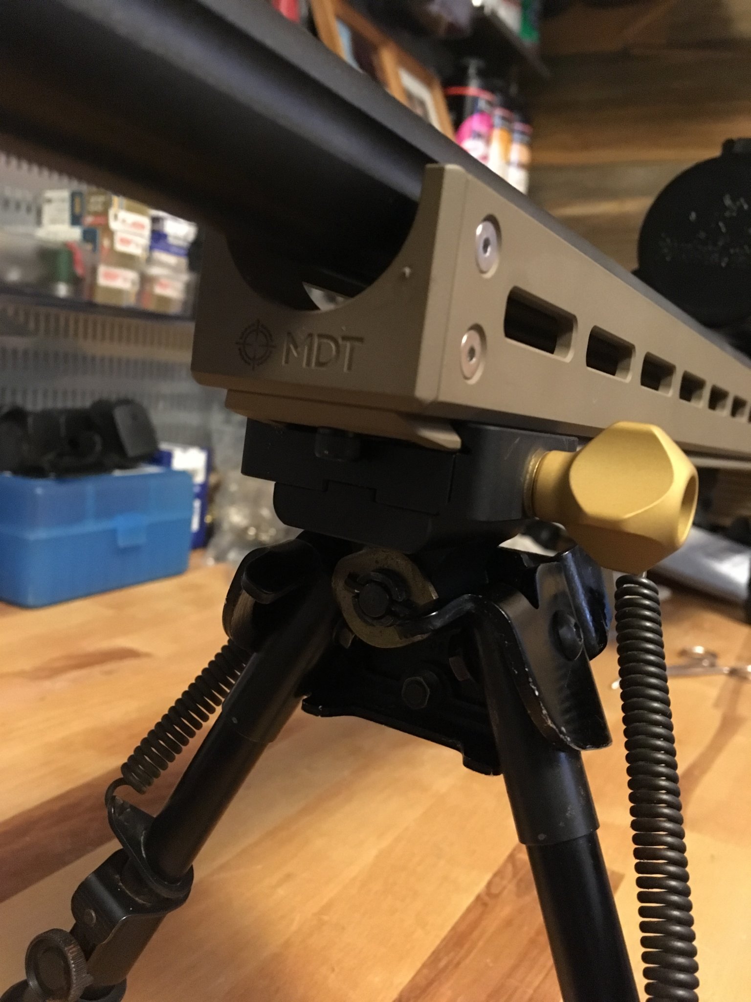

    I have the Area419 adapter with my harris on a MDT ACC.
    Harris mounts by sliding the clamp/adapter assembly off and replacing it with the Area419 part. That Area419 adapter bolts to the same ARCA clamp they sell for the Atlas. The adapter and Atlas use the same bolt pattern.
    The Area419 ARCA clamp can be used on the ARCA lock rails or “normal” ARCA rails. There are three set screws you remove to allow for non-ARCA lock rails. You can still QD the clamp from both types of rails, but lacking the lock allows for slipping back and forth.
    It clamps hard and I have yet to get any slip under a .260, but YMMV.
