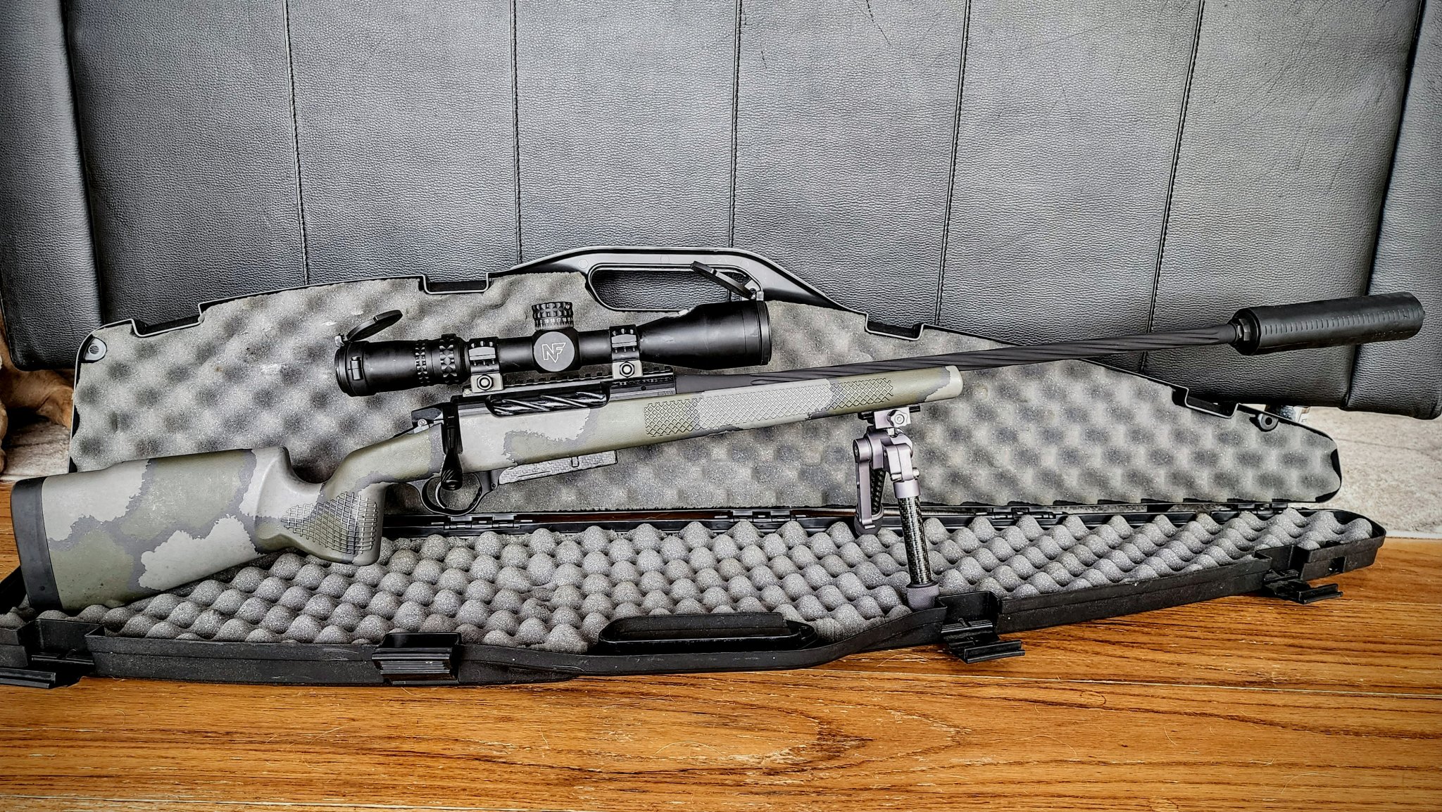

So I own the panning Elite Iron model. I bought it for a specific purpose and it didn’t really “pan” out 🥁 🎶
Ha sorry
I am primarily a prairie dog shooter. I use a 360° swiveling table that one sits on because I don’t feel like hanging out in PD turds and rattlesnakes. Plus the grass is sometimes too high for prone. And my old neck hurts. No prone for me.
I have this bomber X-shaped sandbag for a front rifle rest that goes in this table. 14lbs. I wanted to lower the weight to carry to/from the truck. I thought the EI panner would be great for small lateral adjustments, with large adjustments made by my feet swiveling.
It is great and works really well. The way the cant adjusts is the best out there. The way you adjust panning tension is via a T27 torx bolt on top. It has a tiny drop of red locktite on the bolt to keep it where you leave it.
I know this because it arrived without that drop and it disassembled itself on my family room floor as I panning around lol. Called the fellow (awesome guy) and he was chuffed at his workmen who forgot that crucial step. He told me what to do and he said I could send it back too if I wanted them to fix it. I did it myself because it’s easy.
So I guess you could try red locktite on that PSR, but only use a tiny drop.
The reason it didn’t work out is that it’s really fucking windy in the Dakotas, and I found that the heavy-ass sandbag actually was very important to stabilize the whole shooting platform. If I used the bipod I would’ve still have to add weight to the table, which defeats the purpose of the whole deal.

- if you leave it on your rifle, you will scratch the absolute living shit out of your barrel due to the feet and no lock-off panning. I resorted to putting a very manly red pool noodle over my barrel. Because I am that studly. EDIT: using their rubber feet solves this issue! No more tactical pool noodle!
- pic rail design requires a hex wrench to install and remove, no QR (however you seem to be able to order it with an Arca setup now—I think call to order this). EDIT: if you have a KRG chassis they sell a Sako-like QR that is slick!
- b/c of the slowness of taking the bipod on/off, one tends to leave the thing attached EDIT: see red bit above

But for lo-speed hi-drag me, pulling my rifle out of the case with the bipod attached was sort of funny.
First, imagine me pulling up to the range in a Magnum P.I. Ferrari, hottie beside me. First, you notice the hottie is Higgins, but you ignore that.
Then you see me cooly unzipping my rifle case and pulling the rifle out. “Damn,” you think. “That dude is effing cool.”
First you hear “click-clk-clkclkclkclk!” as the feet grab the interior of the case. Then you see me struggle to keep the red pool noodle over the barrel as the now fully-extended bipod twists wildly all over, hacking away at the red foam noodle like a crazed two-legged tarantula. EDIT: again, using their rubber feet solves this issue! No more tactical pool noodle!
Glancing up, you notice am I starting to look a little sweaty.
Now you think, “Damn, that dude is not effing cool.”
So, summary: buy the acra version and remove it from the rifle each time. Or buy a pool noodle of your choice. Or enjoy the well-worn Rambo barrel look.
