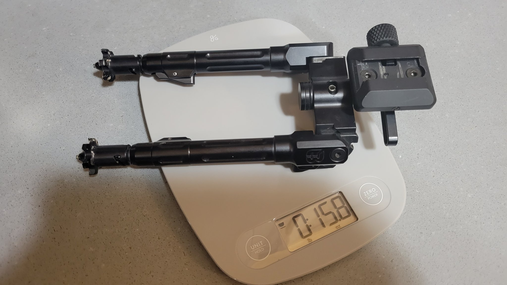

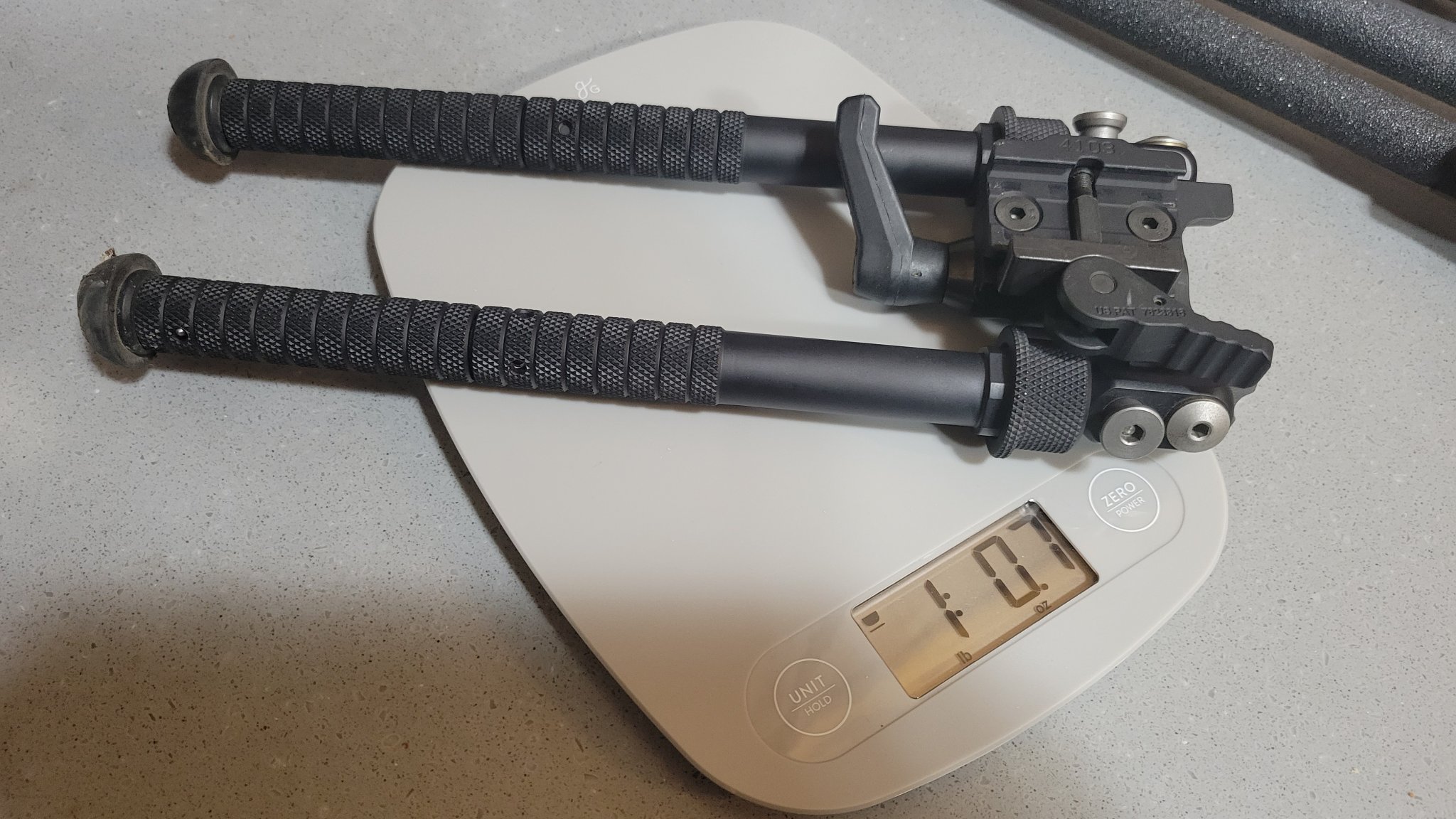

Can anyone with a single pull Gen 2 standard Ckyepod give me a weight on it? Website says “starting at 21oz” which I’m guessing is the PRS version’s weight. Thanks!
Here you go with some others for reference.
While I think the triple-pull Ckye is amazing for certain field matches (BOTC comes to mind) the lightweight double-pull is probably the most versatile. Gets you quite high (and as low as a single-pull) but only weighs 1lbs 5oz.
