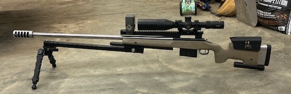

I never saw any negatives, definitely is more stable but it's not a gigantic difference or advantage. I just ended up going with a straight piece of square tubing cost me like $10.
thanks for the inspiration....
After a lot of analysis, i realized that the concept is sound but not applicable in all situations. I am going to follow your lead in that i purchased a 3' 1.5"x1.5" square aluminum tube that i will trim to size. On the front, i am going to mount a long Arca Rail and on the back, i will attach to the bottom of the fore-end of my stock as it has 6 connection points. In the end, this is expected to be very very secure with absolutely NO flex.
The reason for the Arca Rail is so i can easily and quickly adjust the location of my bipod along the bipod mount extension.
I will provide pictures once the mounting is complete.
Reactions: Taylorbok
Taylorbok... check this out. My mount is pretty robust and very solid. Just about $30 worth of material for a proof of concept. If i like it, the next step is refining it will be to make it easier to mount and reduce some weight.
Shot once with it on my new 300 PRC and really like it so far.
Going to 800yds this weekend and will know more about real benefits... or not.
