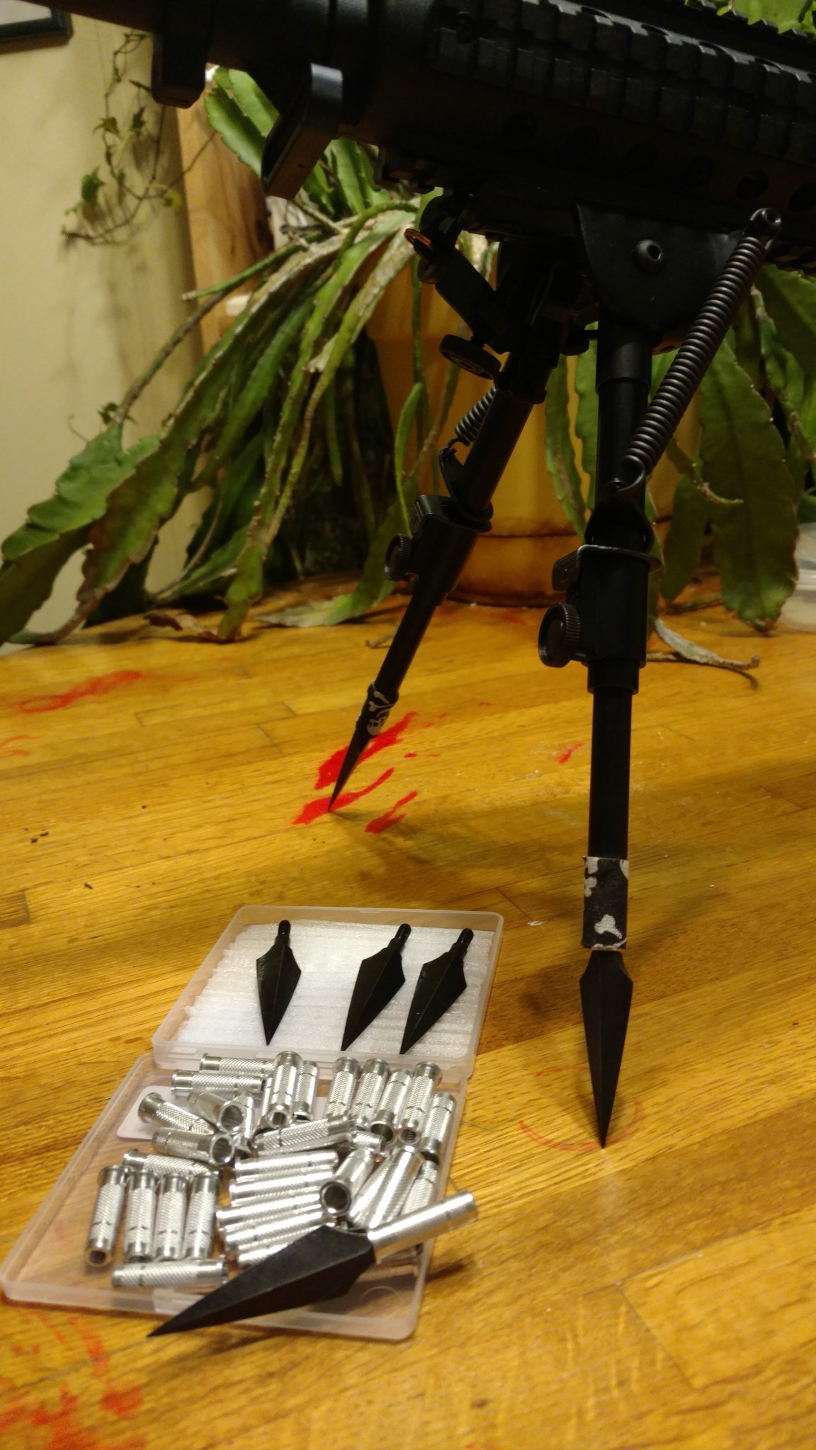

After some time searching the web for spikes, I figured I had to make my own after getting nowhere or ridiculously overpriced pieces of metal. Figured I'd share the info.
My Harris bipod had the same inside diameter as arrow head inserts. I just bought a pack for a few bucks and my favorite arrow head, took off the rubber feet, pounded out the pin, drilled a hole through the arrow insert, put the pin back in and screwed on the arrow head. Looks bad ass too

Me and a friend of mine were hunting a few years ago and we spotted some deer a ways out. He couldn't get his bipod high enough cause the grass was too high, so I crawled ahead of him and let him shoot off my back. I don't remember what he had on his bipod, but it left marks... These would have killed me or at least punctured a lung...
