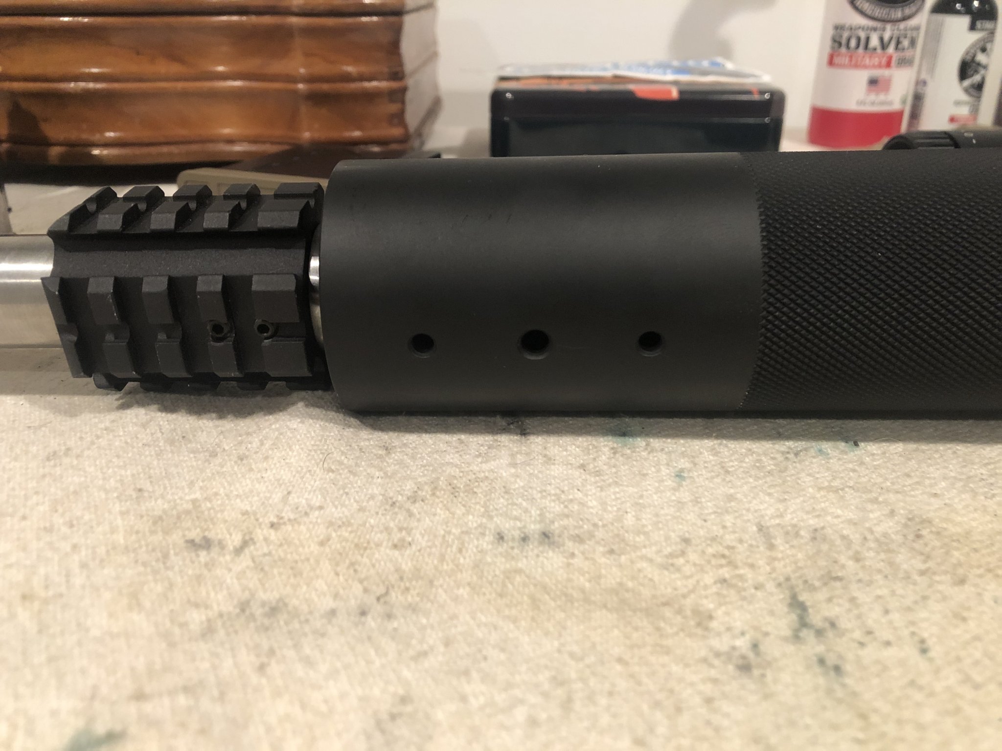

Pretty new to AR’s. Recently bought a DPMS 5.56 with a 20” heavy barrel, has a round free float hand guard. The hand guard has 3 tapped holes in the bottom. Are those just for mounting a pic rail? Or is there a bipod mount that bolts directly to the hand guard?
I see that Atlas has a “no clamp” version, that’s what made me wonder.
This holes are for a pic rail section
Reactions: Deets
I saw those, the shorty is a 4 slot which is 2” in length. My hole centers are 1-9/16” roughly. Seeing as they don’t give hole dimensions, and I’d guess that the centers are more than 3/16” off each edge. It doesn’t look like it will work.

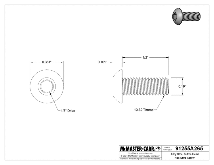

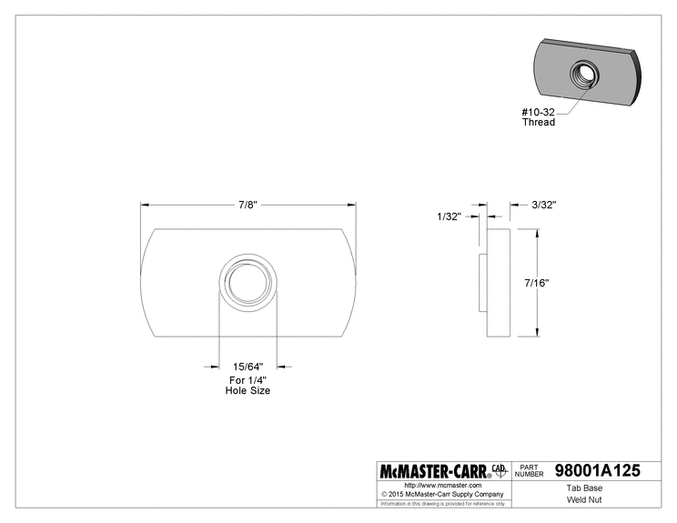

I don't know if those holes in the free float tube are threaded or not but this rail is a start. 10-32 weld nuts and some button head cap screws should round out the install. You can get these from McMaster Carr or a well stocked hardware store.
B&T33 tube rail kit might be just what you’re looking for.
Atlas has what I need, thanks fellas!
The holes in my tube are threaded, so BT 34 is what I need. I measured 1.59 but that’s eyeing the calipers.
