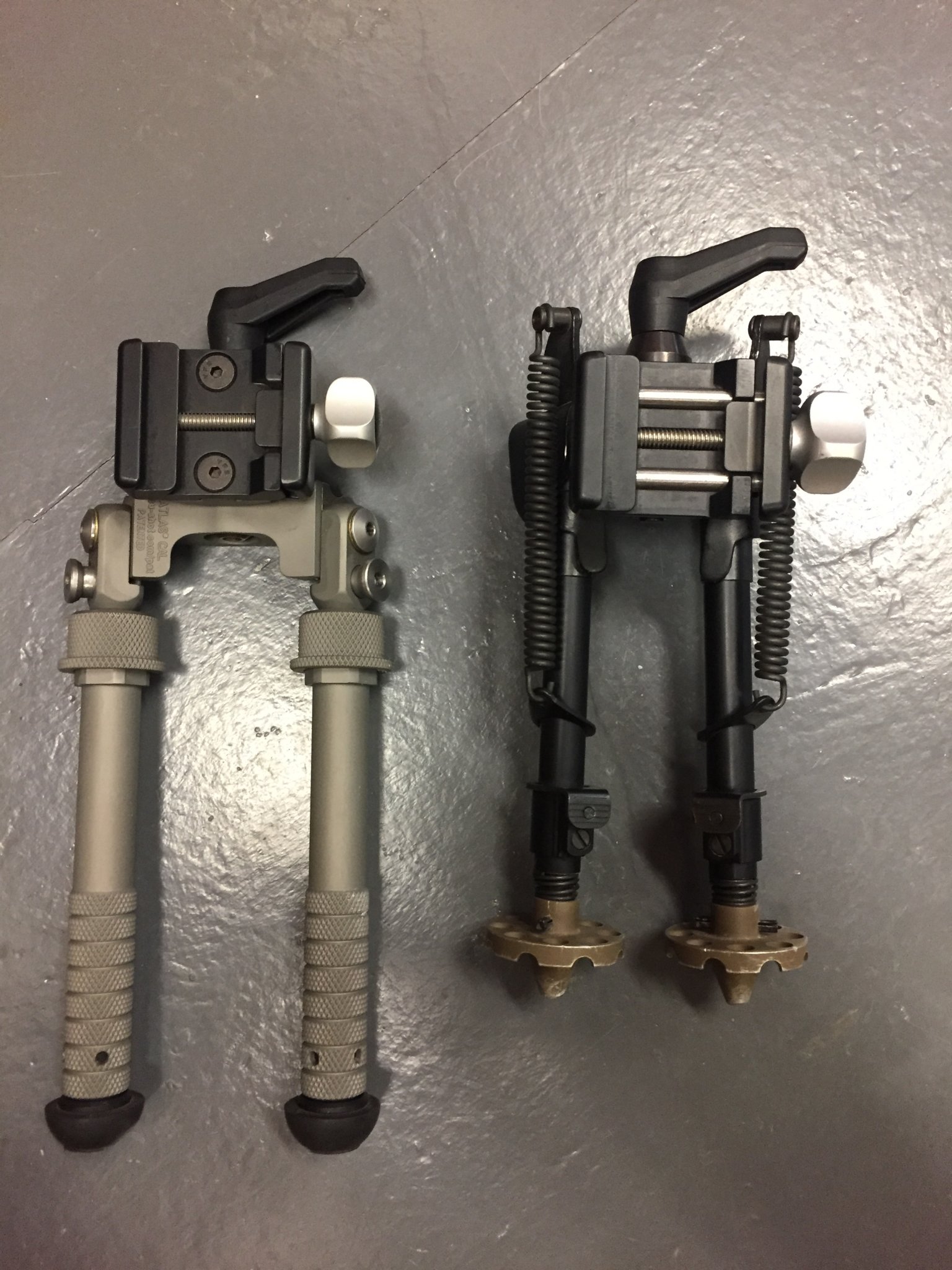

Harris is fastest for sure, just limited in the two positions. I started using a Warne recently. Pricey but very well made. Slower than a Harris, faster than an Atlas.

Harris is your fast one. All the rest I think use some sort of locking button like you mention on the Atlas.
I'm not a big fan of the Atlas, I'd recommend looking at LRA. Depending on what you shoot and how will dictate the one you want. They make big, heavy duty F class shit and bipods for BMG's. They also make their Ultralight Scout and that's the one you may be interested in if looking at Atlas and Harris.
Then there's Ckye pod. From what I've seen, it's pretty badass. However, it has even more precise adj. than the others do. How fast you can deploy it I don't know.
