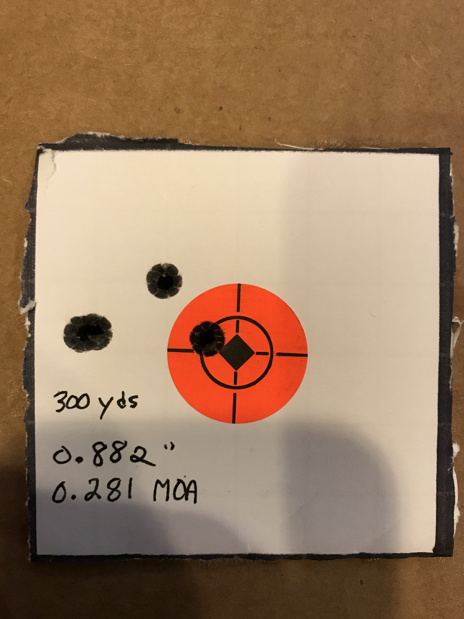

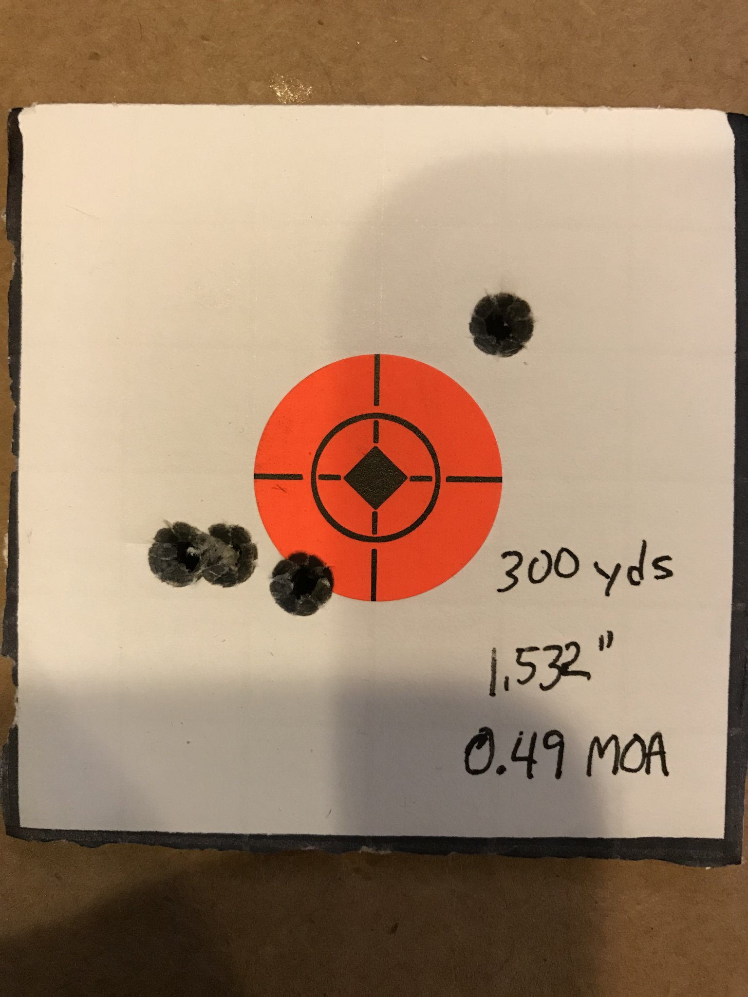

Much better results today. Left the range much happier. Like you said just takes practice.
