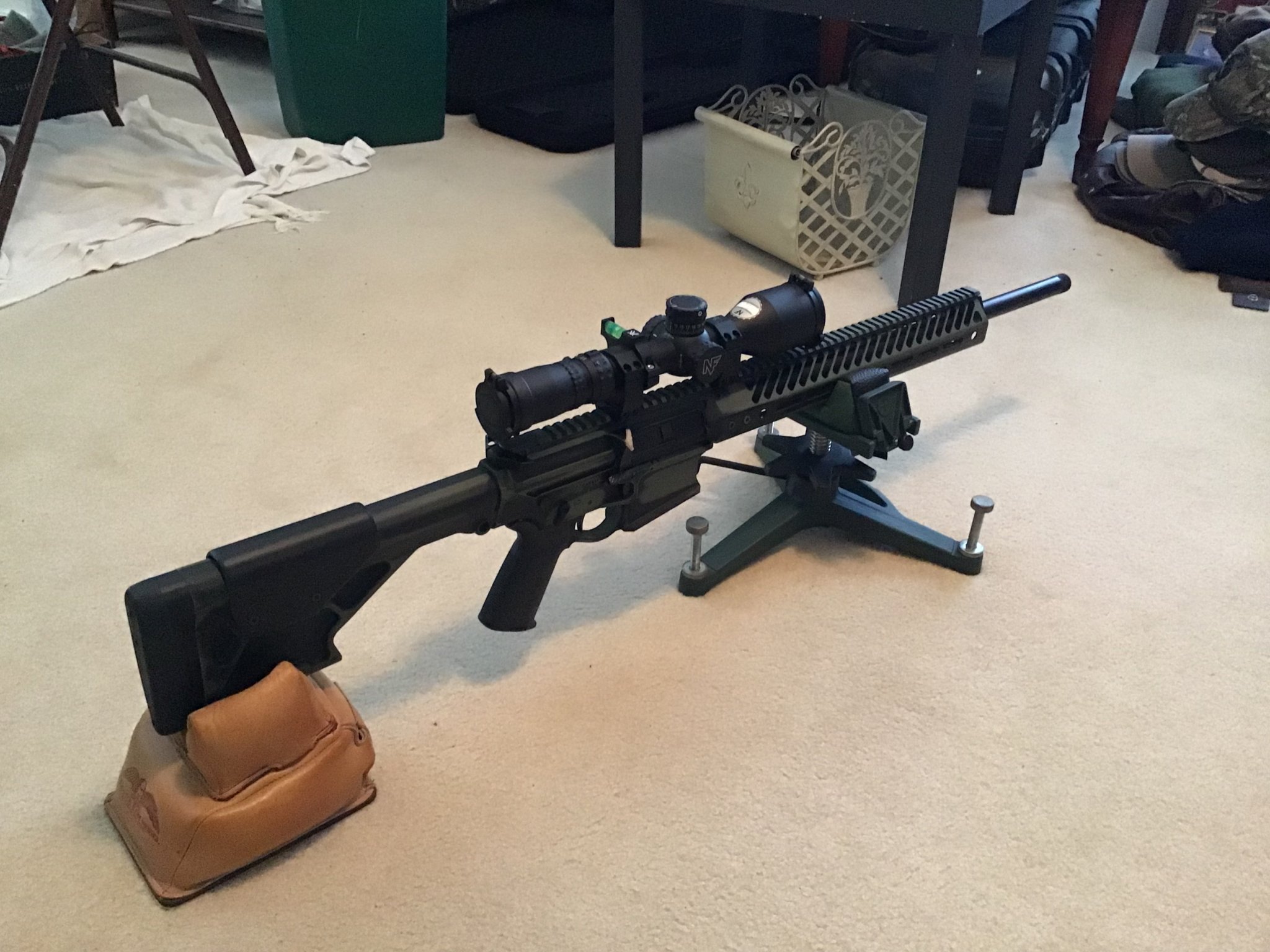

New to ARs here. I have 64 shots thru my new SP10 in 6.5 CM. I intend to primarily hunt with this rifle and have private land to shoot on. I can shoot out to 250 yds on a fire break into a hill, so it’s safe. I want to be able to shoot 3/4 MOA and it looks like I can do that. I typically shoot 3 shot groups and my group sizes range from 0.46 MOA to 1.2 MOA with majority in the 0.55-0.70 range mostly at 100 yds. My best group was a 3 shot at 200 yds (0.46 MOA). I’m shooting Hornady 140 ELDMs. I’m pleased with that. I have been shooting off a wooden bench using Caldwell from rest (3 legs, leather sand filled support, height adjustable, pic attached) and a rear leather bag with rabbit ears. I purchased a Harris bipod, rubber feet, 6-9”, no panning but swivel motion. I shot off the bench using the tripod for 8 shots at 100 yds. The shots were fairly tight vertically all within 1/2”. The lateral dispersion was horrible spanning 2.5” left to right. I have never shot off a bipod before. I experimented around with “loading the legs pressing forward” or not during the shooting string. I also was shooting kind of quickly between shots compared to the Caldwell rest groups. For someone new to bipod shooting , what is the main thought process? Always load the legs? Does inconsistent leg loading lead to lateral dispersion? Should I be laying on the ground shooting prone vs bench? My first experience with the bipod was negative. I already shot a deer using this rifle (Hornady 140 ELDM) Jan 1, shooting off a deer tower rail with sandbag under handguard, very confident position. That simulates the Caldwell front rest. I expected the bipod to be more likely to have vertical shot dispersion vs lateral. I summary, the Seekins SP10 is functioning flawlessly; no feeding failures, no ejection failures, all brass in the 300-500 o’clock direction about 8-10 feet away. Always locks back on empty mag. I have used a Magpul 10 round Pmag and 20 round Pmag with no issues. I have shot some SIG Elite Hunter 130 tipped and it seems every 3 shot group is 0.55-0.65 MOA. The ammo seems great, nickel case but I’ll probably settle on Hornady 140 ELDMs. I intend to shoot some Hornady 143 ELDX and hunt with that Fall 2024 but have not bought any yet. Still breaking in the rifle.
