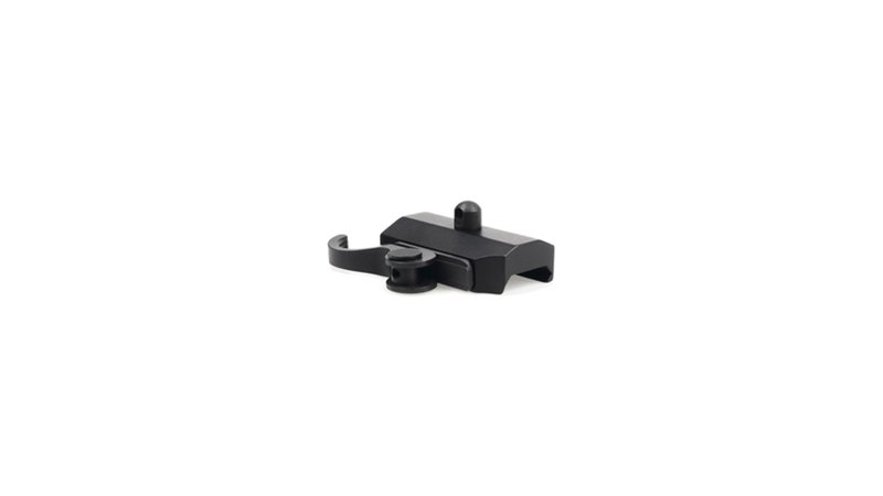

    earthquake, use this GG&G pic rail to stud QC bipod adaptor: http://www.opticsplanet.com/gg-g-quick-detach-harris-bipod-adapter.html
    It is very solid and the QC is adjustable for slight variations in pic rails. I have been using these for years through all kinds of match abuse and switching between many rifles, all calibers. It adds a mere 3/8" in height and is worth every penny. I mention these regularly here and am frankly surprised that more people don't use them. It's a solid accessory.
