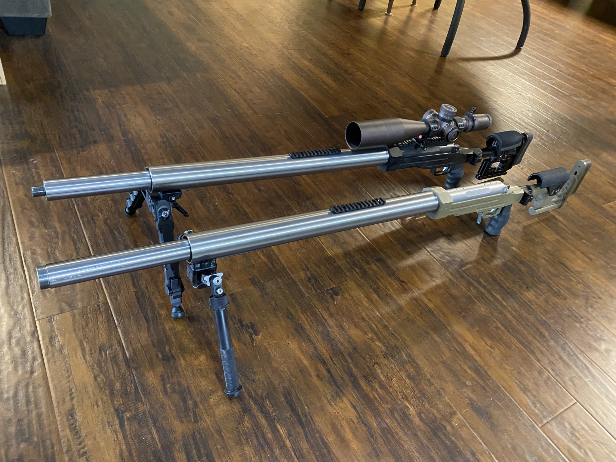

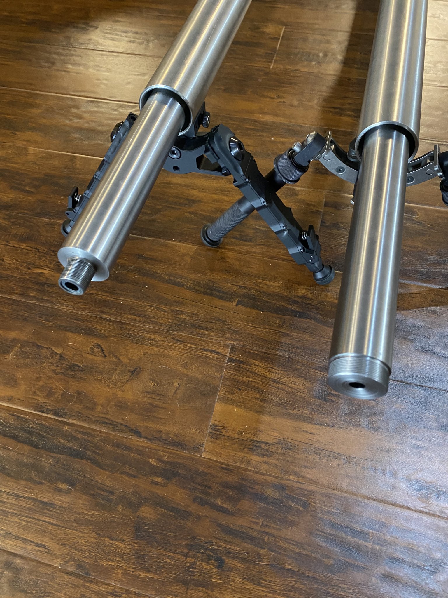

I don’t run mine all the way out when I’m shooting with a magnetospeed (which is almost always) because it’s occupying the end of the rail. Otherwise, further out the better.
Take a look at these guys for other options to get your bipod way out https://accuracysolutions.com/
And these guys for a magnetospeed mount https://www.mkmachining.com/product/mk-machining-gen-iii-magnetospeed-mount/

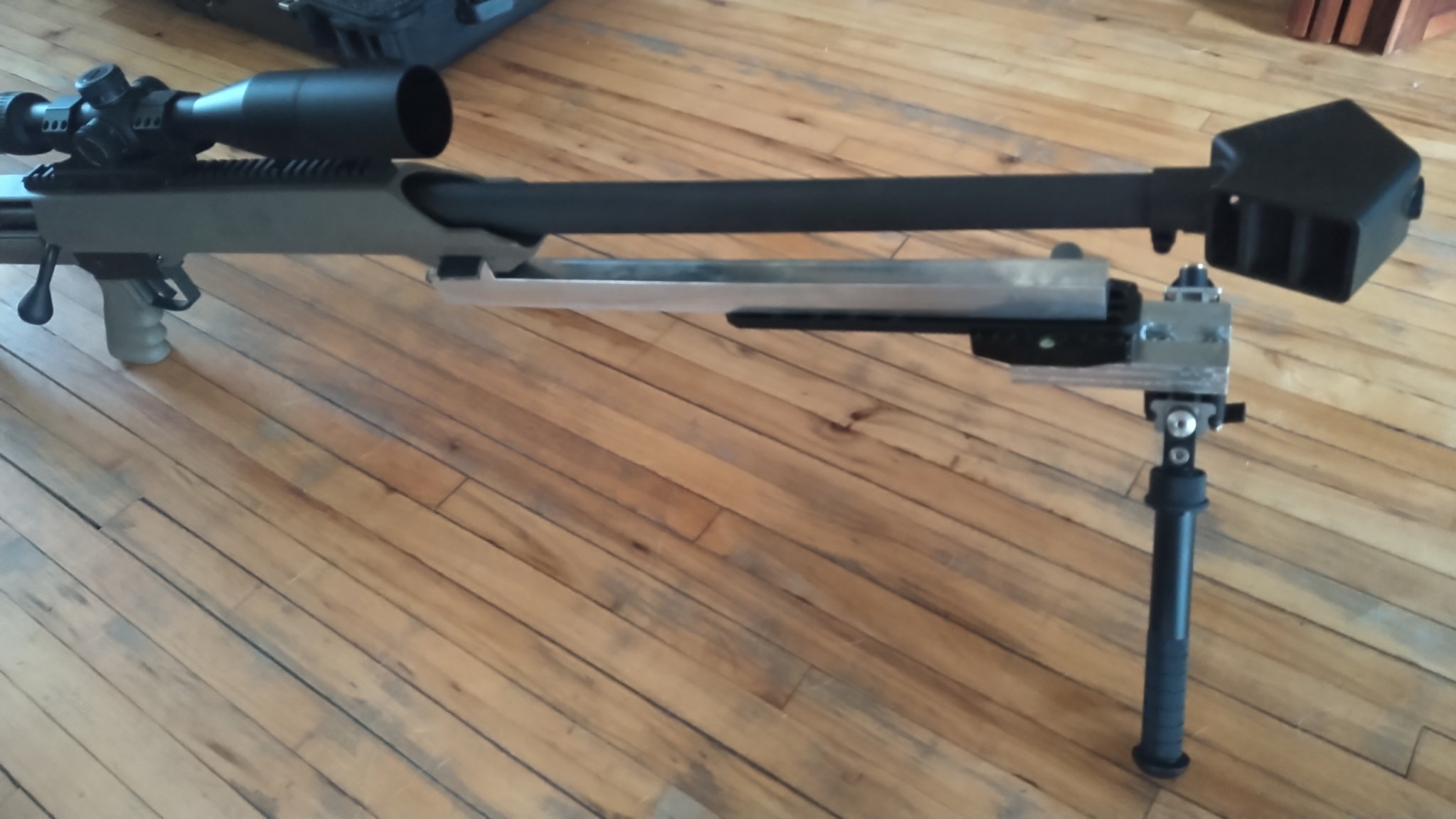

If you don't have full length pic rail and have the want or need to reposition it look at the KDG stuff:
One caveat though, the tiny screws that hold it together need a drop of blue or purple loctite. They will vibrate apart in short order otherwise.

I modified my chassis to get the bipod further out.
That 4+” was notable in stability with the 338.

I've got an Accuracy Solutions extension and I can definitively see the difference when using it. My only beef with it is that it's a pain to adjust the bipod - I rarely use it.
