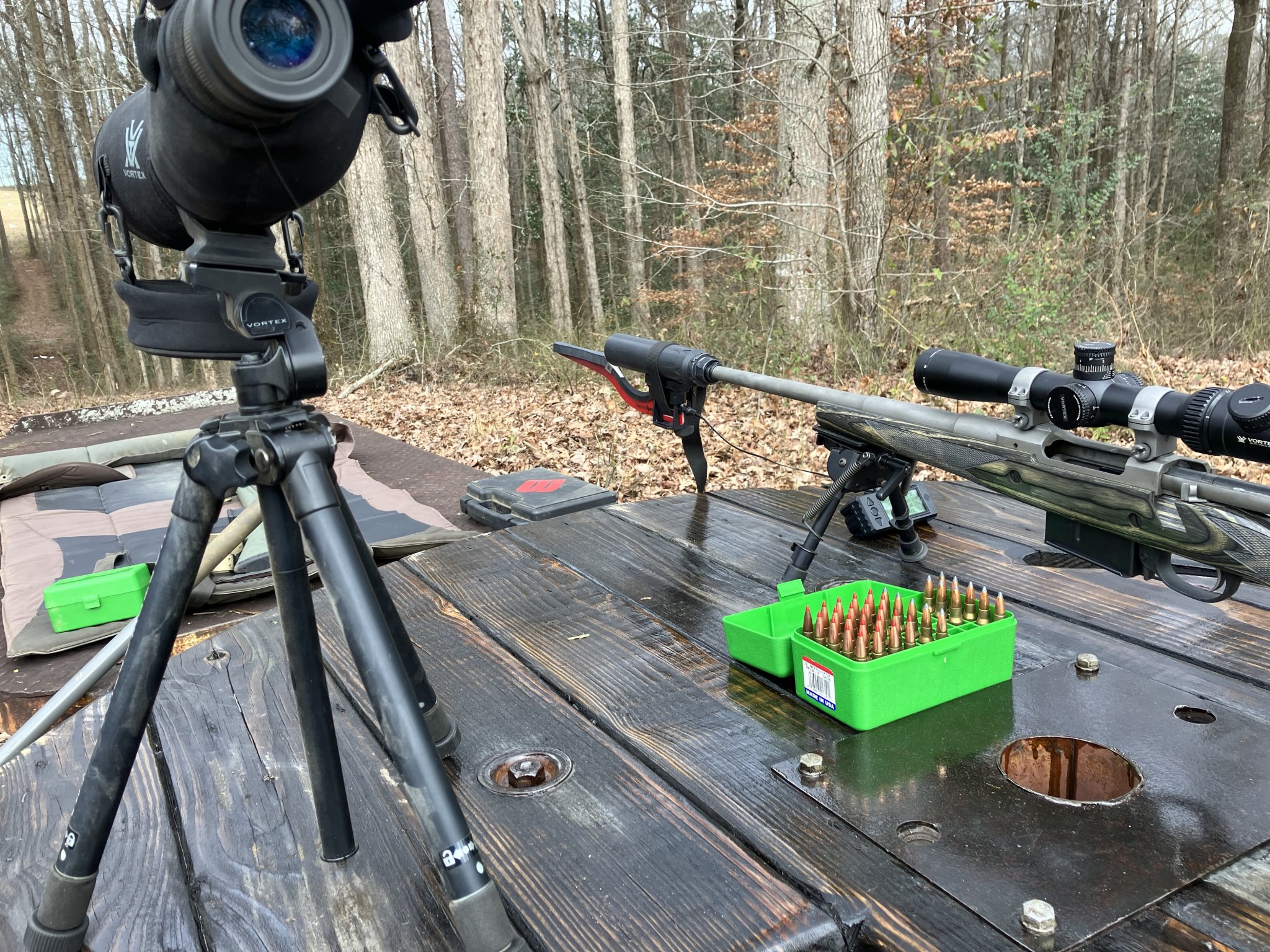

It has become apparent our Harris bipods aren’t cutting it. We are searching for a proper replacement & and quite frankly there’s so much info that it’s confusing.
We are going to buy (2) bipods, this is what we would like to maintain.
1. Adaptable to sling studs. We will be transitioning to a rail of sorts for a couple of rifles,( it looks like ARCA is the standard?), but need stud capabilities as we shoot multiple rifles & changing all of them over is not feasible.
2. Great adjustability for Bench & Prone shooting.
3. Less than $400 all-in/ per Bipod. Everything needed to use the bipod.
What’s the pick for all this?
Pic for Attention
Thank You.
