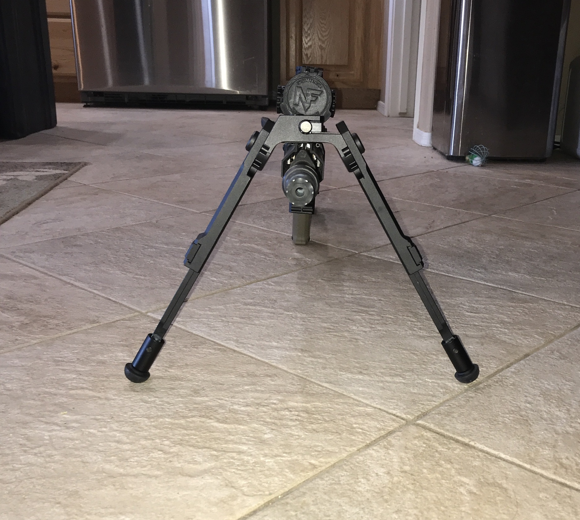

I can’t believe how a lot of these “high end” bipod manufacturers still haven’t yet figured out a way to keep their legs square to the rifle or that a lot of people strongly want a panning lockout option.
Magpul is hard to beat for a budget bipod with panning lockout and will do everything you need it to and more for a fraction of the price of an atlas.
Shoulda gotta bipod with a panning lockout.
That's not what leg rotation is.

Being square and consistent is the biggest difference.
Not to mention an obvious upgrade in quality of materials. I’ve broken damn near every Harris I’ve owned at some point.

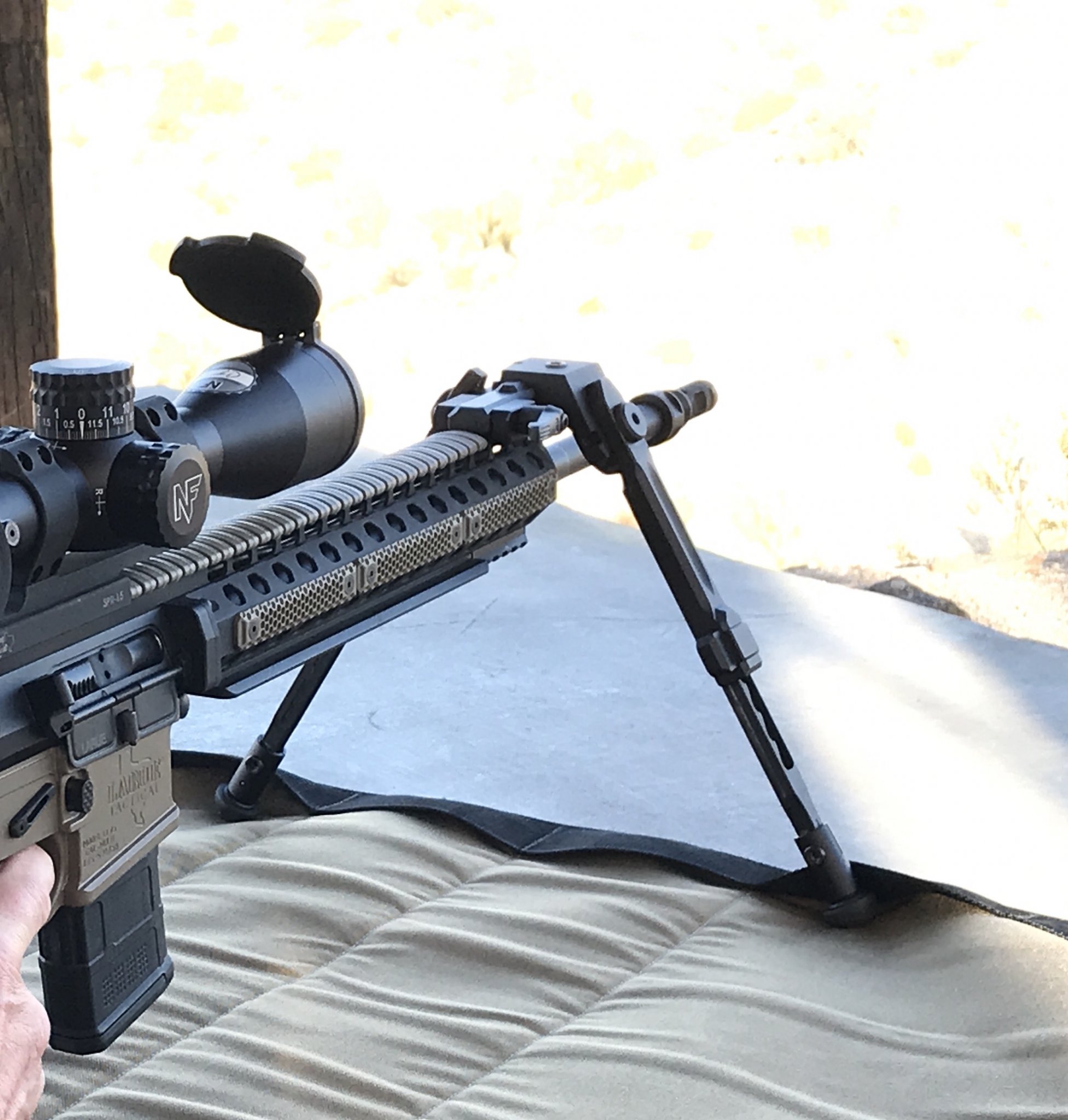

Ok a bipod doesn't hop, it skips. If you put a bipod on a smooth solid surface it moves under recoil. Before you refuse to believe this get your Harris bipod put it on a smooth bench and film it with a high speed camera, the feet move. You don't want your bipod feet moving, the bipod should flex/pivot at the top to absorb the recoil and keep you on line with the target. The Harris is one of the worst at this because there is very little flex at the top mounting point. Can this be managed by the shooter, yes but it requires that the bipod be loaded which is virtually impossible on a hard smooth surface.

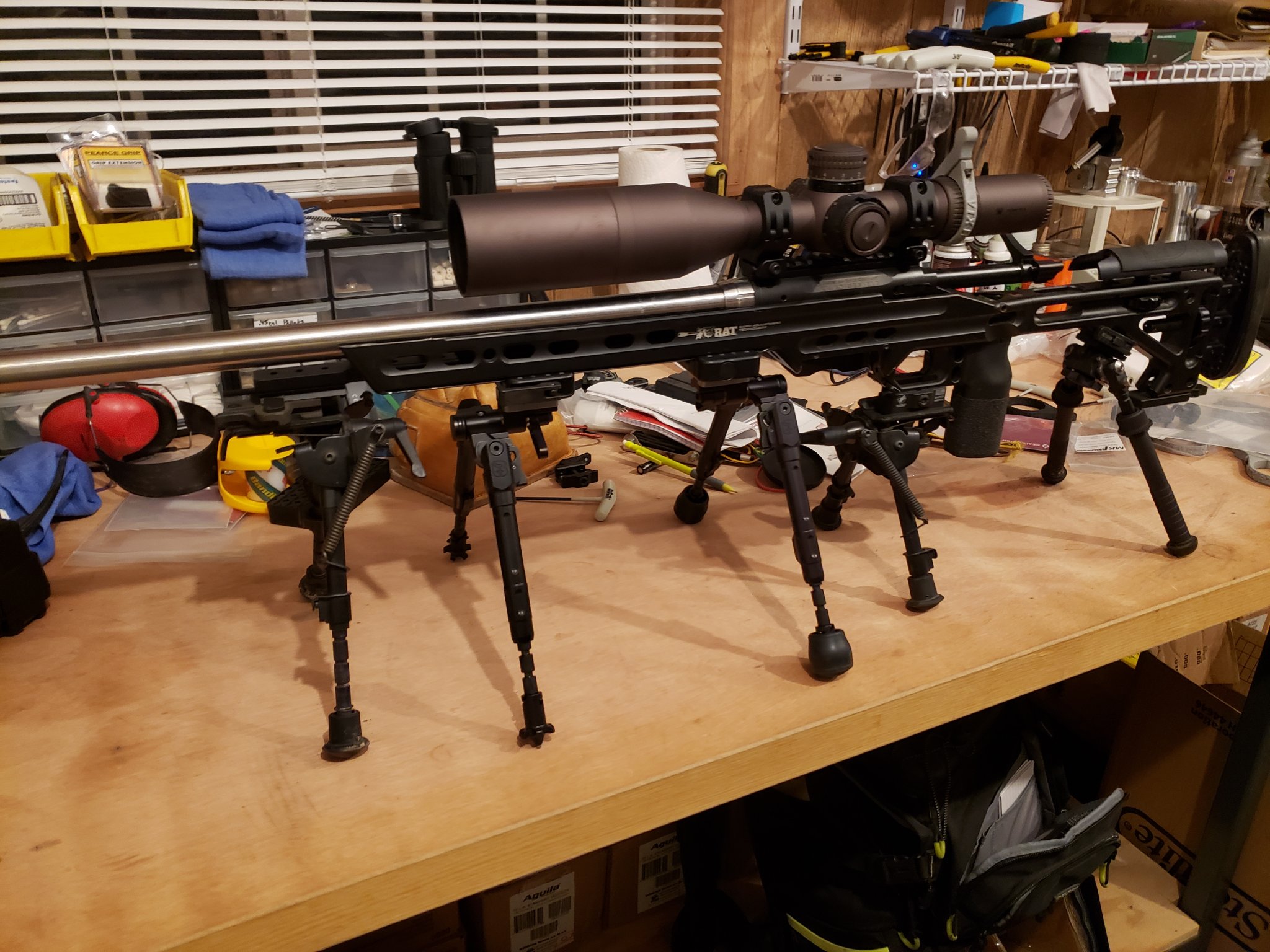

I have used Harris, Atlas, LRA and Accu-Tac. For shooting prone or off a bench the Accu-Tac is the best of the 4. I use the new WIDE BODY series the WB-4 is the shortest with the WB-5 3/4 of and inch or so taller. They are built tough and for my 375CT i use the HD-50.
So says you
These guys say (and demonstrate) otherwise
I have found that pulling the rifle back in the shoulder using only bicep tension is far more important than how much loading one puts on a bipod.
Reactions: 1500varmint
So says you
Yep first video showed it perfectly bipod feet are sliding slightly to the left with each shot. For the record I don't load my bipod but I use an Atlas which does pivot at the top.

Does thr hate for harris relate only to the base models mounted on sling studs, or does it include heavily modified/properly set up harris versions, eg with pod-loc, and something like an MLOK UL pic mount or RRS pic+ARCA rail mount?
It’s the overall design with narrow angle legs and a below barrel intersection.
Harris bipods don’t always suck.
In hunting and situations where speed a concern they offer a good compromise and the magpul is better yet.
For maximum stability the Harris is certainly not a top contender.
You still have some fairly cheap stamped parts. Also, once you kit out a Harris, you might as well buy an atlas.
The “hate” is mainly directed to the “it’s just as good” crowd. It works for what we do, but not just as good when it comes to quality and such.
I’m betting 80% of the people if not more on here have started out with a Harris style bipod.... They can work to ring steel just fine.
