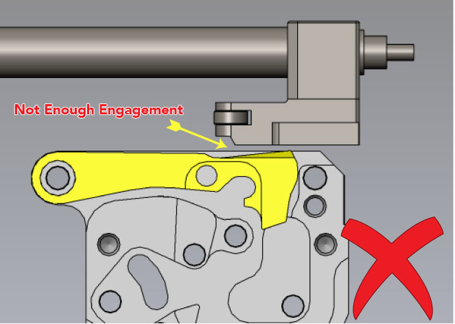

earlier I adjusted the sear screw quite a ways out and it would still drop from time to time. I have not put the medium sear back in because when measuring I’m sitting at 0.154 inch from cocking piece to top of trigger pin.
I pulled the trigger out of the action, disassembled it, and backed the sear adjustment screw all the way out to max engagement. I did notice the rear trigger pin is very tight in the trigger hole. Could it be causing some binding when putting the trigger pins in?

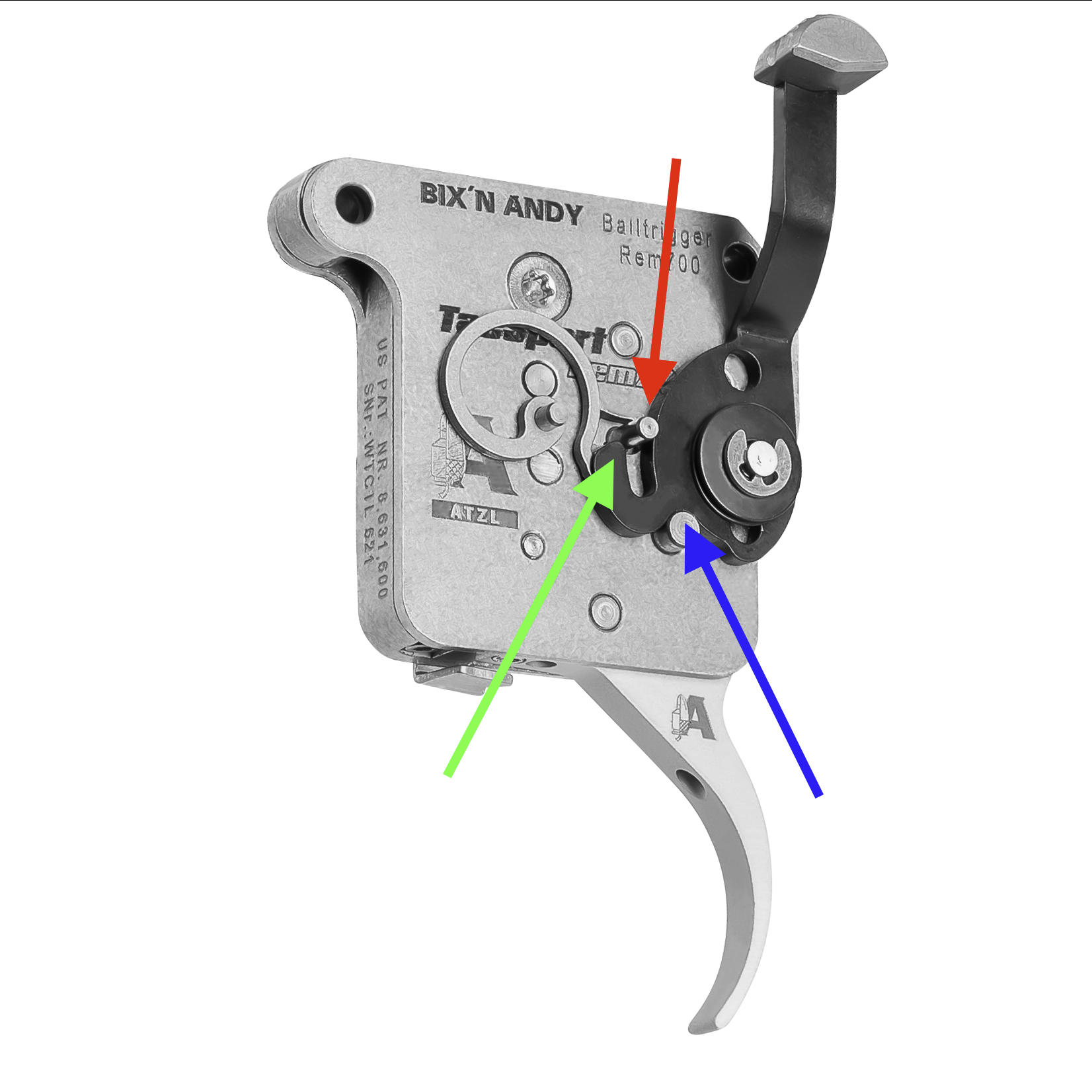

Here's a pic of what to check. With the trigger installed in the action you want to verify that the safety lever can fully reach the fire position with the safety lever in full contact with the stop pin (blue arrow) to ensure the sear safety pin (red arrow) will clear the catch on the safety lever (green arrow.)

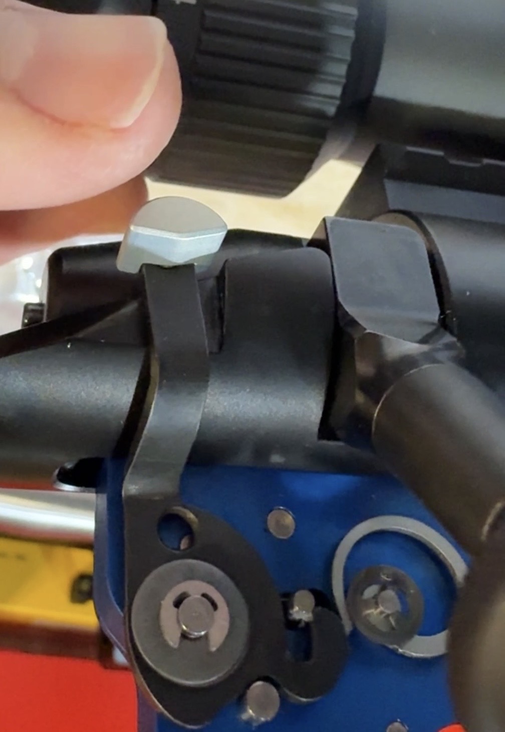

I assume the following picture shows the same problem Kiba described.
If the safety is softly moved to the fire position, it might not go fully forward. See the lever back approx 1/8” and the cammed hook on the lever isn’t fully disengaged from the sear safety pin. (Think of a hunting situation when one is trying to be as quiet as possible while preparing for a shot and you’ll have an idea of how this can present itself).
Interference with the action is the culprit. Attacking the safety lever is obviously preferred over modifying the action body. I have taken a bastard file to the lever and seen improvement, but I like the idea of polishing with a dremel better, so that is my next move.
