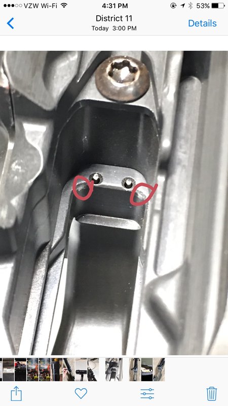

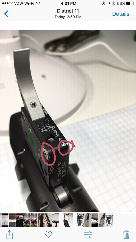

To pause here, I took a look inside my chassis and trigger housing. I can clearly see rub marks on the bottom of the trigger assembly on both sides near where the magazine spring ends poke out of (photo provided in response below). I'm already at the point where i dont have any more fucks left to give on whose fault this is, im just left with the bags. I suppose I'll just have to dremel out some fucking material there myself.

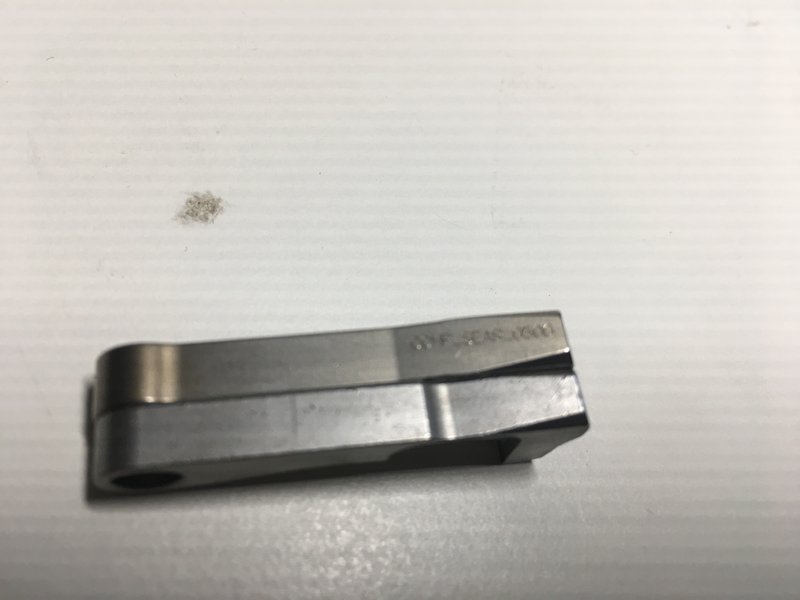

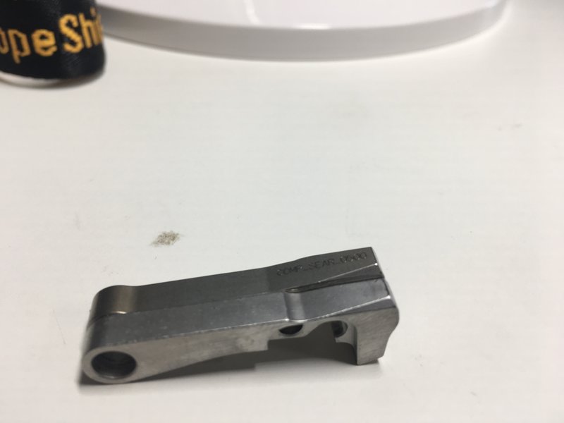

Just wanted to update this thread.
got the modified sear. As you can see from photos (maybe) the modified sear sits up higher near the rear where the cocking piece would interact with,offering more real estate.
Trigger is back to working like a charm and no issues.
Big thanks to chris and the bullet central crew
long, very long story short... if you want a bix n andy talk to bullet central. Make sure you know which custom action you're getting AND from who.
