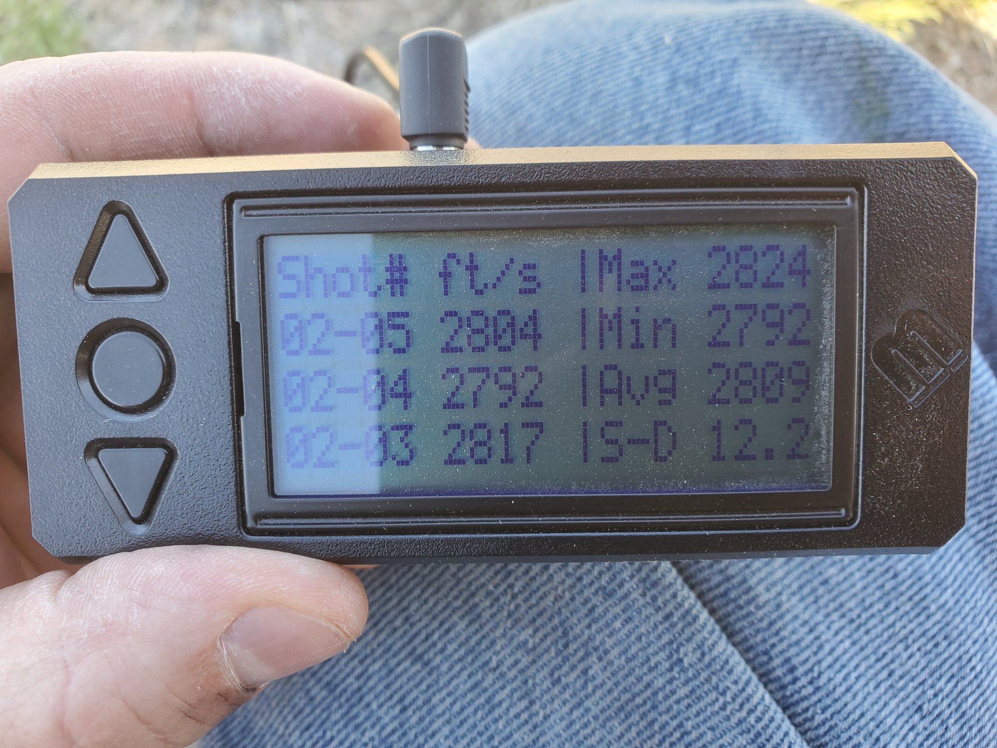

One of my favorite loads, and bullets. They’re running ~2773 out of my 18” Larue stealth. POI has always been identical to the SMK too. Absolutely potent on deer with a boiler room shot. Not always a big exit, but it vaporizes the heart and lungs. I’ve never had one go more than 25yards in 10+ deer.

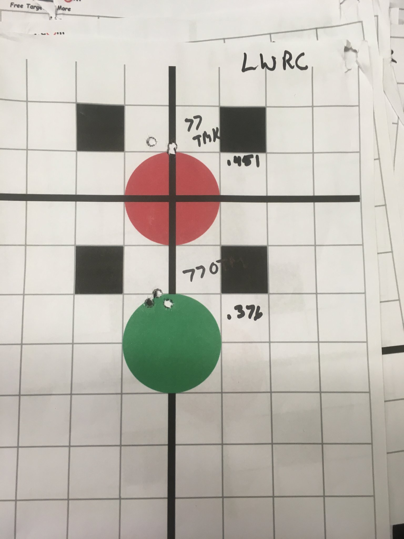

While I prefer 10rd groups. and We all realize it is a better for showing the potential precision/ grouping trend of a ammo , from a specific firearm.
But....The 3 round groups pic'd above , are good enough to get it done, Lol...
The best way to find out the barrels / ammo combo's precision ( and you ) is 10rd groups... test , and practice... Repeat...
