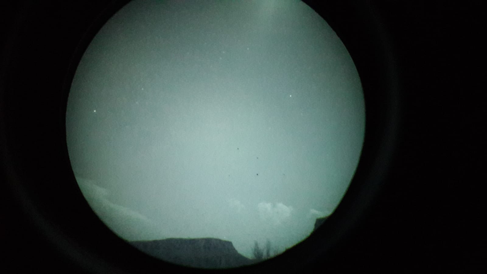

Greetings,
I am new to this forum. Hope someone can give me some advise. It is actually for a good friend of mine.
He bought a new PVS-14 gen3 white phosphor from a vendor on ebay. The unit has about 7 noticeable black dots/specks just off the center (see pic). They are not huge but they do distract the eye when searching for wildlife, creating false "movement".
The seller (company) says that this is normal, and that this tube is actually considered very clean. I have never heard of brand new quality optics arriving with specs. The unit was about 3G. Not cheap. The seller has offered to replace the tube, but said that the replacement may be same or even worse as this is how they come.
Would appreciate any advise.

The dots are mentioned somewhere in the specs as I recall, but it's been a while since I looked. Black specs are a "thing" though, even with new ones. If they're in the center or too big or too many they don't pass but I don't know how bad "bad" is. This is for milspec, it may be in the Omni 7 or Omni 8 info. I think that's on Wikipedia? They could be right, but there are reputable dealers on here that have looked through more than I have that will probably weigh in eventually. And a few users with a shit ton of different NODs too. Omni 8 did loosen specs (this was years ago) so not as many tubes got rejected but I don't know if it included the black specs or just FOM numbers or what.
I wanna say the stuff we had in the army was cleaner, but it's been a while. They'd have been new ITT Omni 7 thin film models, so built in a clean room, but other than that nothing special. I know the one I have is super clean, thin film, I got a hand select ITT Omni7 unit from TNVC a few years ago and it's the best green 14 I've ever seen by quite a bit. That one's flawless. A used military buyback PVS 30 I got has a relatively low FOM rating and Harris tube but the image is clear and it may have few pin pricks way to the peripheral but it's not really noticeable.
Maybe I've just been lucky with the dots. I don't know what causes 'em on new units but on older ones it's from light burning in the image for one reason or another.
I'd look up those specs and see if you can't find the info on those dots. It's there somewhere and specifically mentions what you're talking about.

Black spots are common from my understanding, it’s a matter of finding the cleanest tube possible and where they are in the image. However, I wouldn’t consider this tube “very clean”.
If you get the tube replaced ask for pics through the new tube so you can see if there are spots. Also realize the cleanest tubes are going to cost more.
I don't have any experience with the white phosphor tubes but blems are normal with intensifiers and graded/rated by the number and size. Not sure what your friend paid for, but my experience is that you get used to them after a while and they're not really a distraction.
Is it normal? Yes
Is it 'very clean'? No; but only because they are clustered together. If they were spread out, I wouldn't even care.

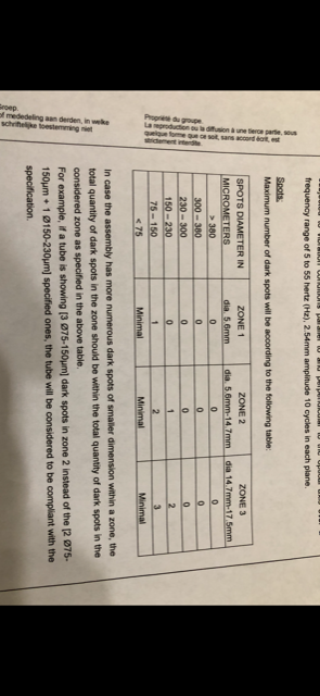

There is a chart somewhere for acceptable sizes of spotting dependent on where in the tube there are. While I obviously am not looking through your tube, your picture doesn't show any that would exceed the size limit. I can see how it would be obnoxious as fuck though; I'd get another tube and tell the vendor that unless he wants to play an endless round of hot potato, he should inspect the replacement tube and send a less shitty one.
You/your friend need to also realize that a flawless tube is not very common at all.

I'm not sure if we can compare US tube specs to non-US. The spec sheets I have seen are in imperial units and english only. The one you have up is metric and in other languages...
If this is true and it's non-US tube or a US tube sold to a foreign country, then the specs on that could be anything and what I mentioned doesn't apply. That's only US milspec, Omni7 or 8. IMO I feel the image looks dirty, in particular to what I've used, but that chart is what you have to go by.

PS: Here's a set for sale on here, $4000 and comes with a full power PEQ15 too! Take a good look at the image. That's what most WP tubes tend to look like. https://www.snipershide.com/shooting/threads/wts-l3-wp-pvs14-peq-cheap.6913042/ If you can get a refund and get this, just do that and be done with it. That's $2500 for the 14 if you wanna consider $1500 on the PEQ (but they can go for more sometimes too). Hell, I sorta wish I could snag this deal.
