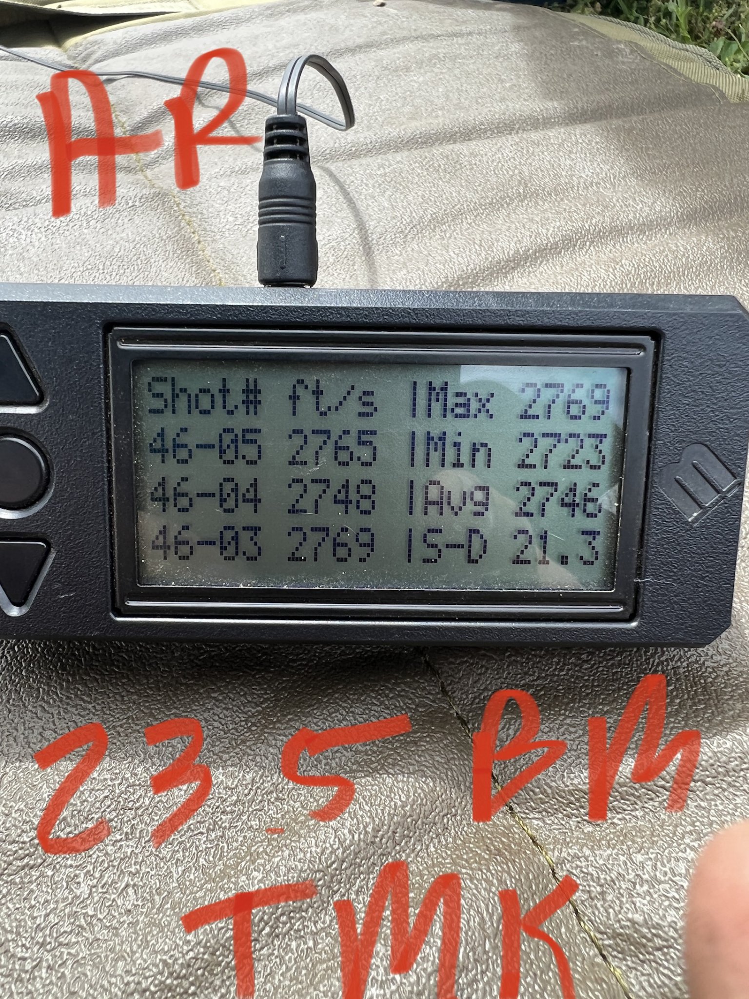

Finally got a very close clone to the Blackhills TMK load.
Daniel Defense upper and lower
Proof 223 Wylde 20” barrel
Lake city brass
Remington 7.5 primer
23.5 Benchmark **overmax in all books**
No crimp

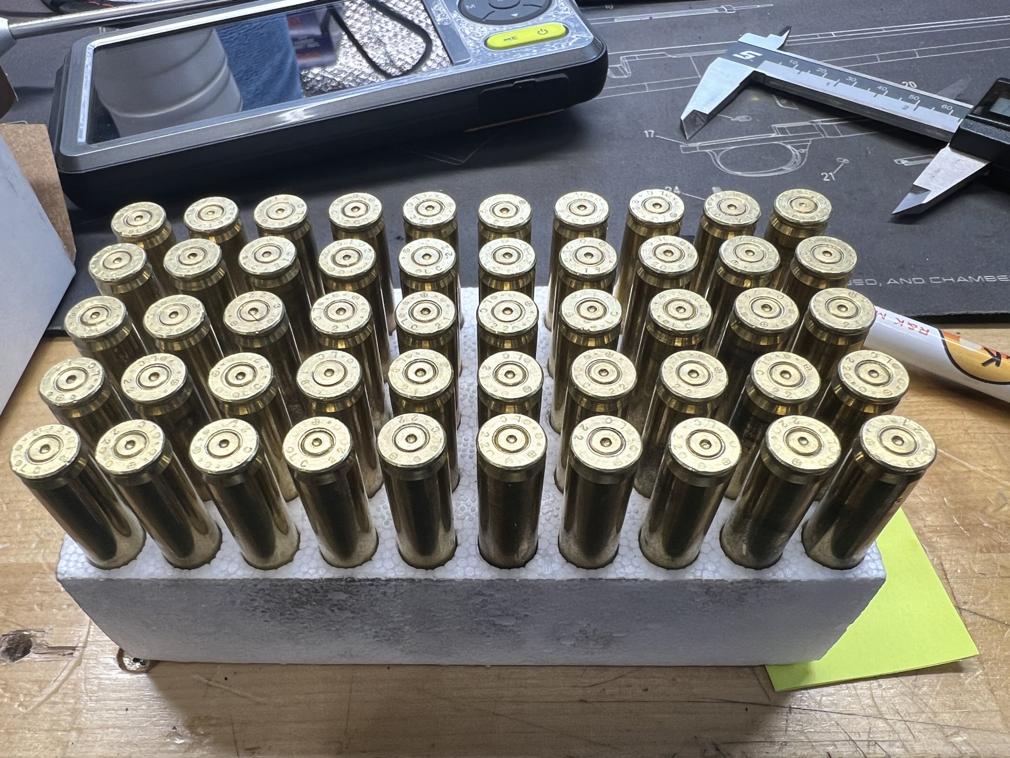

Looks like you get the seater ring too lol... what case fill percentage you guessing?
Pretty much every seater i have does this on this bullet....

Yep it’s a new set of nat match dies and I need to hone stem. 85-90 percent fill.
Tmk jackets are super soft.

Here is the same load in a 14.5” 1-7 twist.

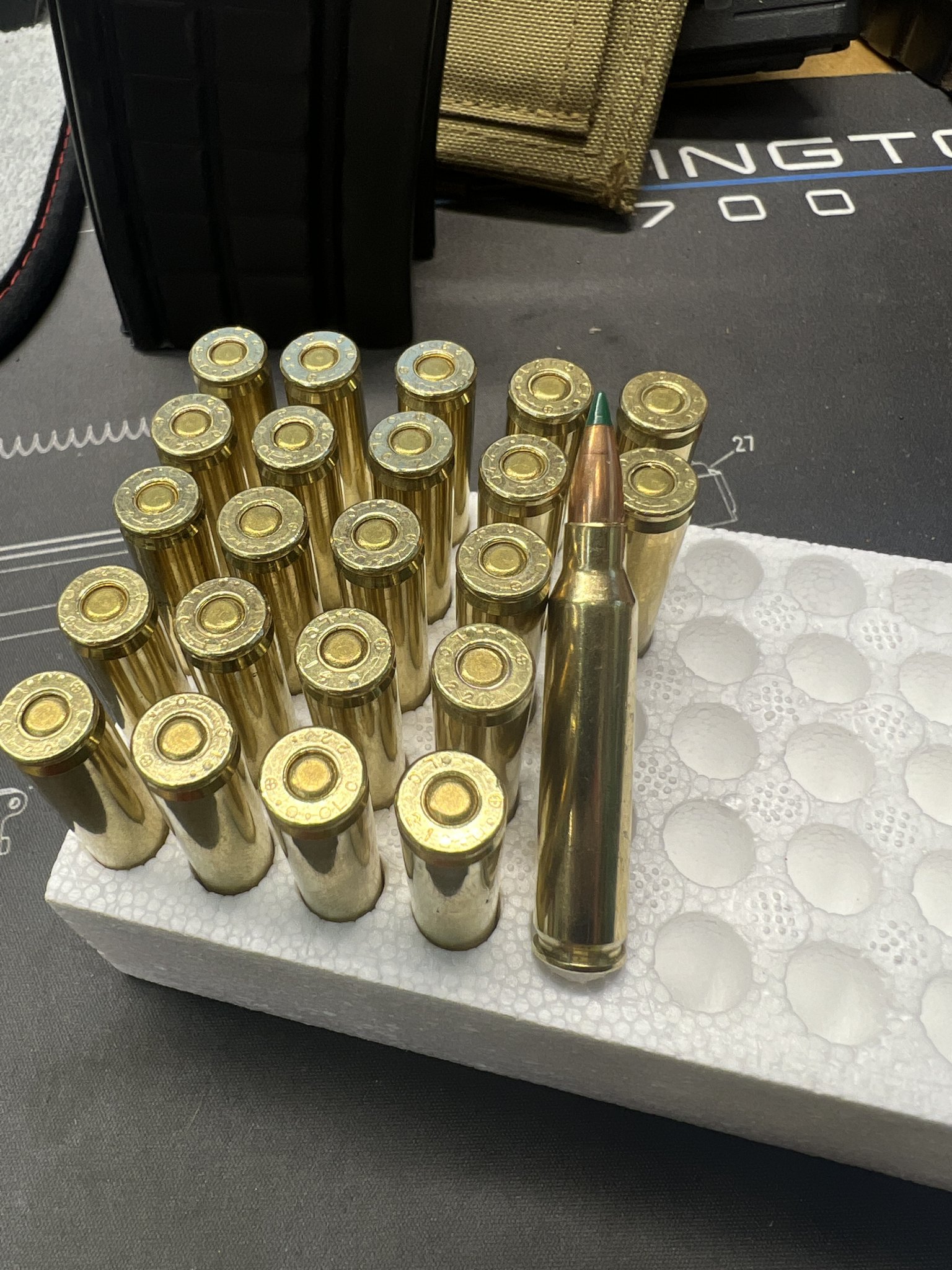

I haven’t measured it, it is more than my lapua 223 brass.
Unless you have the most voluminous Lake City cases in history, I doubt that you're getting only an 85-90% fill with 23.5 grains of BenchMark. The 77 grain Tipped MatchKing is longer than the standard 77 grain MatchKing and it eats up more of the case volume.
Quick Load puts the fill at over 100% with 23.5 grains of BenchMark and you can hear the kernels being crunched together when the 77 grain TMK is being seated with that powder charge.
I can shake the cases and hear powder shaking. So not sure but I will do a water capacity test on one when I get home.

30.6 grains of h2o water capacity

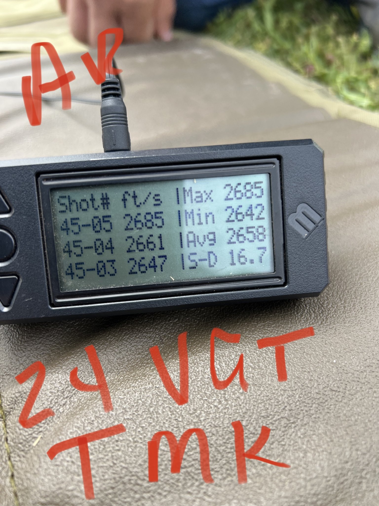

I have been using Ramshot Tac but been hard to find lately. Anyone got similar load with H4895 or Varget?

If I run tac, it’s 24.4gr in a Norma piece of brass with a Winchester 41 primer. Just finished loading 50 of them up with a 77gr Nosler with the cannelure. Have ran up to 24.8, but the primer pockets in Norma last 1 firing. I’ll get 4-5 at 24.4.
I switched from TAC to AA2520 for my mk262 mod 1 clone load in 2019. Above 24.5g, TAC was overpressure, and at 25g primers were falling out (only saw this in limited testing as i never loaded 25g in a TAC-based prod lot).
With 25g 2520, I get 2810 fps on average, .75-1moa at 100m with zero pressure signs in my mk12 mod 1.
Not sure why so many folks want to use TAC when 2520 is better and just as available.

Would be interested to hear how things go with Lever. TAC will likely max out at 24.0-24.6 before you hit pressure, assuming Starline has similar capacity to LC and many other 5.56 manufacturers.
Reactions: hellzna
I have shot 88s with Leverevolution to 3000 fps with a 26" long throat bolt gun. Its extremely temp sensitive though. 2900 fps @35F, 3,000@85F. Brass looks good though. Obiviously work up at your own risk.
Reactions: hellzna
Lever and CFE223 are almost the same. A good friend swears by CFE223 in his 77 grain loads and uses them interchangeably.
I've seen some really good accuracy with faster burning powders behind 77s but you have to give up some velocity. TAC does well but you will need to consider ambient temps a little more. I have no experience with Accurate 2520 but may try it someday if I start to run low on 8208XBR. 8208 can be spikey so I stay away from high pressure loads.
