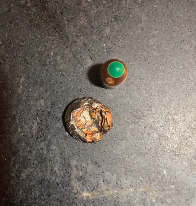

This is a 245 aerotip that was against the offside hide on a mule deer buck that the old lady shot at about 110y last week. Still weighed 225 and Id say it expanded pretty well. A little less and it may have made an exit would, not that it needed it.
