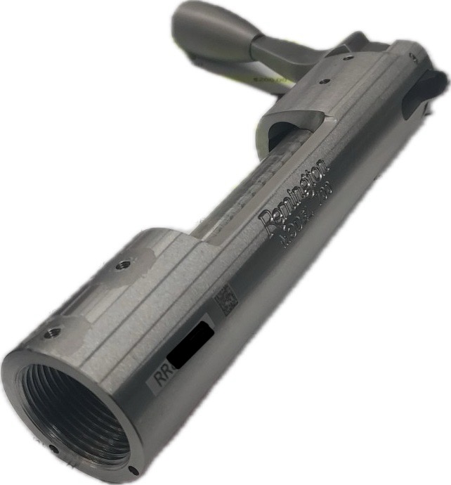

    I made this mistake. Bought a trued stainless action from Northland shooters supply and I have had nothing but issues with it. Pre-extraction being the main one. It does however shoot well. I knew nothing about these issues at the time and thought if NSS was selling a trued version it would be gtg. Now I find out “trueing” exacerbates the pre-extraction issue. Live and learn.
    So then I found myself in a “fallacy of sunk cost” combined with knowing I could never sell it in good conscience the way it was.
    It is now at the LRI “gun spa” to have the timing fixed. While I was at it, I decided to pin the lug and have the side bolt release installed so I can run a TT Diamond. So far the awesome experience with LRI has made these upgrade fun at least. They really are professional, and have their act together. I even get photos as the work is done….
    No more 700 actions for me though. This one will likely be relegated to a .223 trainer/coyote rifle in the future while my LR Rig gets a custom action at the next barrel change.

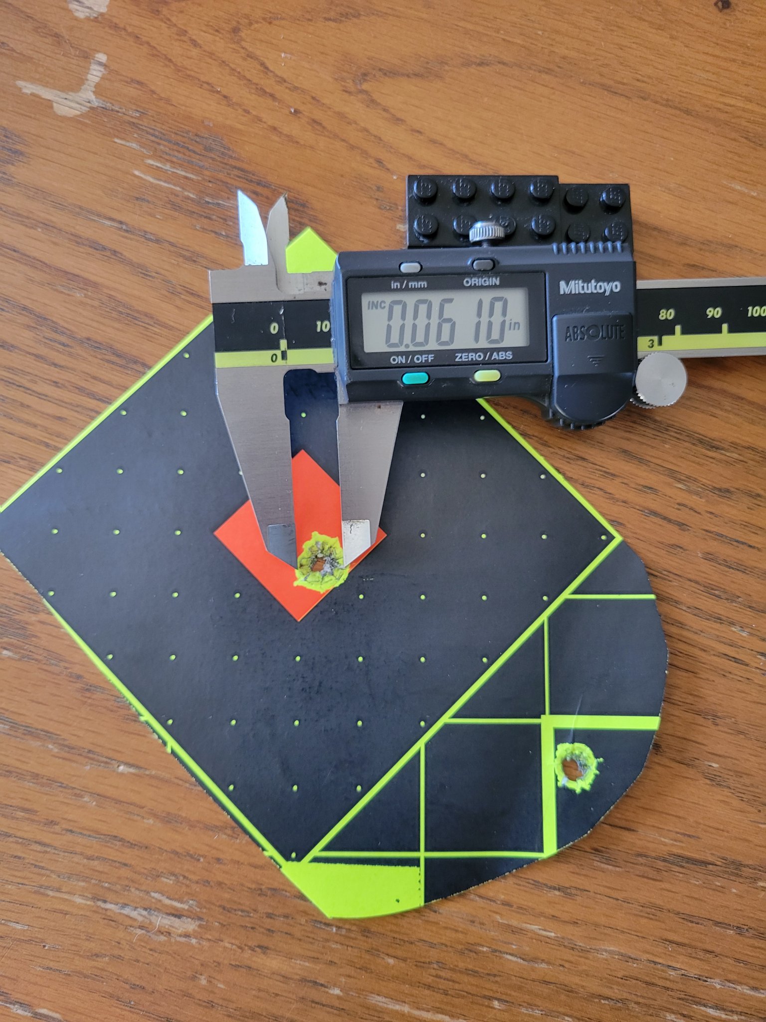

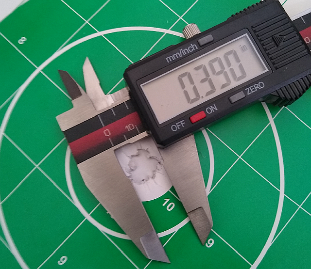

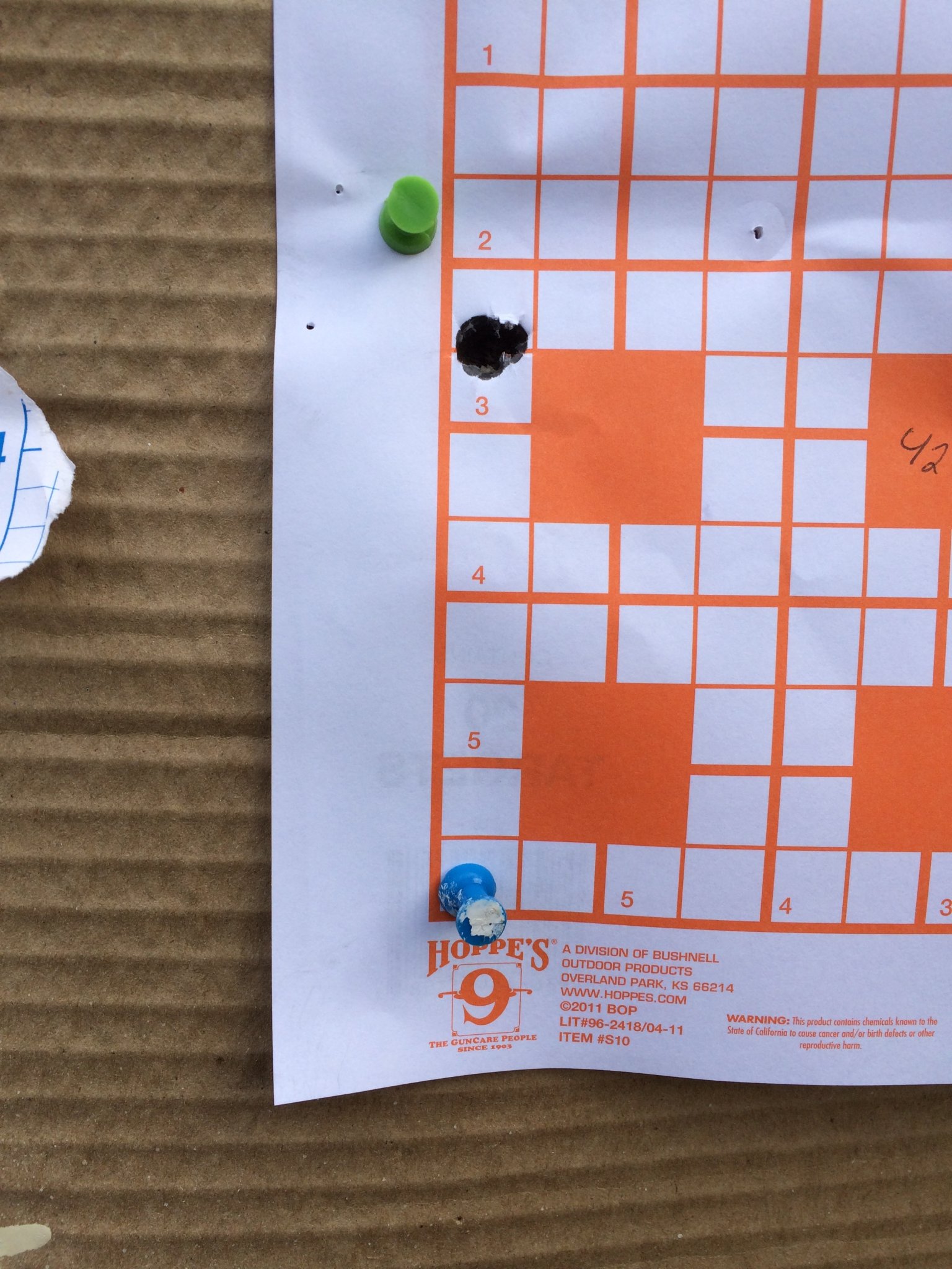

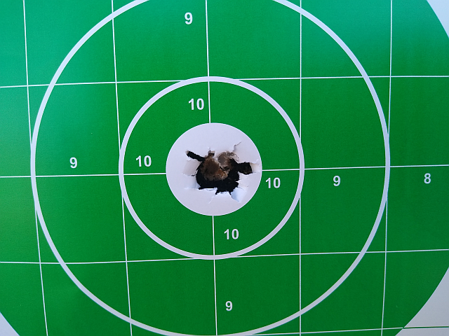

    Hey I got one like that. Bone stock 700LTR in 308. E prefix on the action, where ever that puts it in time.
    Low right shot was first round after putting the action back in the stock and mounting the scope. 4 shots in the center. Best group I've ever shot in my life. (.308 already subtracted)
    Then a year later, lightning struck again. Five shots in this one.
    100 yards, 168fgmm.
