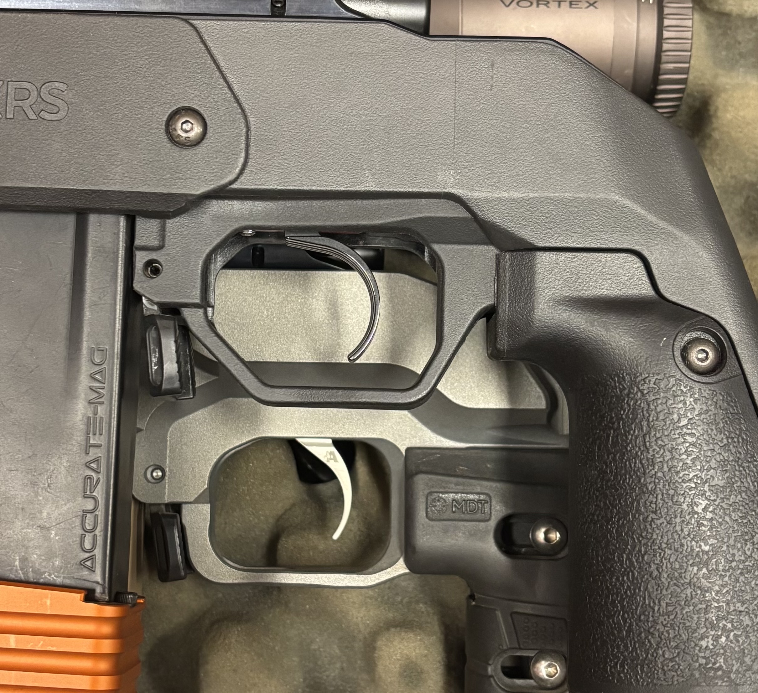

Also, looking at getting the gator shoe. Currently have flat shoes on my TT. I’ve had a TT curved before but actually did not care for how steep the curve was, kinda cradled my finger too much if that makes sense. May sound weird but I didn’t like it.
Looks like the BnA curved shoes aren’t as steep. Can anyone confirm that?
