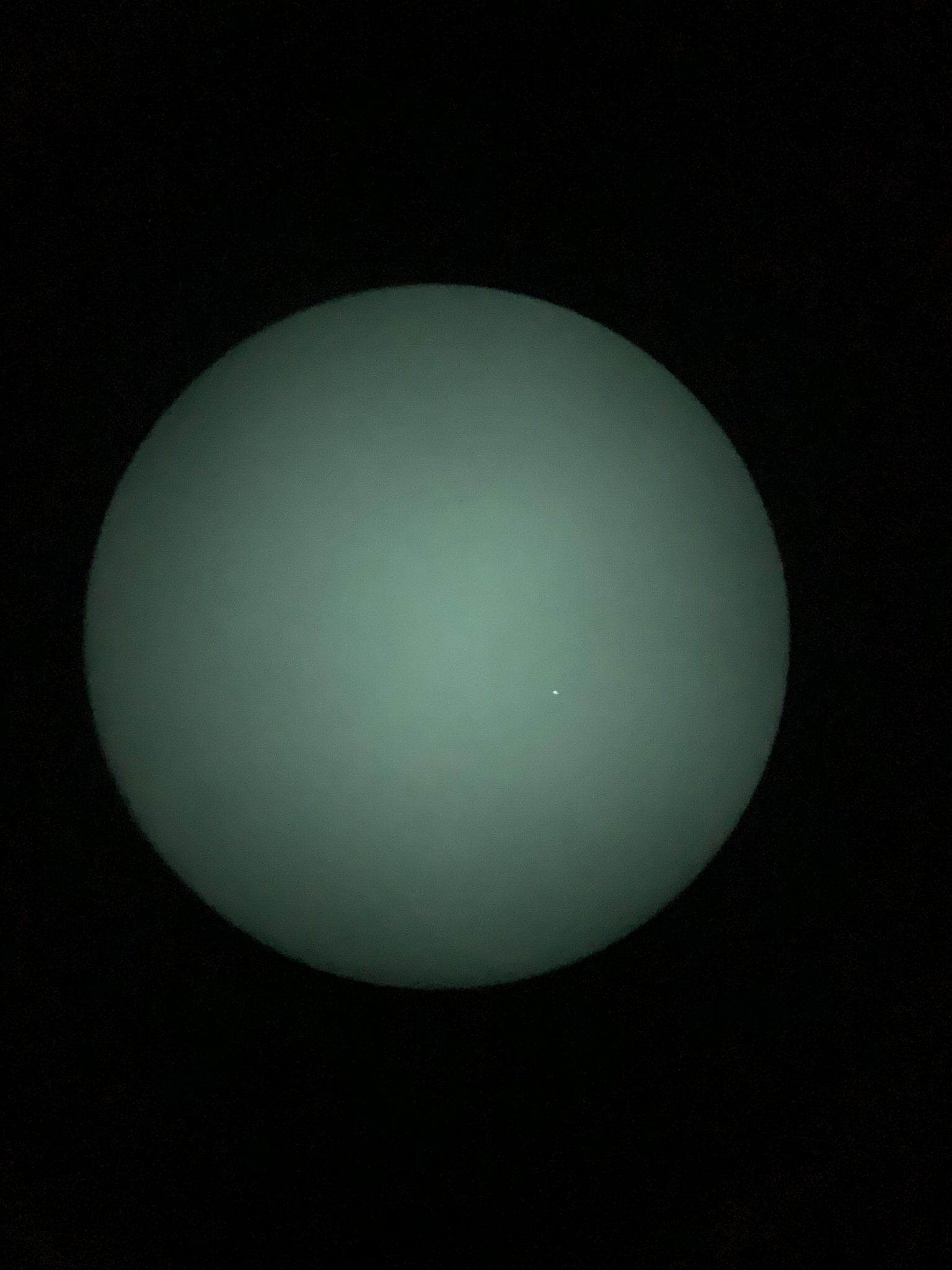

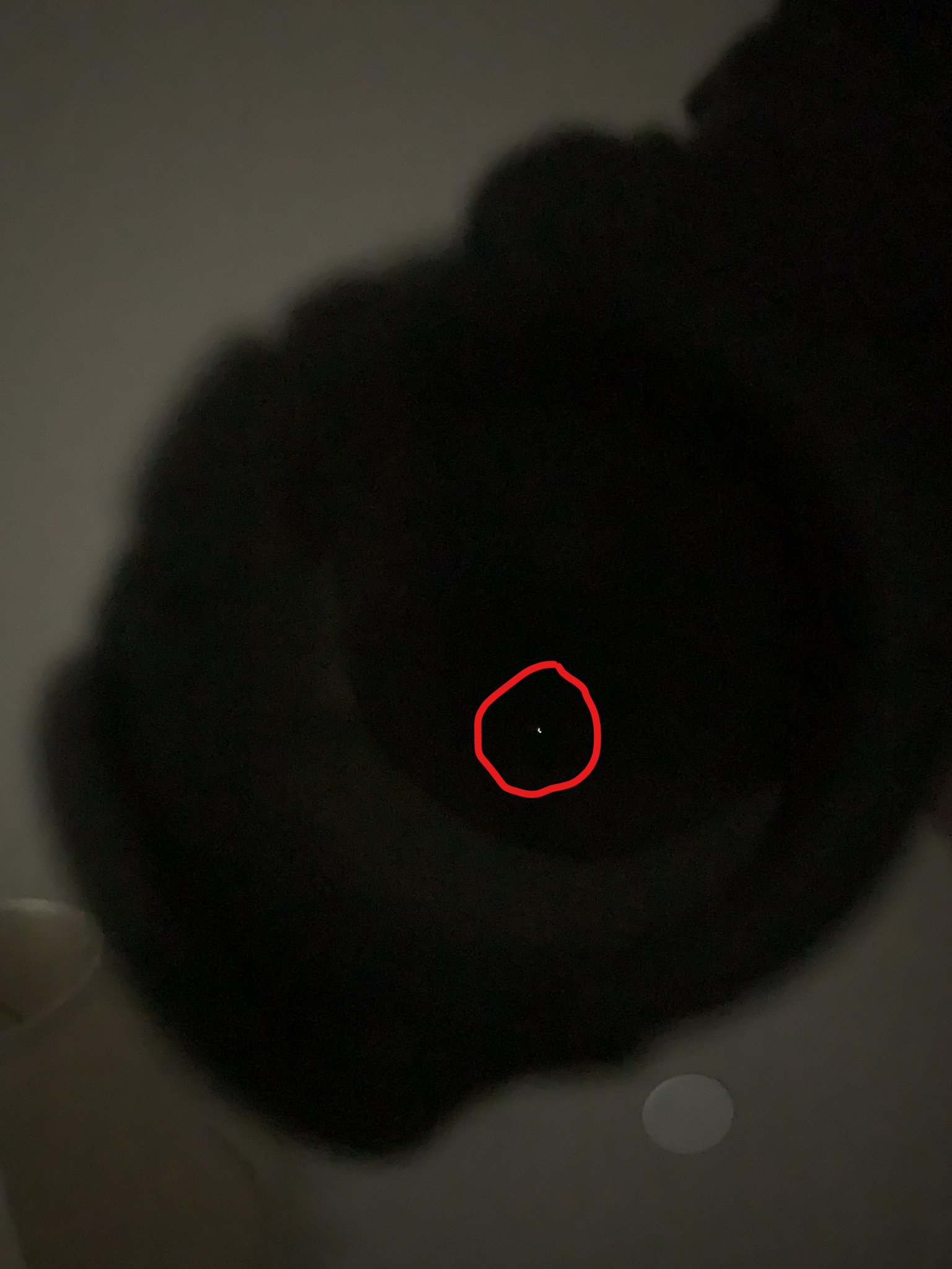

I just received a set of BNVD-SG-UL (w/ L3 filmless WP tubes) that I purchased second hand. Upon turning on the unit, I noticed a bright spot on the left tube that does not go away even when I block all light sources. The bright spot is pretty small, but the seller did not mention this prior to completing the transaction.
Is this an emission point? Is this something that can get worse and should be sent in for warranty service?
I tried to take a pic the best I could, see attached pic.

If its the set off the arfcom EE, its should still be under warranty. NVD should warranty. Though you wont have nods for a bit either way. Up to you how you want to play it, but yeah if the seller didn't disclose it, this is definetly an issue that cant be brushed past.

Yes it is the set off the arfcom EE. Are emission points repairable? If NVD warranties it, do they repair the tube, or replace it with a new one?

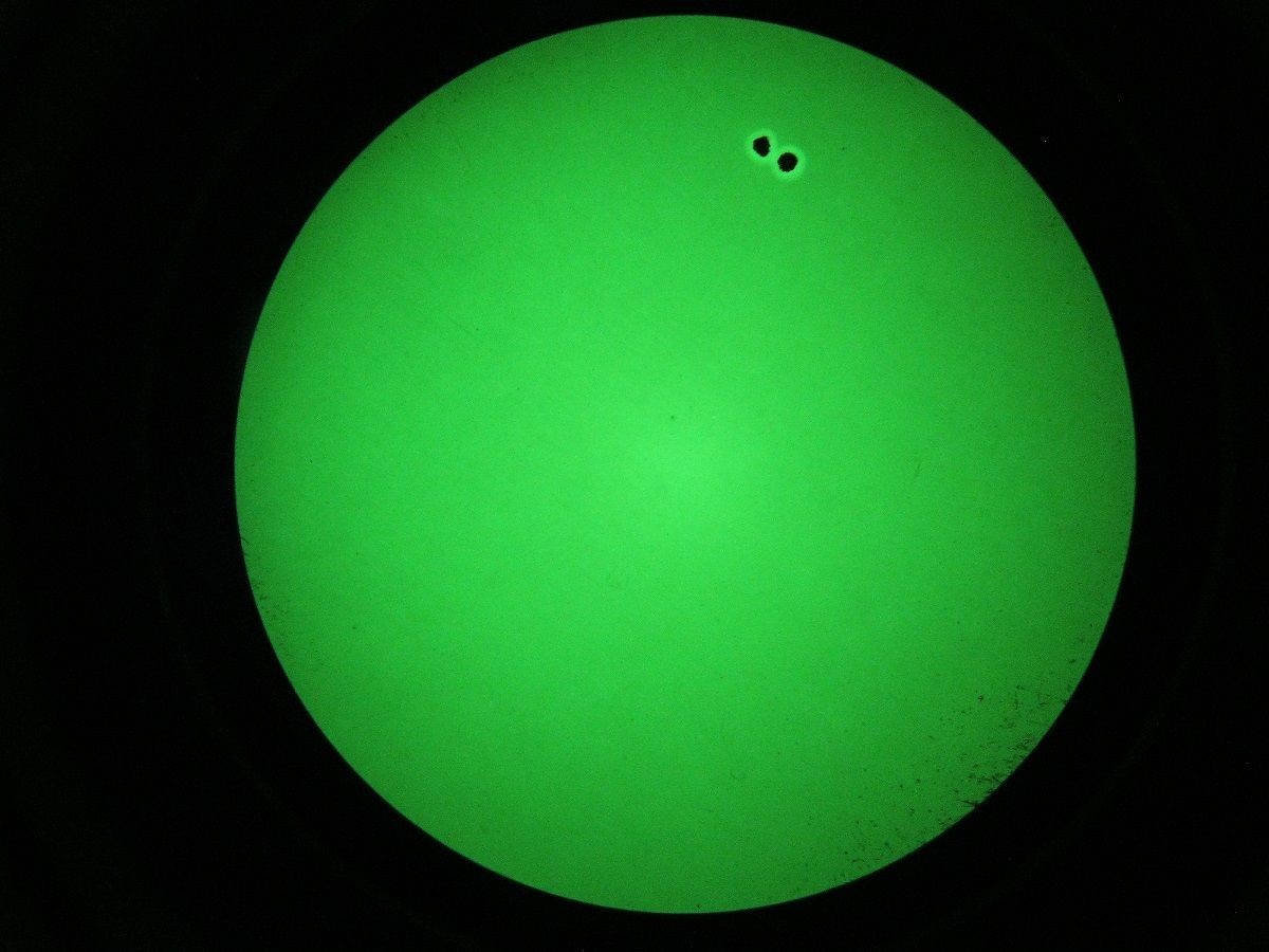

They can be "repaired" but its far less than ideal . Laser rework of the area can "seal" the emission point. Those tubes were nicely matched and it'd be a shame to lose them, so I can imagine what you're going thru.
But such procedures would lead to a BIG spec around the area like .009 and above. So you wouldn't be happy with it, if you and the original owner is going to be squared away by warranty, getting a replacement tube will probably be your best bet.

Edit: attached a photo of a tube that had emission points sealed.
