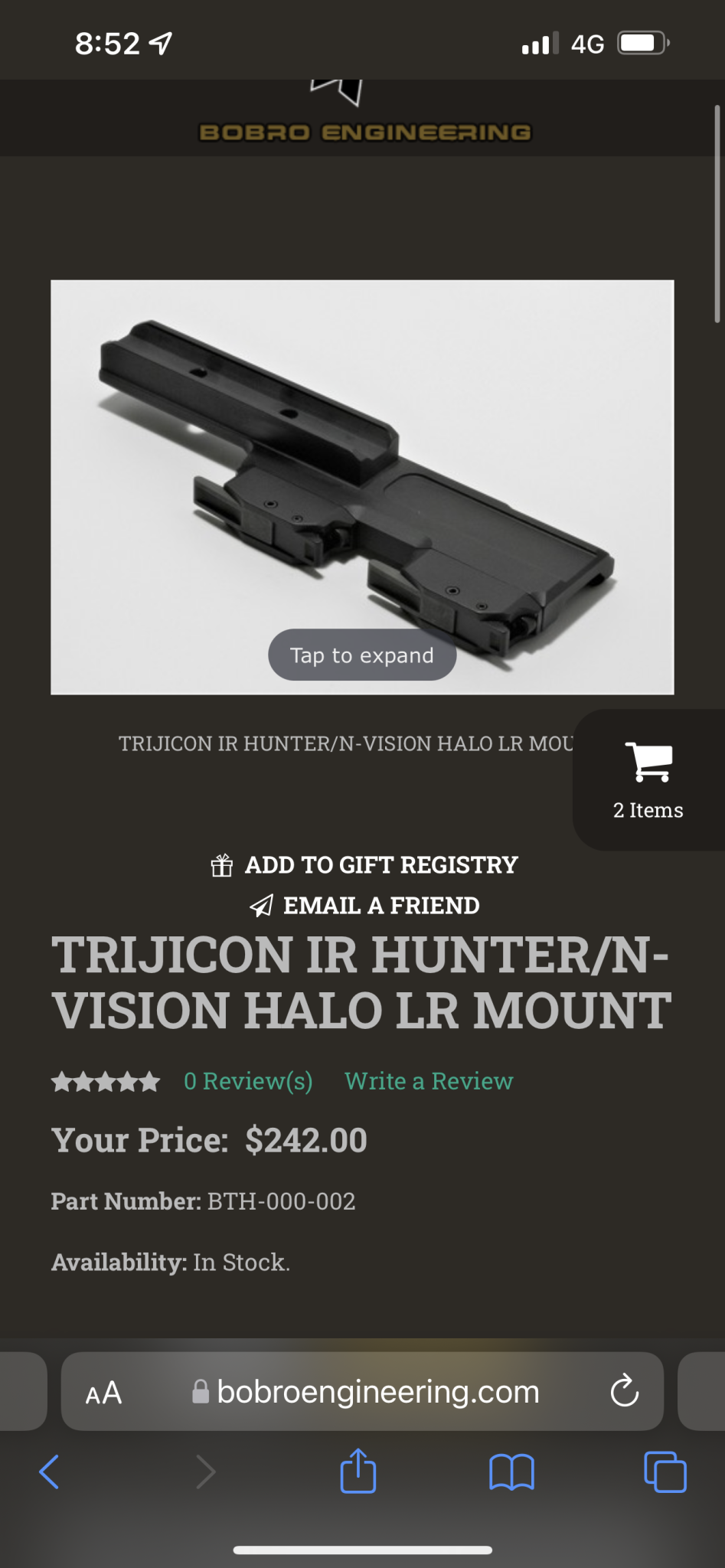

Just so we are clear this is the mount we are all talking about right?
View attachment 7746032Reviving an old thread. Anyone else have experience with this mount? I just ordered one to put on a bolt gun. I don’t understand the above comment how it did not address eye relief? It sets the scope back quite a bit it appears. The levers on the right side of the mount shows no thinking by Bobro on this one. My worry is that with a 90 degree action these levers will interfere with the bolt. Was that your experience @Rfeldhaus

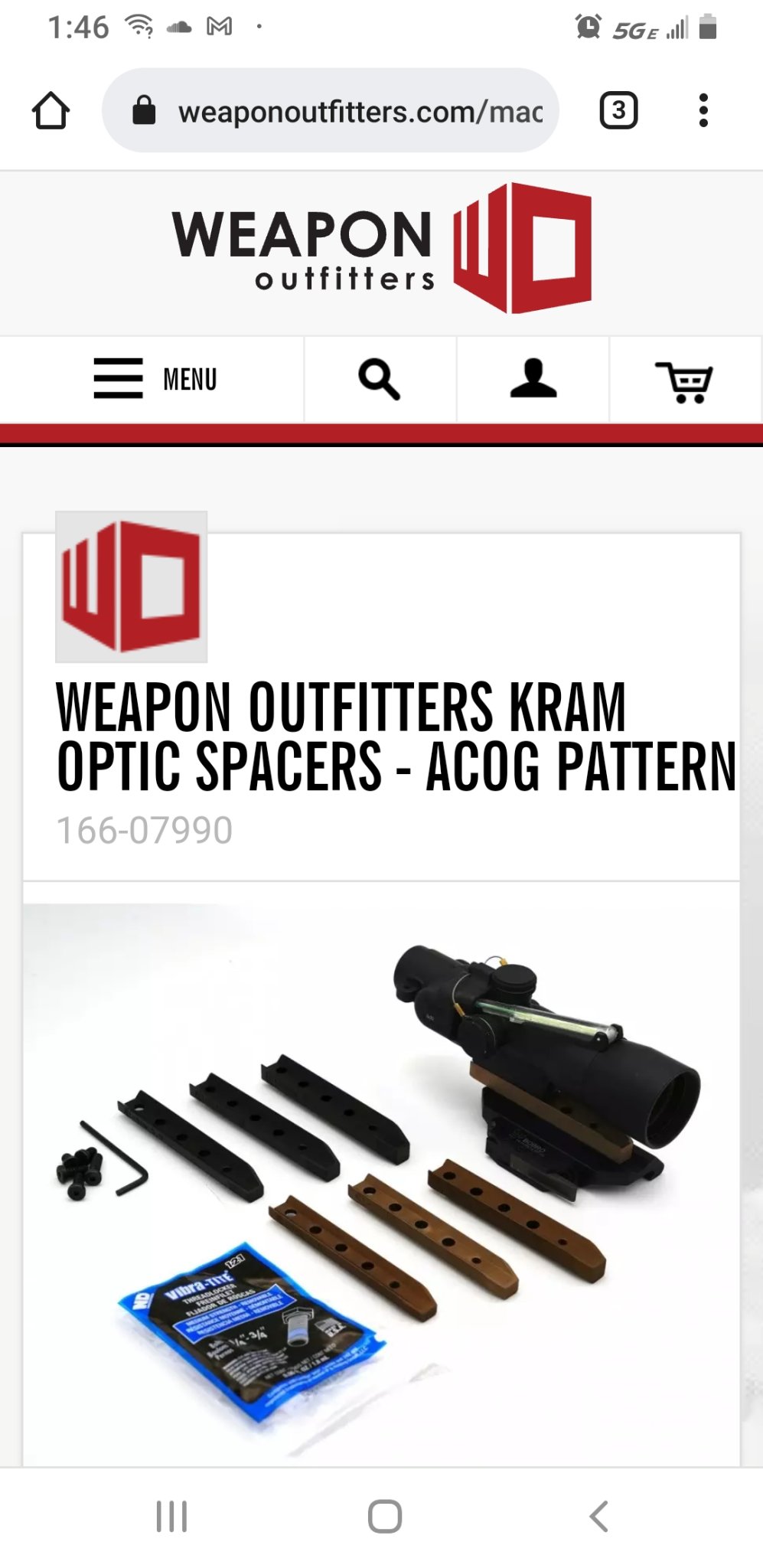

I think the best mount for the trijicon mkiii series is a geiselle super precision vcog mount, or a (discontinued) zrodelta acog mount and one of these ....
Both mounts will move the optic back towards the eye, and the 5.5m spacer will give enough
clearance to cycle the bolt.

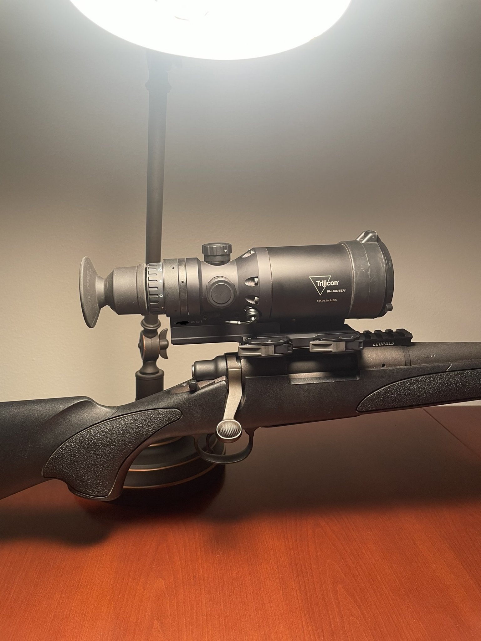

While not many people may be looking at this thread because it's a bit outdated, I thought I'd post my input considering I was looking for answers and find very few. I bought the Bobro IR Hunter Mount for my Trijicon IR Hunter MKIII despite multiple comments stating proper bolt manipulation and eye relief on a bolt gun would not be possible (I planned to run it solely on my AR because of this). However, after mounting it to a factory Remington 700, I will certainly be using it on bolt guns in the future.
Everything about the R700 is factory (except for a standard length pic rail). While more rear travel would help for proper eye-relief, it's still completely usable for taking shots with or without the rubber eyecup. With the eyepiece, you're going to have to move your head forward to engage the shuttercap, making it a bit awkward. Without the eyepiece, the corners of the screen will be cut off. Either way, a cheek riser will definitely be needed if you want a good cheek weld. I also have no problems running the bolt or obtaining proper bolt manipulation. The bolt is close to touching the rear clamp lever, but sufficiently clears it.
For AR-15s, you're not going to be able to move the mount to the rear most pic rail position because IR Hunter battery compartment will hit your charging handle. Even so, the mount works great in the position I had it in.
I hope this helps anyone looking.

It'll bring it back approximately 2 & 1/4 inch. For reference I measured the part that isn't resting on the pic rail. It'll also raise it slightly, but not enough to make it unusable. You'll need an adjustable cheek rest if you want proper cheek weld.
