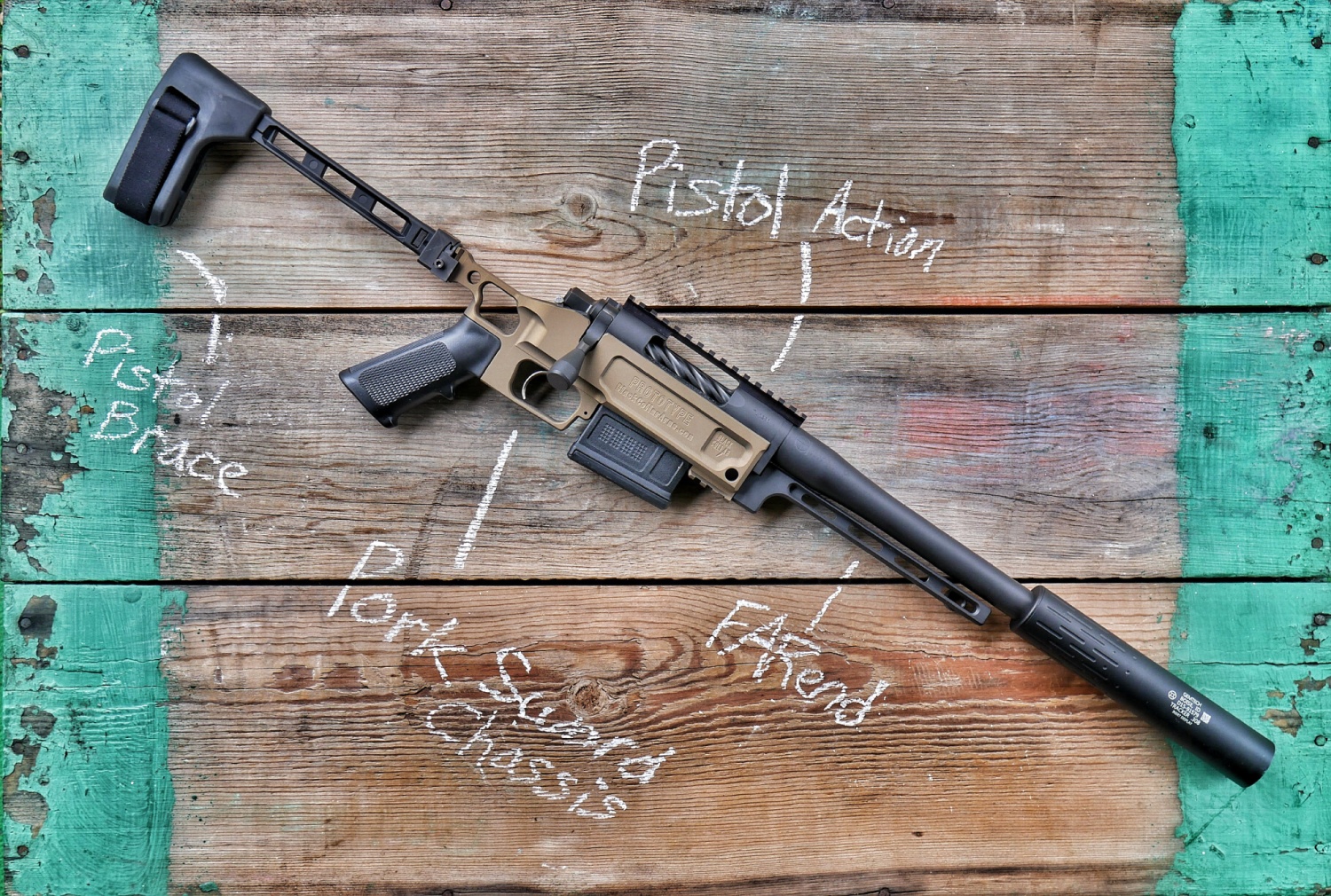

Not sure if this is the correct forum but have many here ever purchased a barreled action say like a Howa Mini 300bo and cut barrel down and used a brace to pistol it? Like a Pork Sword or Q Mini Fix. I see that Brownell featured one on a review. I called Brownells and they send the barreled actions as listed as "other"and as long as the ffl papers it as "other" your good to assemble as desired. Not sure why I want a 10" folding bolt gun but , heck, why not.

I'm in the process of building one right now. I am going with the pork sword chassis and a rem700 action. Brownells had them on sale for $275 last week. Waiting on my my barrel.and I'll be good to go. I'm going with 300 blk but black collar has ran a short .308 and 6.5 creedmoor. Supposedly took them to over 900 yards.

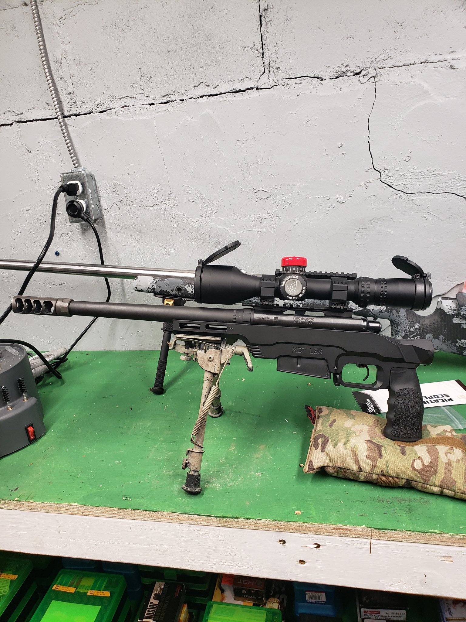

I ended up ordering a brn stock in fde to place on my rifle and will use my lss on the pistol. W
I've always kinda wanted a longer forearm on the Grendel rifle and the lss will make a great platform for a suppressed pistol.
