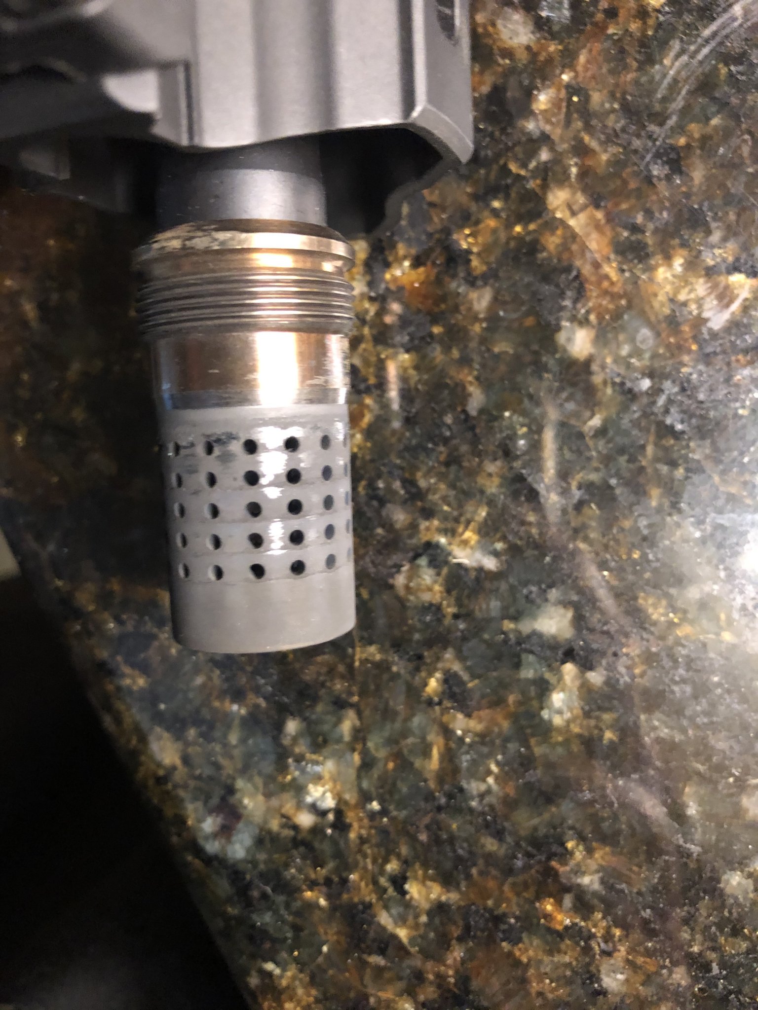

I planned to convert the TBAC to the tomb system. Just for the fact that if I screwed up the threads I could swap it out and not jack up my barrel threads. Only reason I haven’t is I’m scared ship my TBAC out in fear it would get lost and I’d never recover it as Biden would shut my replacement down
I’ve read several threads where the tomb style muzzle device came off with the suppressor etc. I believe if your use rockset or red loctite you’d be fine. Pending you don’t heat the loctite up.
All this said. My TBAC would loosen up on my AR10. Had to pay attention to it and retighten. My Saker ASR hasn’t loosened up ever. I had a buddy dump a Magpul D60 through it just to see what it did. Lots of smoke but the suppressor never loosened and could be removed by hand after it cooled
I will most likely stick with the DT for the bolt guns as I won’t need to purchase $100+ brakes for each gun. And utilize the ASR for the AR15’s where the rate of fire is more likely to loosen the can

Funny that you posted here as your the person I remember having issues with the tomb on the TBAC
