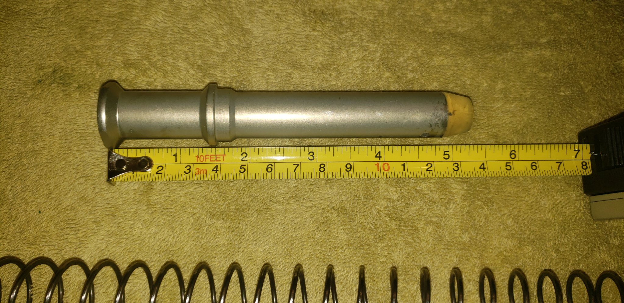

    It is a308 buffer, I made that mistake buying the longer ar15 before. Would the buffer tube being too forward against the retainer be a potential issue? It should be an A2 that the MBA requires

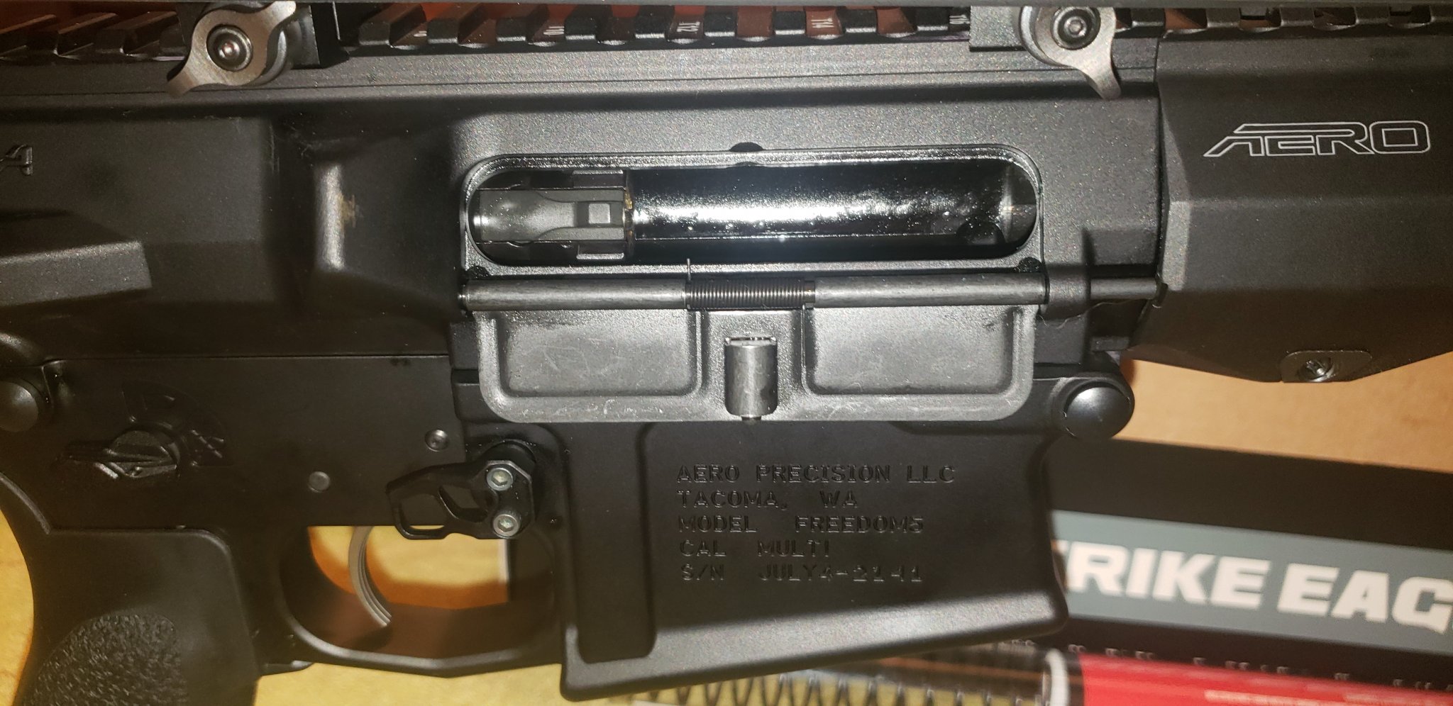

    Just got home and here is a picture of what I'm speaking of...

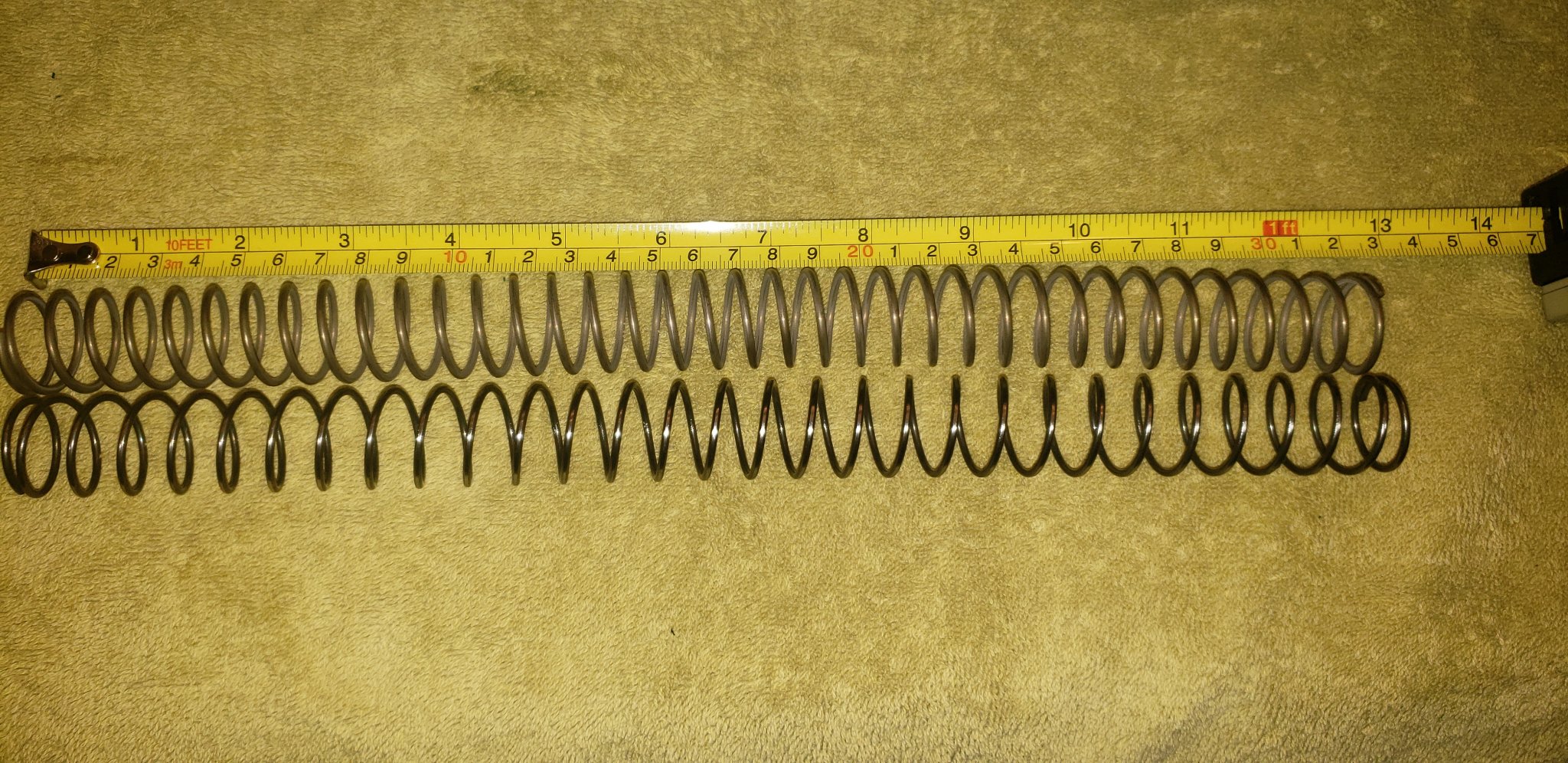

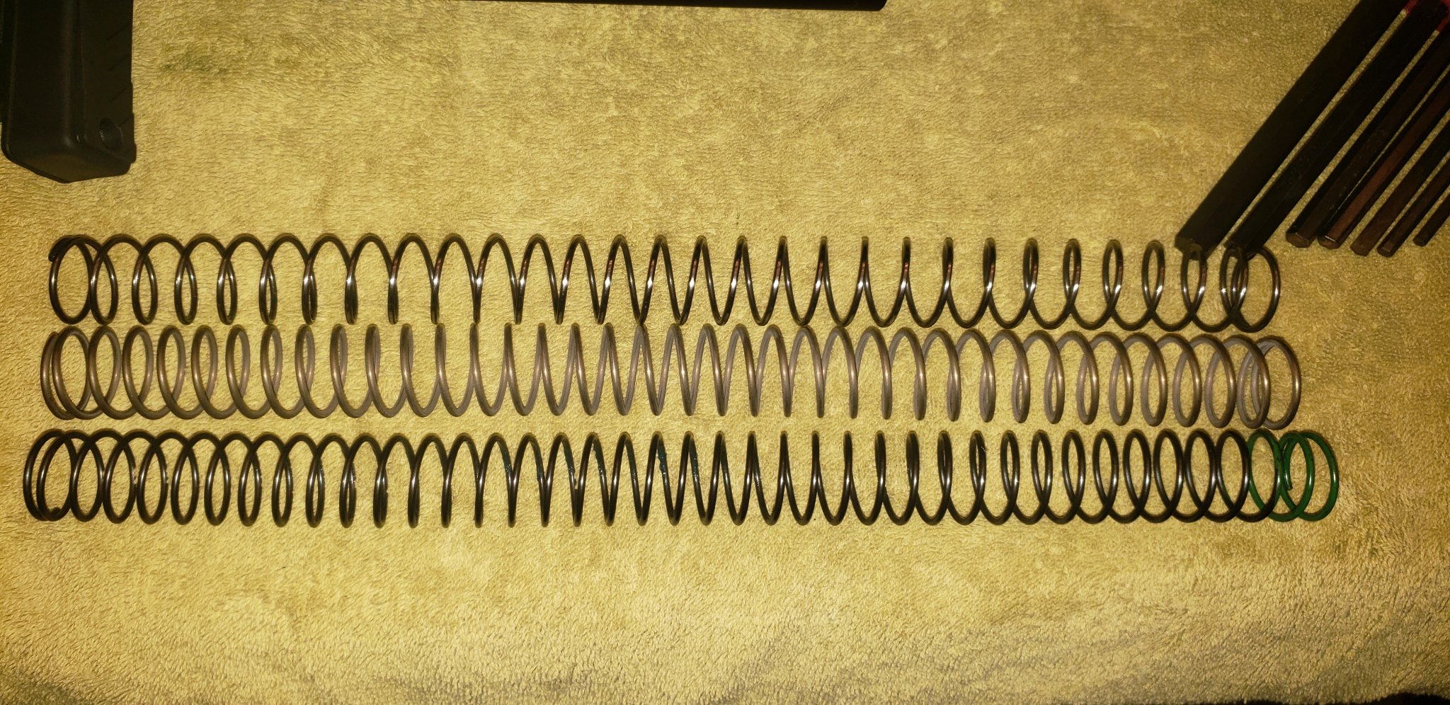

    Top spring looks like a ar-15 a2 spring to me, bottom looks more like the ar-10 rifle length spring. When compressed the top spring would be almost 3/4” too long so your buffer would bottom out in the tube before the bcg clears the catch. Buffer looks correct.
    I thought the green spring was for any rifle length buffer tube/A2 style? I have the carbine length springs laying around I'll try but I thought that was for only carbine length tube? :unsure:
    Number of coils, when fully compressed the spring will be longer than one for a .308. A .308 carbine spring will be the same as the .308 rifle spring, the difference is the buffer and tube lengths.

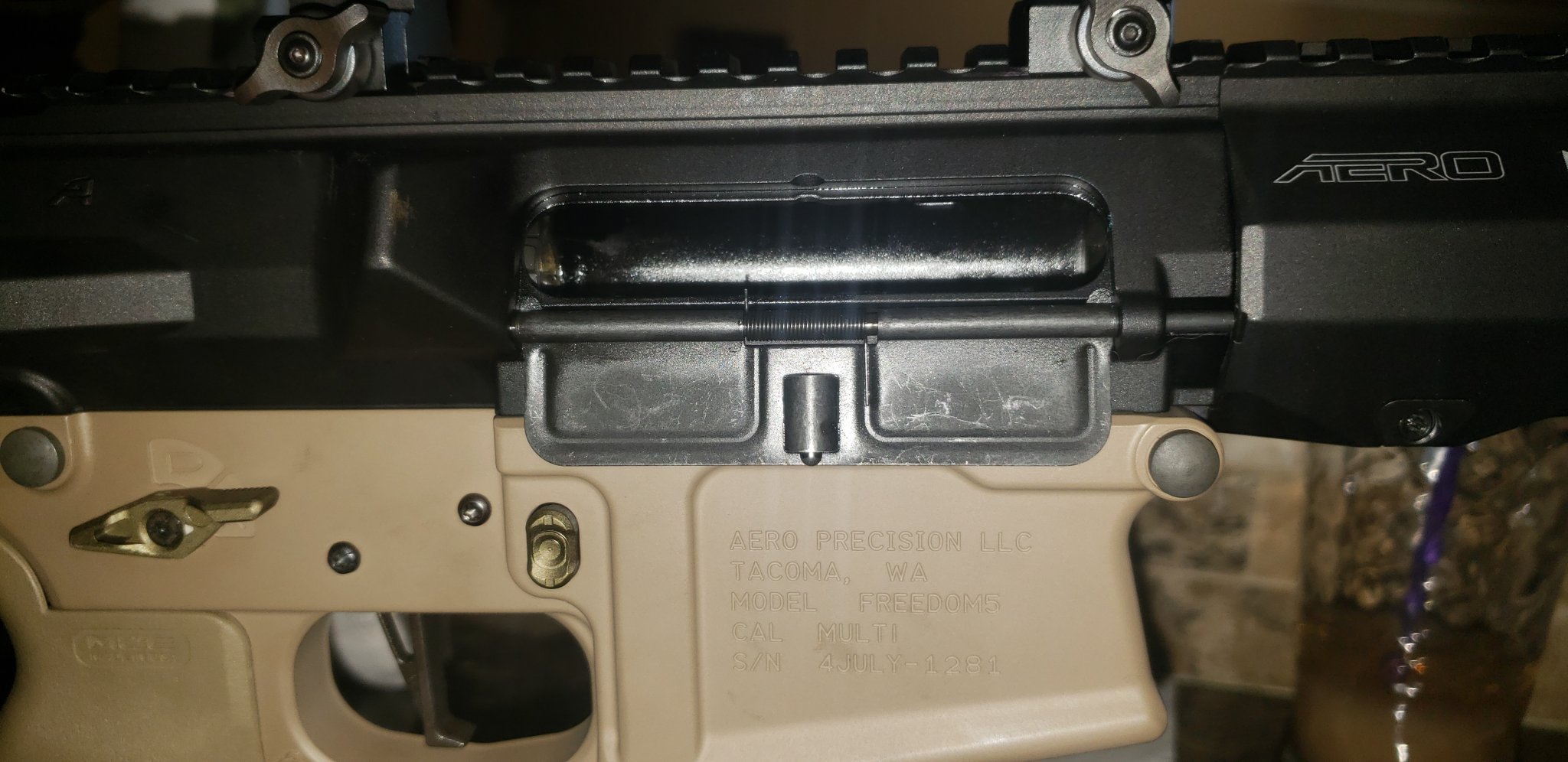

    I borrowed my father in law lower. Also an m5 with a rifle leftmost length tube and spring, and the bolt will lock on the face. I took out the same combo buffer and spring and put on the lower in working on and it doesn't lock back on the bolt face

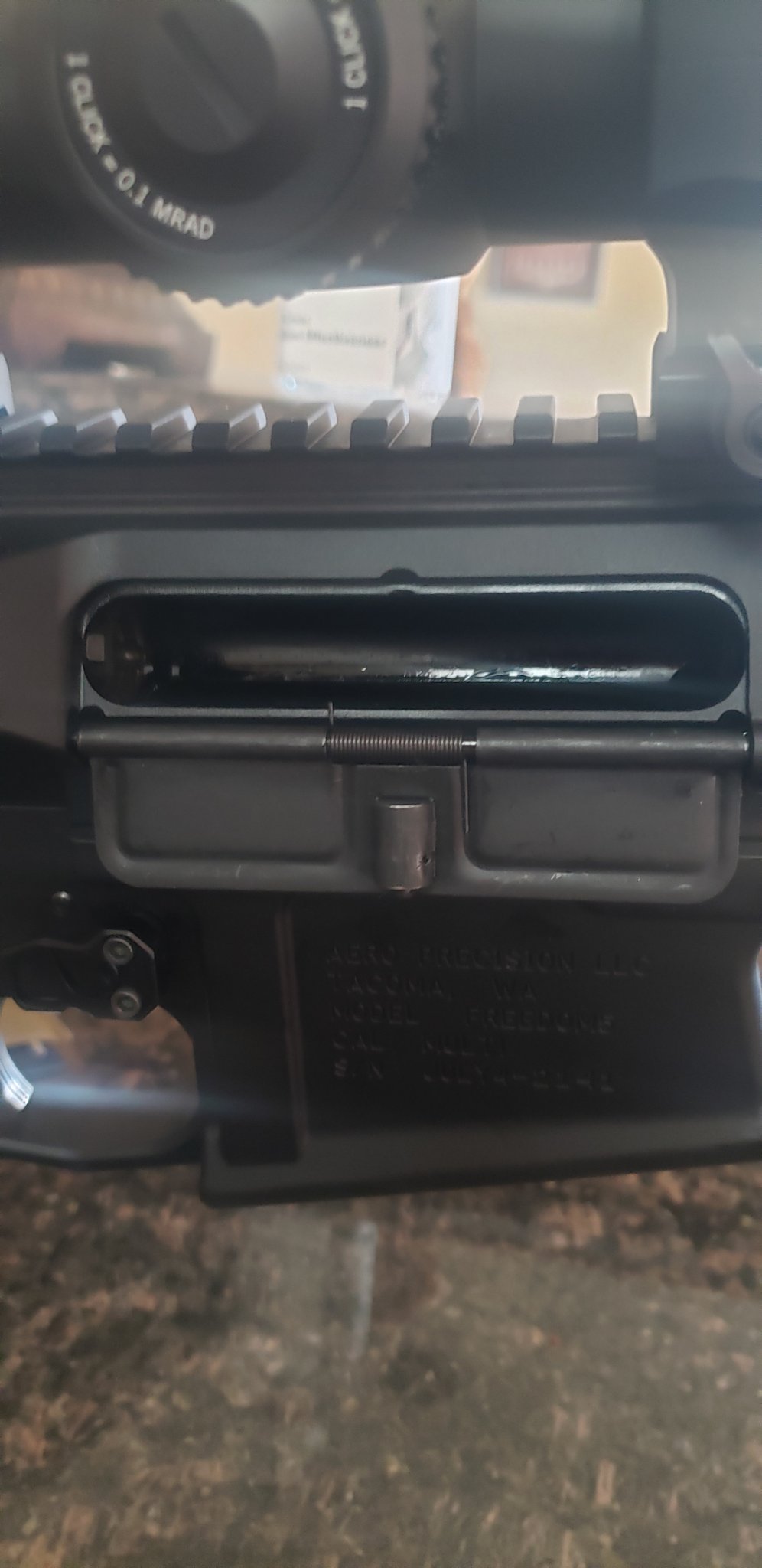

    Just got home and here is a picture of what I'm speaking of... View attachment 7400307
    Is this pic showing you pulling the charging handle all the way back or just the bolt catch on the carrier? What happens if you pull past here? The bolt catch will hit the back side of the bolt and stop the carrier if you are pressing hard to engage the bolt catch. Either way if the pic shows the bolt as far back as you can pull it something is stopping it. Find that something. Cheek riser, buffer tube length or obstruction , buffer/spring length, or the bolt catch hitting the back side of the bolt. It pretty much has to be one of those.

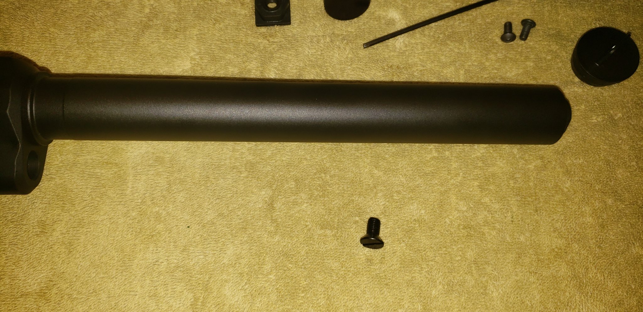

    I think I found the problem. The darn buffer tube appears to been out of spec. The bolt is closing now now problem

    its an Aero m5 catch. I took rifle to the range today and it ran with no problems. Went through a box of 147gr and 175 and experienced no problems. Thanks again to the forum!
