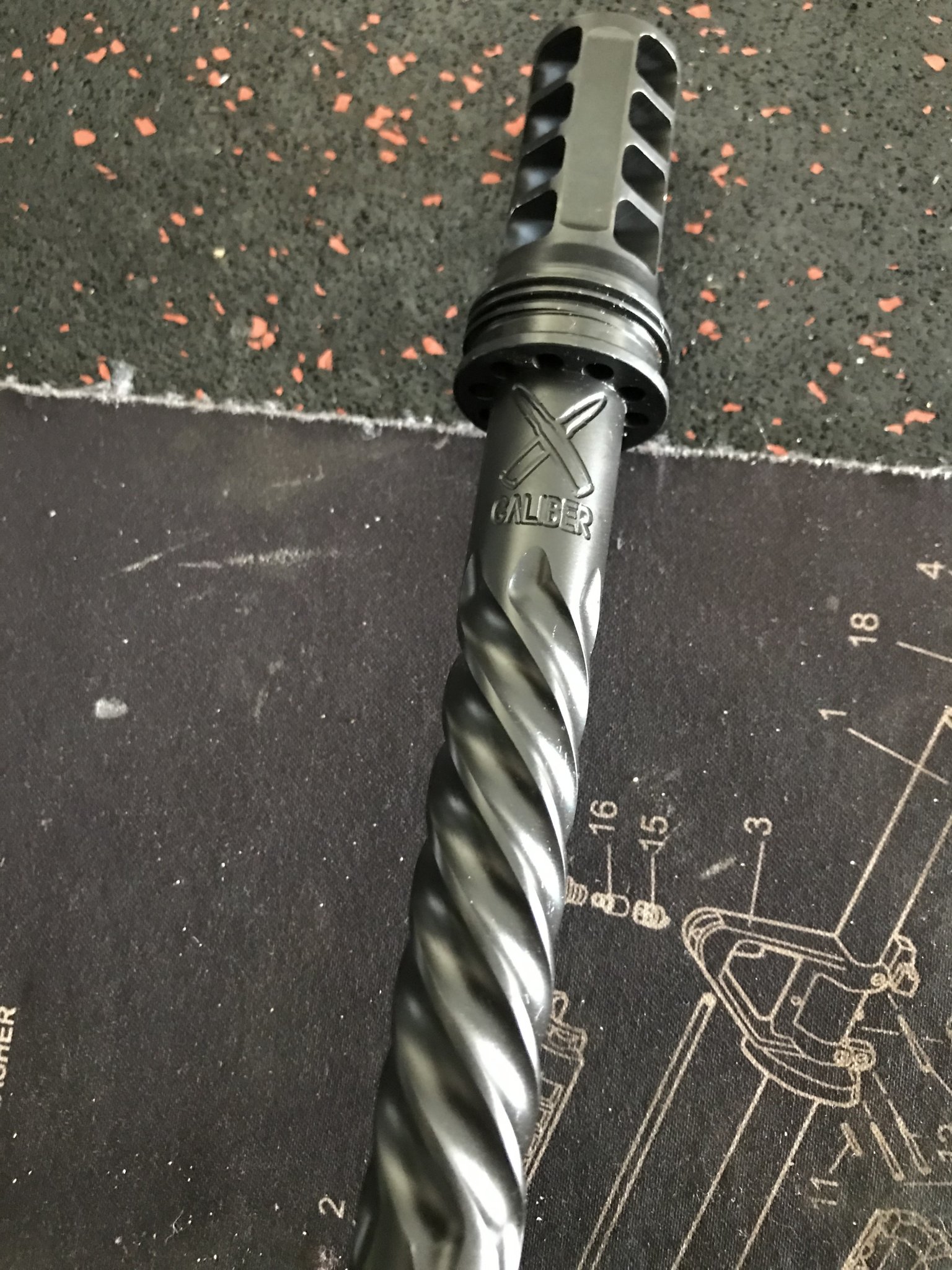

called them up and explained the issue. They said the port diameter on that barrel is small, had they known I was using an adjustable gas block they would have opened it up a little ( didn’t know they would do that) they also said to try .308 ammo through it and if I still have the same issue to send it back.

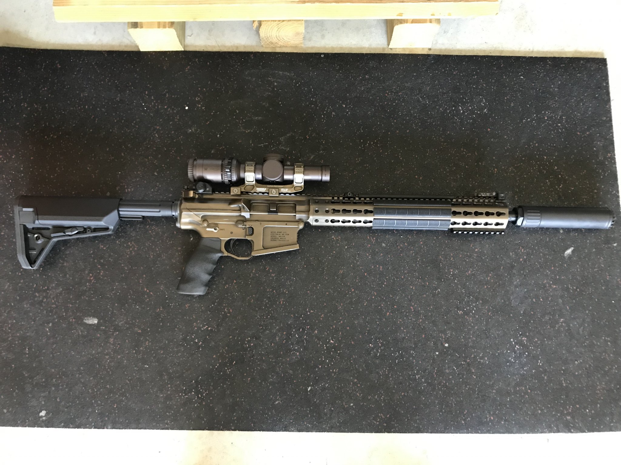

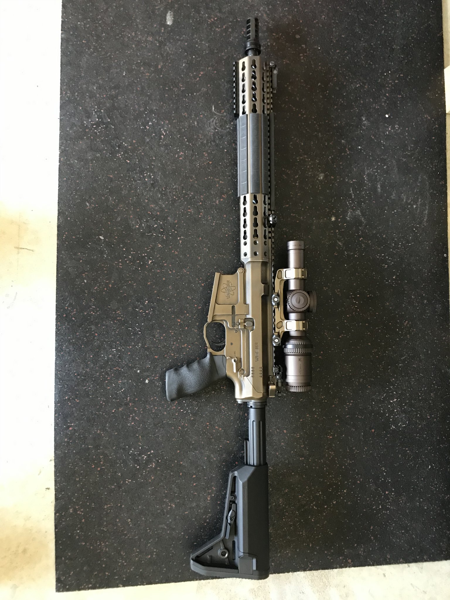

Here is a pic of the rifle, and the barrel. Boxed it up and sent it back

Very nice setup!
I bet they make it right for you, may end up with a new bolt out of pocket.
The old bolt may be fine with another barrel but I would be fine as long as it ran properly.

I received the barrel back yesterday, that was a fast turnaround and good customer service. Gonna head to the range in the next day or so to test it out.
I was out of town for a little bit but finally got back and was able to go to the range. The rifle is GTG now, headspace being too tight was the issue. X Caliber customer service is pretty damn good. When they received the barrel back (and the bolt, which I did not have them headspace it to from the beginning. Wanted to but I was out of town then also) they sent it back same day. They also drilled the gas port out a little larger since I am using a low mass carrier and adjustable gas block.
