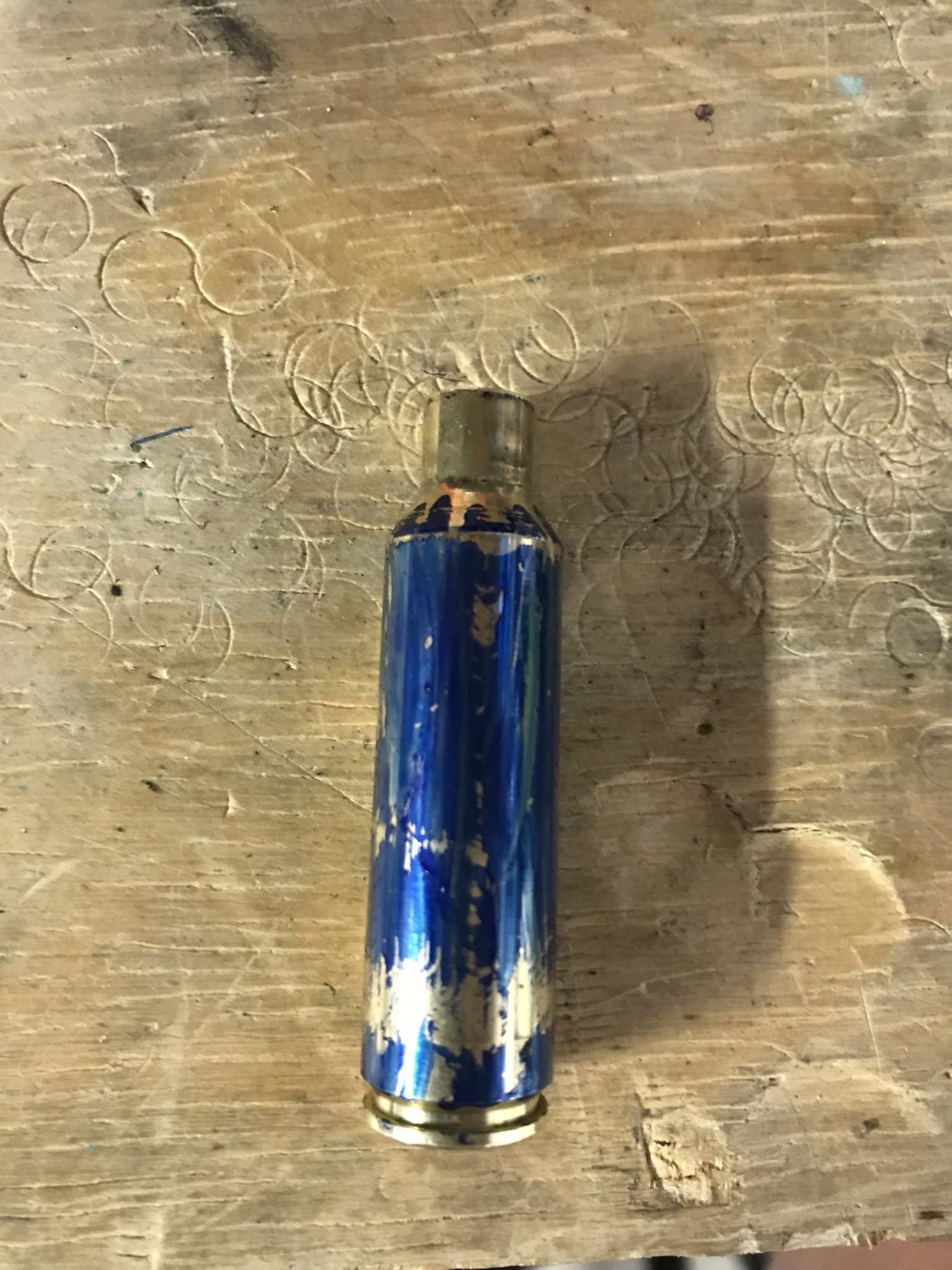

You’re die is likely not sizing the base just above the extractor groove enough. Measure before and after sizing to compare. You can also color the web area with a sharpie then chamber it and look for interference marks.

I attached a picture of where the binding on the brass

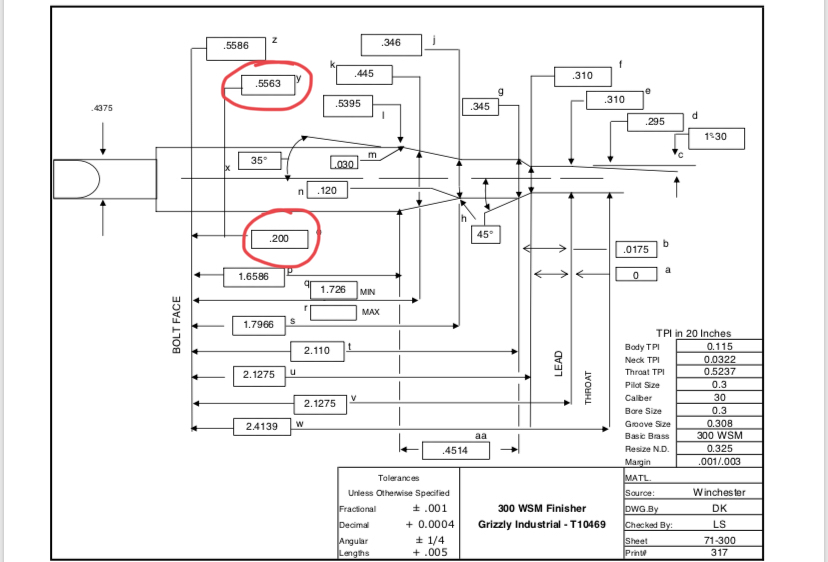

If you’d provide the base diameter .2 above the case head on a fired case, we’d be able to tell you in a second if the problem were an undersized chamber, or a die that’s oversized at the base.

UPDATE: It doesn’t appear to be an undersized chamber. He made a pin that is .556 and it dropped in the chamber approx .050” - .075” deep. The SAMMI specs is .555.

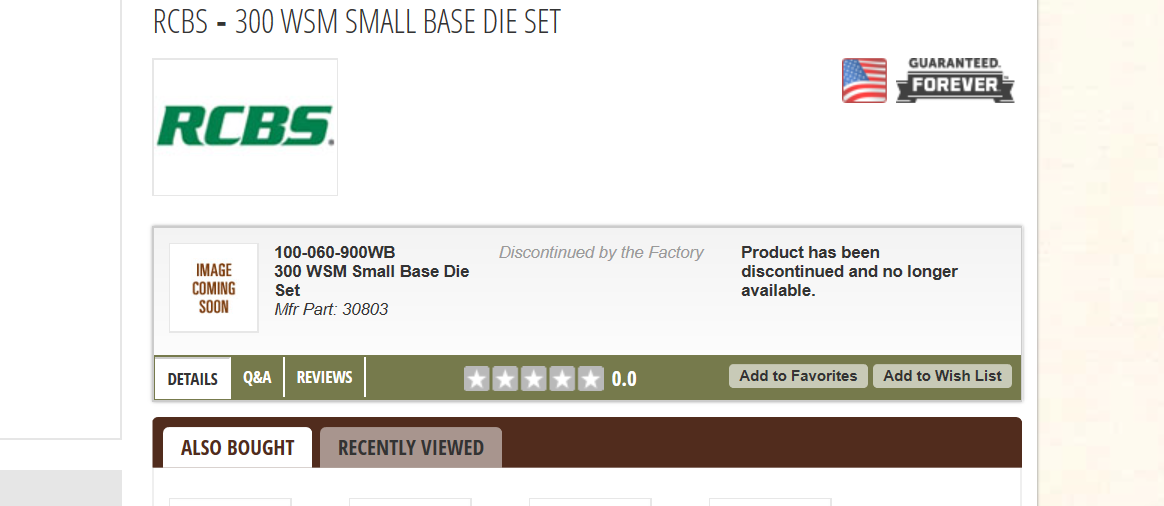

Back to square one. I’m going to be ordering a small base sizer die and hope that it doesn’t bump the shoulders too much to affect the accuracy.
Shows “discontinued” at Natchez.
RCBS site lists without any mention of availability. But also states “ Note: Not recommended for ammunition used in bolt-action rifles.” Thoughts on that?
The OP’s chamber is too tight. He needs to get his case sized tighter than what his standard die is doing. Look at the pics. It doesn’t matter what RCBS says. His chamber is not a typical bolt gun chamber.
