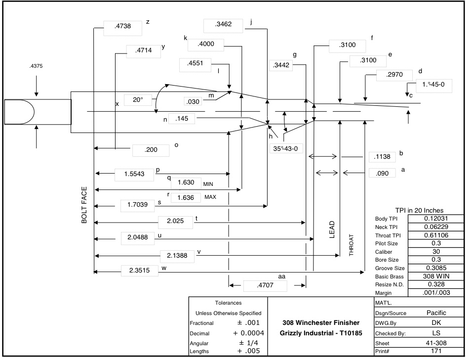

You are not wrong. The two are different. So let's take a look at the bolt itself. Is there anything mechanically that is hindering the rearward motion of the bolt? Is it the bolt itself or is it the brass hanging in the chamber? When the empty case comes out, is it scarred or marked in any way? Have you taken measure to to compare fired cases of the new brass vs. the Lapua brass?
Reactions: Subwrx300

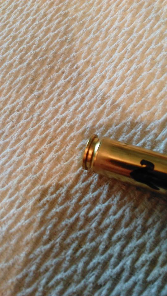

Yes I seen a small mark on the brass on a few but some that was hard to remove had not makes so I don’t know if it’s from the chamber or where I have to Mortor the rifle to get the bolt to the rear it might be hitting the ejection port and making a nic in it and yes I have compared to the 2 different brass after firing and measure the same i greased boot lugs and bolt just to makes sure it is all good but still no joy I can shoot one of the old with no issue and then a new one and have issue I’ve heard of guys having issues with neck sizing kind of like this but that why I use the type S bushing die from Redding so it always full length resizes the body to prevent or I thought would prevent this issue

Showed up as a slightly scratched looking ring nearly exactly half way up the body of the case. You could try polishing the chamber to see if that helps. Good luck!
Weird. Can you measure the diameter of the case at base and a few points along the length? My factory Howa chamber developed a ring in the middle of the chamber that had bulged ever so slightly and allowed brass to become convex in the middle. Every once in a while, I'd get the exact condition you described. Happened around 2500 rounds using Hornady brass. Ended up just tossing the pieces that got sticky.
What you discrided does look like that on my cases but it’s all the way around looks like someone scruffed up the brass with steel wool or something just figured it was from the hard extraction but that might be it I did check the body of the case just up from the head but I’ll check a few more spots and make sure thanks

Weren't the original reamers spec'd at .470" in that area? Is anyone sure Remington uses match reamers? If he enlarges his chamber, with his die getting brass back to the .469" range now, sizing will be a pain.
Here's a pic of Peterson 6 creed brass fired from an out of spec chamber, measured .4725" after firing, die took it down to .470", which is about the same amount he would now be sizing with a "fixed" chamber. The brass in pic shows a distinct line where the brass was rolled.
Saami for .308 is .4714”. I don’t think Remington is capable of match anything LOL. I also wouldn’t expect any .308 chamber they make to be at or near minimums. I was also under the impression that they were hammer forging the chamber into the barrel in the same operation as the bore(no chamber reaming at all).
If he’s sticking cases in his chamber and coming out at .470, his chamber is small. Also, his die is only knocking .0005-.0001 off that. That’s not much.
I took a quick look through prints for my reamers.
6x47L( ptg) .4720
6XC (Tubb’s reamer, ptg) .4714
6CM saami(ptg) .4714
6cm custom (Manson .)4710
6cm (jgs) .4714
6.5x47 (ptg) .4720
6.5cm saami(ptg) .4714
30-06 saami(ptg) .4708
