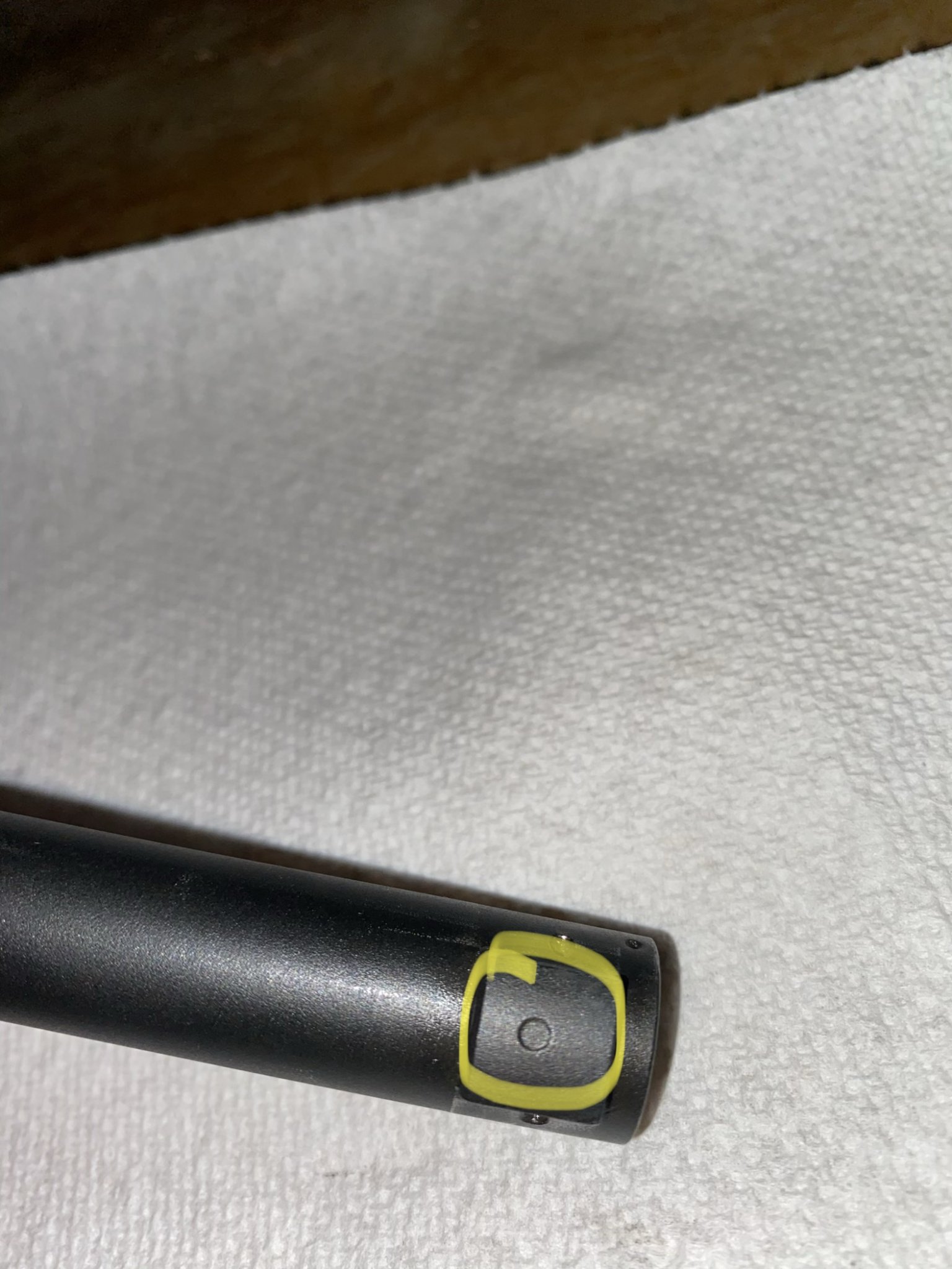

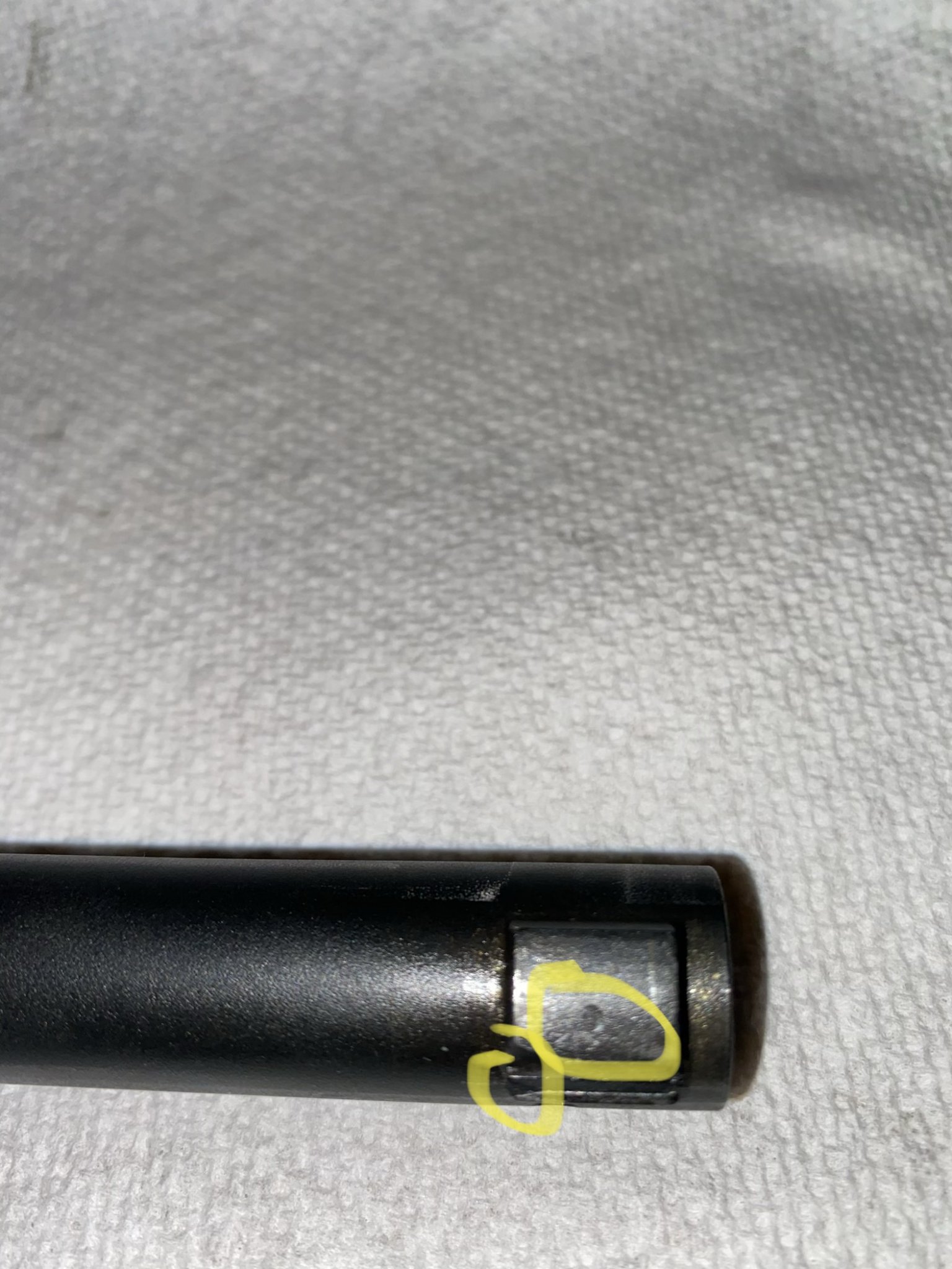

I recently bought a Remington 700 Pcr enhanced, I have less than 300 rounds through it and lately I noticed it was hard to fully chamber a round sometimes, the bolt would go forward almost all the way then get stuck and won’t move forward. I have upgraded the trigger but I wouldn’t imaging that would be part of the issue. I Have also found a dent on the one lug and a small chip in between the one groove. And on the other side there seems to be a perfect circle like someone took a punch to it ( could be from the factory). I also seem to have some uneven wear on the lugs. If anyone could help me out on what I should do that would
Be great , I am fairly new to bolt action rifles.
The chip on the anti bind rail and the indent shouldn’t have anything to do with chambering. If the anti bind rail were to cause an issue it would be when you initially start pulling the bolt rearward and the rail engages the groove.
Did the rifle always have an issue chambering? If not then something changed. If it’s always done it then it’s more likely to be something between the chamber and ammo not getting along. Hard to say without a lot more details and trouble shooting but it’s highly unlikely that those two things are causing you’re problem.

I recently bought a Remington 700 Pcr enhanced, I have less than 300 rounds through it and lately I noticed it was hard to fully chamber a round sometimes, the bolt would go forward almost all the way then get stuck and won’t move forward. I have upgraded the trigger but I wouldn’t imaging that would be part of the issue. I Have also found a dent on the one lug and a small chip in between the one groove. And on the other side there seems to be a perfect circle like someone took a punch to it ( could be from the factory). I also seem to have some uneven wear on the lugs. .
My 2 cents.
Don't worry about the "dent" on the outer radius of your right lug. It is not a dent. It is from Remington production and has nothing to do with your issue.
Likewise, you do not have a "chip" in your anti-bind rail groove. Again, that is there on purpose by Remington and has nothing to do with your issue and is not a flaw or defect.
90% chance your ammo is oversize.
