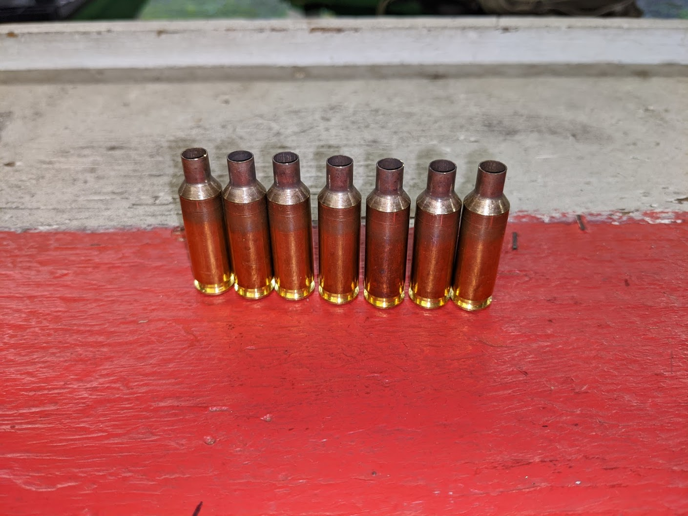

    What kind of brass? My shooting partner experience issues with difficult bolt close/open due to the out of spec size of virgin brass.
    Bolt opens/closes without any problem. Cycled a few dozen rounds through my MDT 12-rounders. One of the MDT 12-rounders though I need to fix the feed lips (bought it used) and someone had mucked with them causing a weird taper at the front causing the round to spike. But in general feed, extract without any issues. No hitch at all.

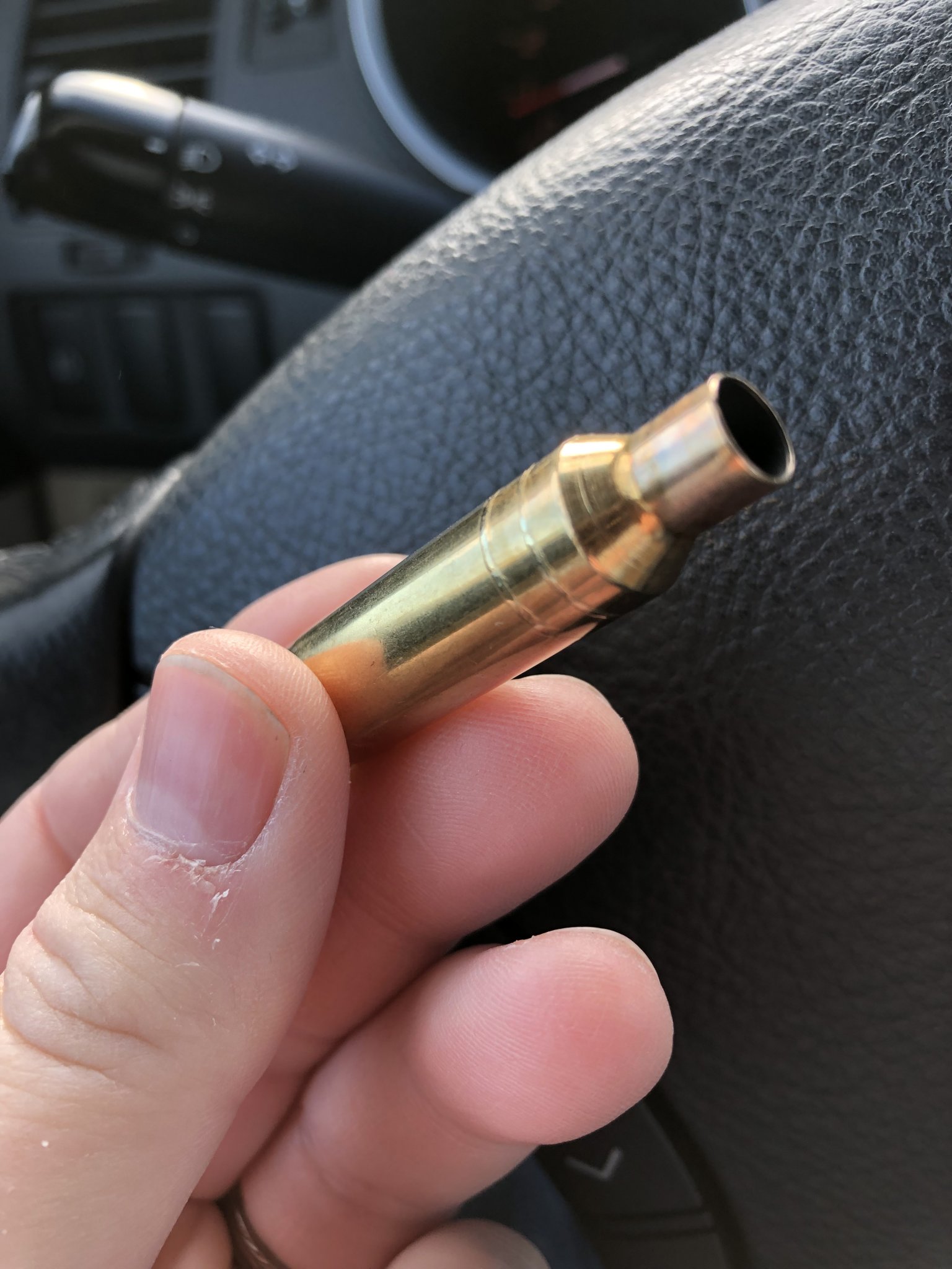

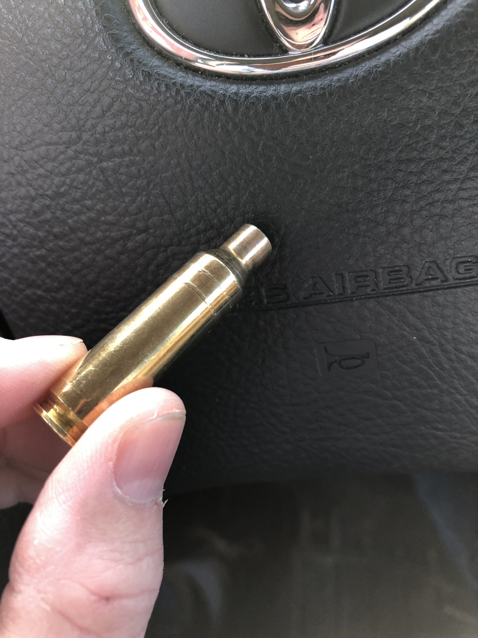

    This only happens on a fired round. I do notice this mark in the brass, looks like maybe a slight issue in the chamber, that needs to be fixed, maybe that little bump is causing the slight hitch on the extraction?
    It's not a scratch, You can feel it noticebly when you run your thumb on it. Might be kind of hard to tell from the picture, but there's a line across the brass about 1/8" down from the bottom of the shoulder.
    So the first part of the bolt lift is fine, I think that's cocking the trigger? Feels exactly the same as when I'm dry firing, or shooting my 308, then there's a bit of a hiccup, where I need to make sure I put more force up to get the bolt all the way before I pull back. I think that's the part that starts the extraction process.
    A defect in the chamber will cause heavy bolt lift. I experienced this before. For the record this was a barrel cut by a very reputable smith.
    Obviously the smith missed this in QC. He was easy to deal with and refunded my money.

    If you have access to a borescope, check the chamber. You may be able to feel whatever is causing that with the tip of a dental cleaning tool, but be gentle. You don't want to scratch the chamber.
    Is that ring raised or is it a groove?

    My bulge isn't that bad as your picture. My smith is dealing with it and cutting a new barrel right now. He could possibly hone it out, but that'll also widen the entire chamber specs by a little bit - so I think a new barrel, and maybe cut this one down to a 24".
    It is raised.

    I would not accept a repaired barrel. I would demand a new barrel be cut.

    Have him check it. May just need to be set back 2-3 threads. Probably no big deal. I had an ecclusion open in a Wylde chamber a few years ago. Rifle functioned fine but the brass has a raised crescent about 30% around it. Started about 300 rounds in. He put a new barrel on and polished the ecclusion out of the old one. Still have them both. Got a backup I guess.
    You're ring being all the way around, I would assume something cut a groove. No way to know if it was during the finish reaming or after, but it's a simple fix for someone who chambers barrels. Personally, I'd ask how much he needed to take off and if he can chase the threads and rechamber and I'd only loose about .25", I'd let him fix it.

    Yep smith is great. I highly recommend them. They think something might've kicked up during the reaming that caused that to happen. They're going cut me a new barrel most likely, and might just chop this down to 24" and re-ream it and might be a backup barrel. They'll test fire it as they have an action like mine to mount it on and I'll send some of my ammo for them to look.
