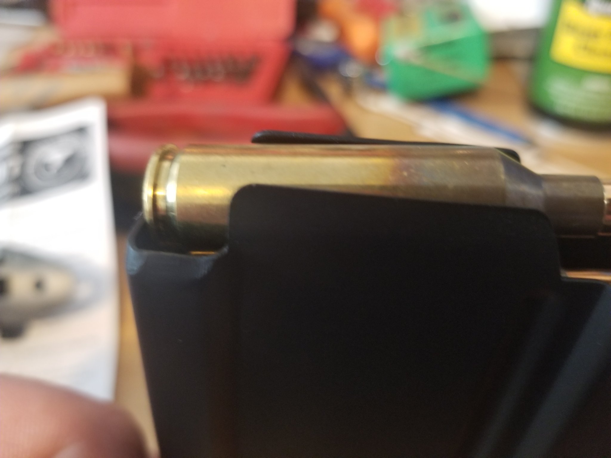

If the back of the round is sitting a little low, it could be the magazine. I had to have them replace on because of that. Let me look for pictures.

The spring on the follower was different than any other magazine including others from them.

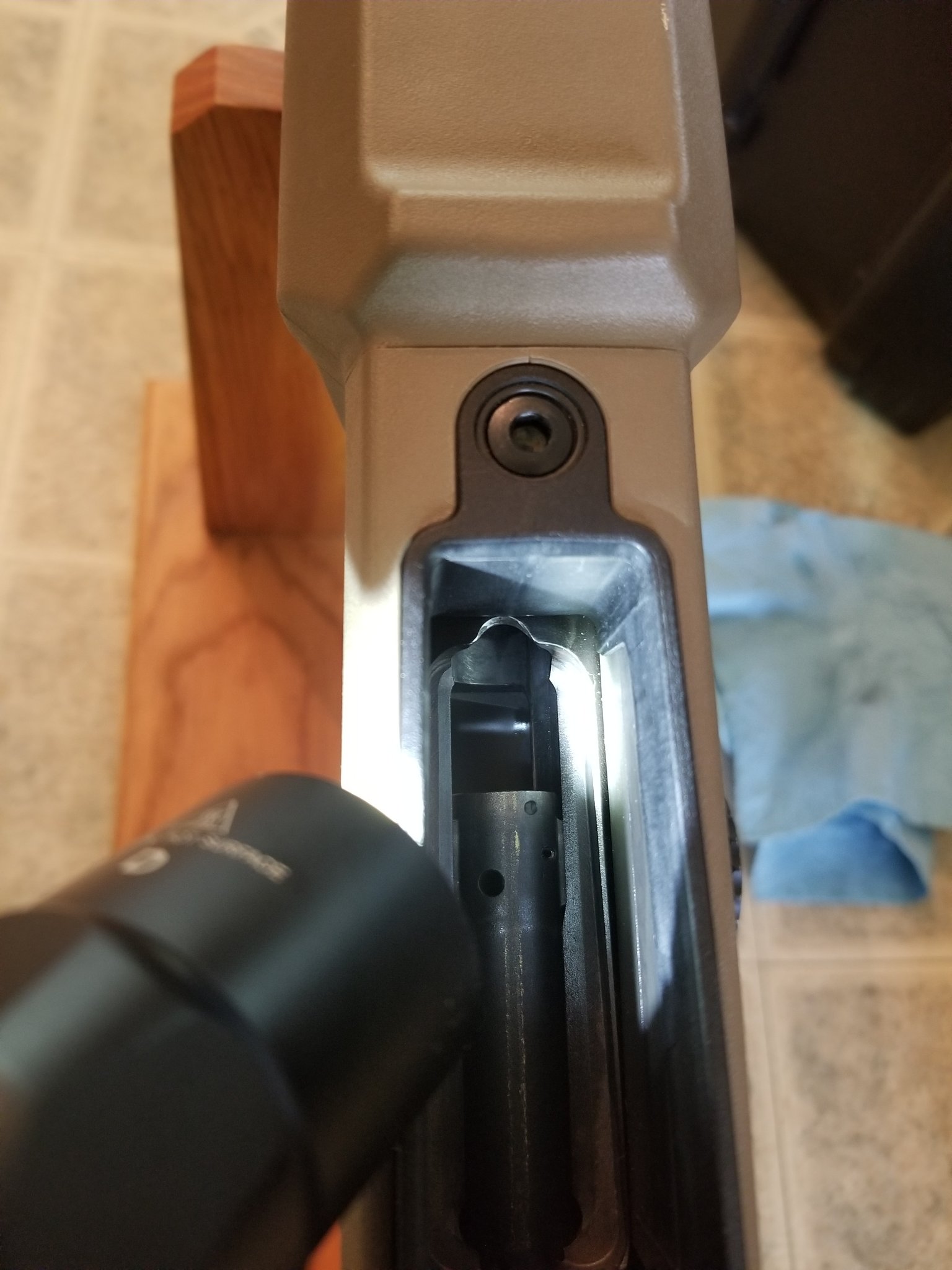

Would you provide a picture of the notched feed ramp? thanks.

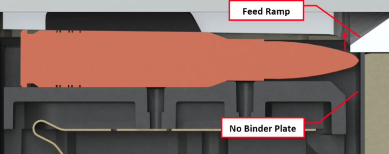

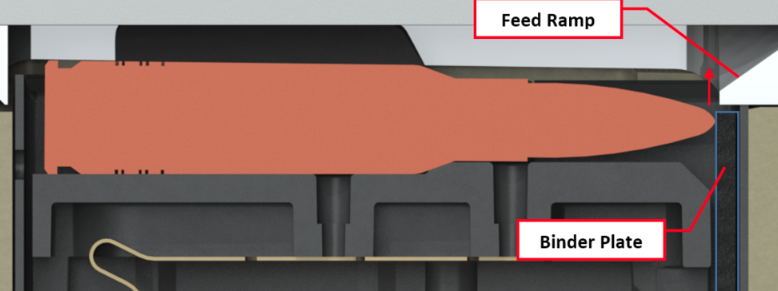

If you're running a magazine without the front binder plate (2.95" COAL), you're going to have to notch your action feed ramp. The front binder plate limits the COAL to 2.88" which is the maximum length for an unmodified action. Under recoil the rounds will slowly creep forward and the bullet tip will get caught under the feed ramp. At that point either you will get a bolt override or you will not be able to close the bolt.
I don't know what a binder plate is?
MDT has some good pictures showing what a binder plate is- a spacer on the front of the mag that keeps the nose of the bullet back from under the feed ramp on the action.
With it removed the bullet can hang under the feed ramp- this is why people notch the feed ramp, magazines without the binder plate can allow them to run longer rounds provided their chamber has adequate freebore to accommodate a round that long.

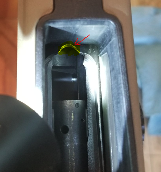

The post right above yours shows the notched feed ramp. See how there is a little curve or almost a "U" milled out of the front of the feed ramp on the bottom of the action. That's what I'm talking about.
Since Im on a pc with a snipping tool Ive arrowed and highlighted the area that has been notched.
