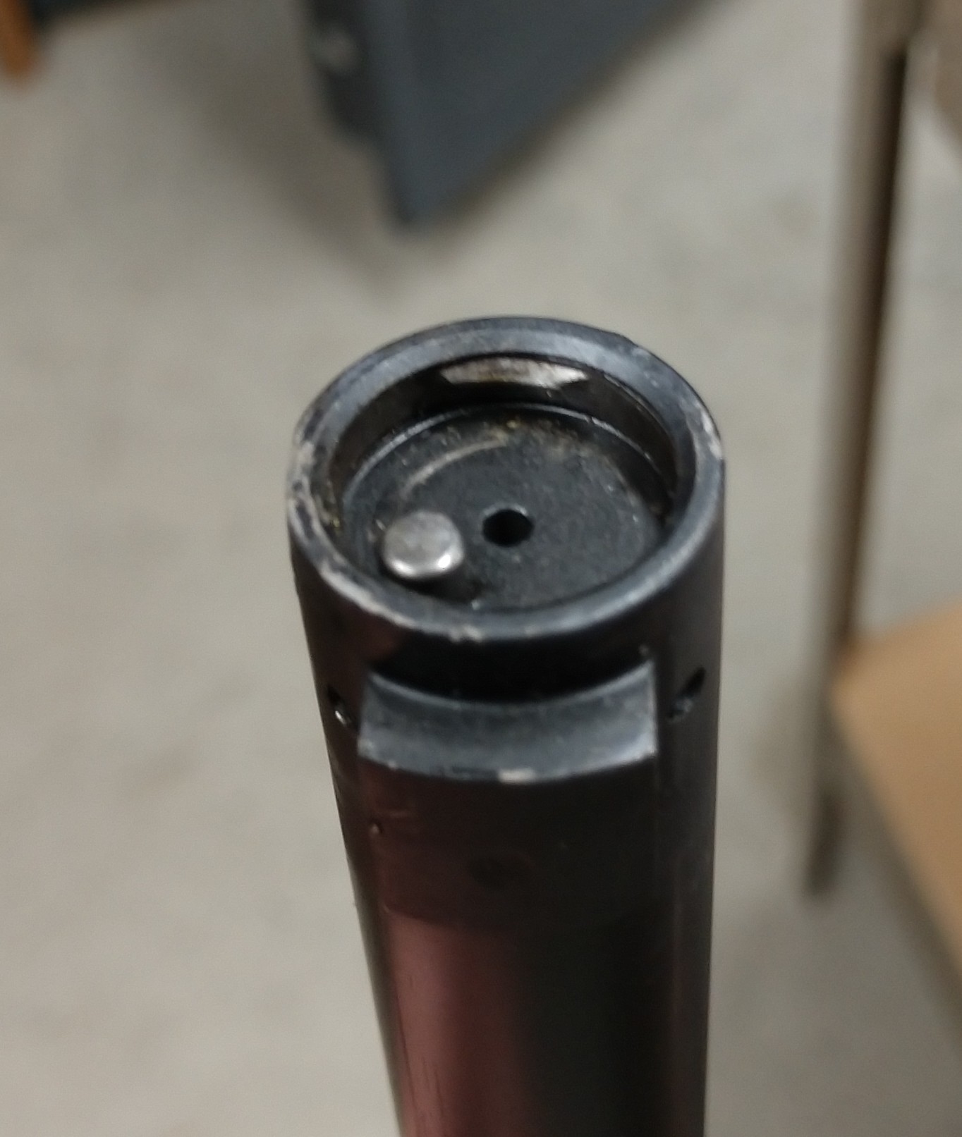

Remington 700 300 Ultra Mag, (American wilderness rifle) brand new with factory ammo.
I had a muzzle break installed and it bedded. I went to shoot it today and the bolt will go forward, but whet cocked down, it stops and will not complete the closer all the way.
I removed scope and base, and also removed from stock, and it still wont close.
Any ideas? I see nothing in chamber.

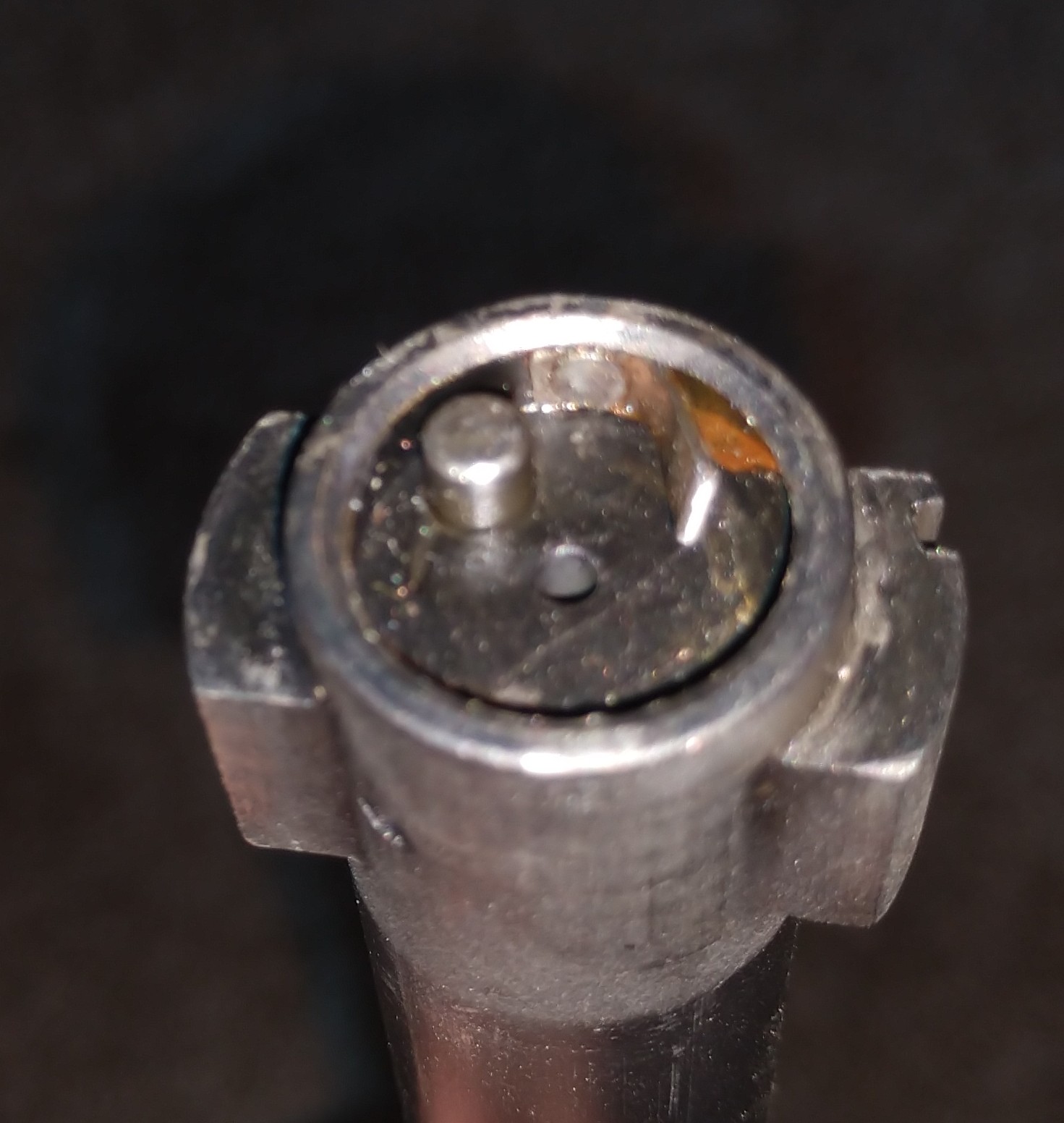

If I manually put the case in under the extractor...then the bolt will close. The case will not go past the extractor for some reason. I'm not sure how the extractor works, seem too stiff to give at all.
If I manually put the case in under the extractor...then the bolt will close. The case will not go past the extractor for some reason. I'm not sure how the extractor works, seem too stiff to give at all.View attachment 6998672
That comment just eliminated a few variables, remove the extractor and see if there is a metal chip or other obstruction/debris behind it.
If it will close on a round by manual insertion it's not necessarily headspace.
Reactions: aljones_315
It's boogered now. Gonna need a new extractor. I've never replaced one but assume you have to drill the rivet out.

Some of them snap in and have a single rivet some have a double rivet. Yours looks to have a single rivet.

I would not recommend a diy fix on a riveted extractor. They are kind of expensive and there is a good chance of boogering it up on your first couple trys. I've also seen the bolt nose undercut pull off due to an errant hammer stroke and a stuck case some time later.
