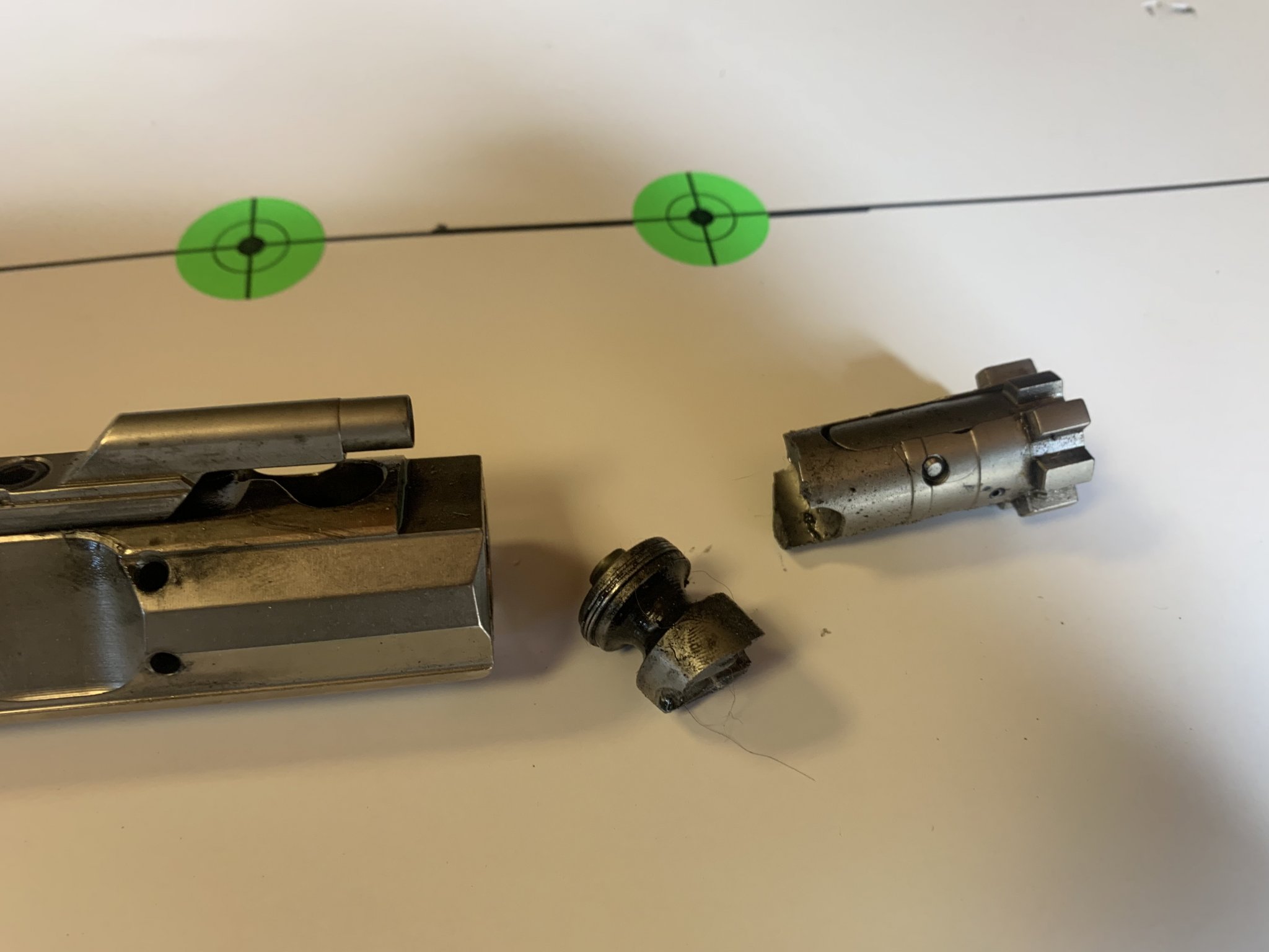

    When you rebarrel your .308WIN AR10 to 6mm Creedmoor, it’s a good idea to make sure you’re running a high pressure bolt.*
    * yes, work was done by well established AR gunsmiths and bolt was properly head spaced.
    Honestly I don't know. It came with an upper a friend gave me about 8 years ago. It ran like a champ for many years consuming .308WIN, but broke after test shot number 3 with 6mm C. These loads were really mild sighters (Berger 95VLD w/ H4350), so I figured the bolt was probably a bit worn out and just didn't like the new cartridge pressure.

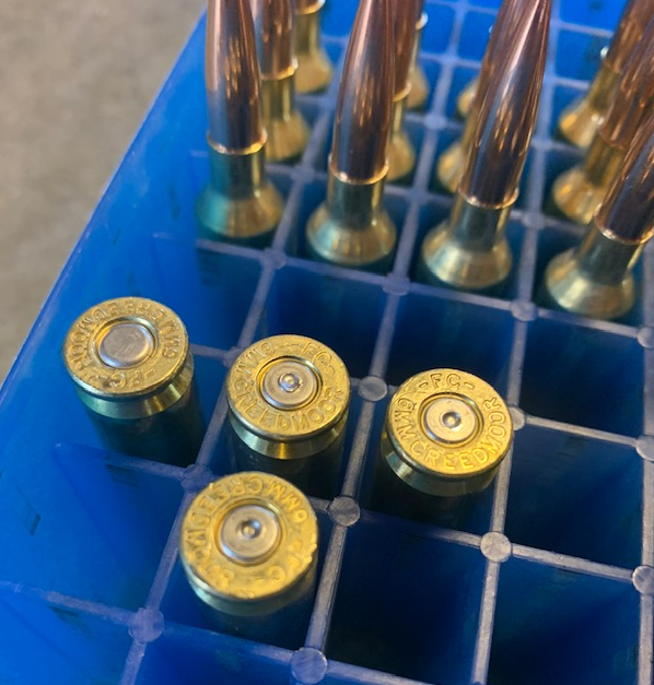

    does a 6cm really create that much more force than 308?
    what makes a bolt "high pressure" anyways?
    My understanding is HP bolts have smaller firing pins to prevent extreme cratering of primers or potential puncture.

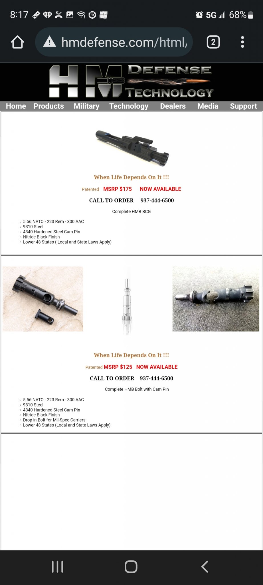

    I've read that Aero's M5 bolts are HP rated and since I have one laying around in a pistol build I never shoot, I figure I'll just drop it in and see how it goes?

    The bolt might have worn in to the old .308 barrel after running like a champ for 8 years
    The rebarrel and 3 shots and blam?
    Crack, crack, break?
    Same cam pin?
    By 'properly headspaced' you are saying the gunsmith installed the extension on the barrel or did a 'Go-Nogo check?
    8 years on a well worn bolt is not saving money in the long run.
    Shoot a AR long enough and parts will break. It is not unusual for this, more so in a big gas gun. Short barrel AR-15 with carbine gas is tough on parts also. Mag dumps are murder on the short guns. Full Auto will eat bolts pretty easily.
    This is true. But there are things we can do to prolong bolt life. Tuning the gas system is #1, and doubly so for a large frame.

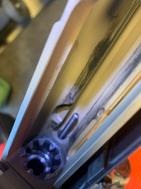

    One other comment - some people mentioned headspace, but a lot of guys fail to understand what it really is and why/when it matters. I don’t see any indication that this is a headspace issue, but if you’re bumping shoulders correctly for your chamber, then your headspace is correct with that brass. Even if it were technically out of spec from a go/no-go gauge. Headspace is a function of the difference between your brass and your chamber so as long as you’re sizing correctly, it doesn’t really matter what a gauge tells you. Conversely, if you aren’t controlling shoulder bump well, your headspace may be excessive even if a gauge says it’s within spec.
    Hope that helps.
    Yup, don’t think it’s a headspace issue. This is with virgin brass, so I haven’t bumped anything yet. 20 years ago I would have accidentally over/undersized brass, but not so much these days.
