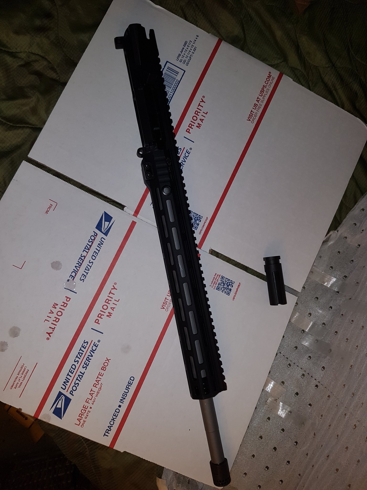

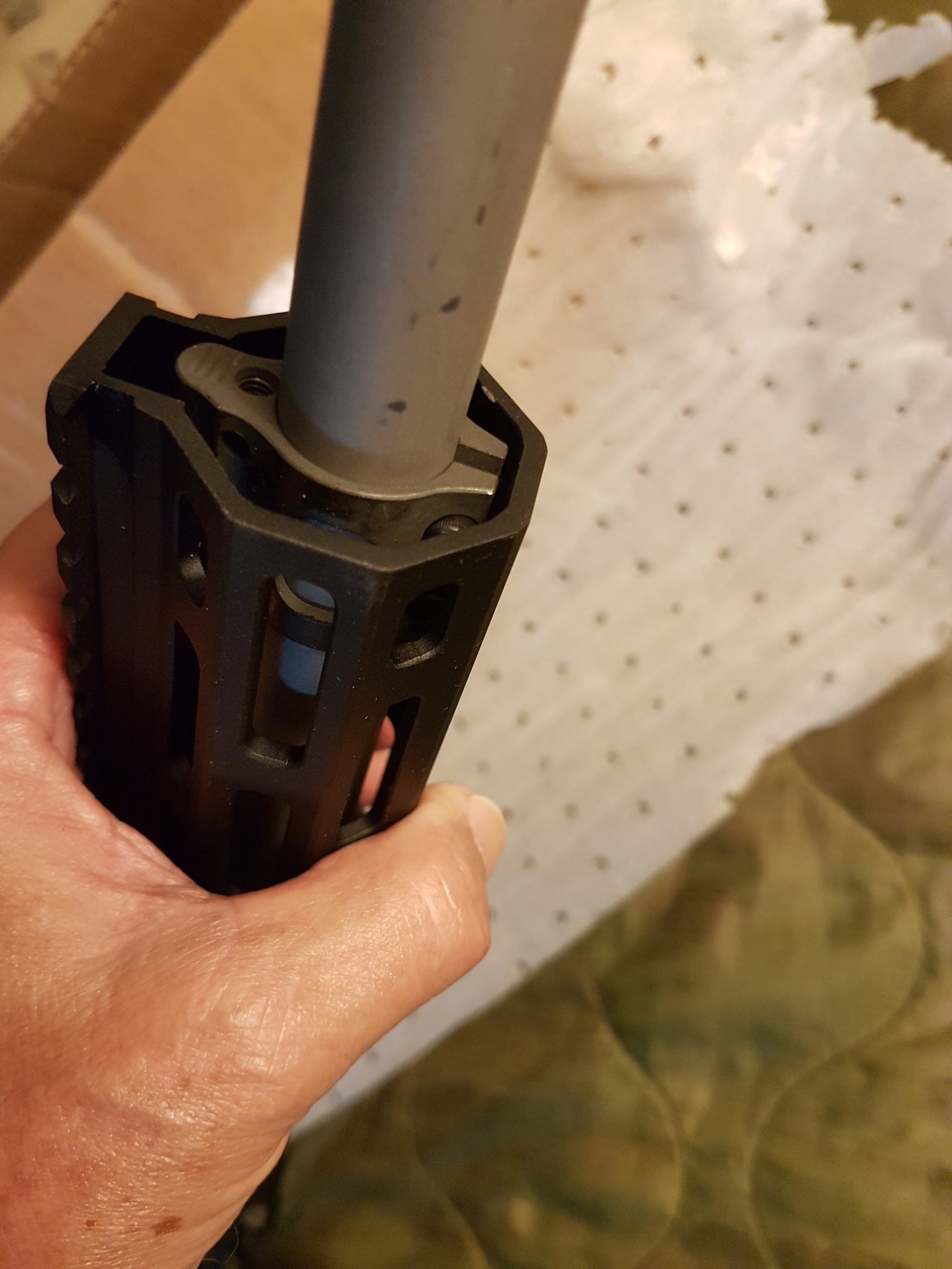

Images of 3 brands of components, BA barrel RLGS, SLR AGB's and CMT handguard. Proven (to me at least based on actual experience) components that meet my functionality requirement and also provide ready accessibility when adjustment is needed without disassembly.
...sometimes we need to avoid that urge to immediately "scratch that itch" to avoid "buyers remorse".....hard as that is at times :confused:

Very true. A handguard and gas block should be chosen to match each other, or at least modify the handguard for access.
Of course that and a hundred other little details like it are part of the difference between a quality rifle and bubba’s “DIY build”. Name brands on parts don’t make the rifle good if you ignore the rest of the details.
