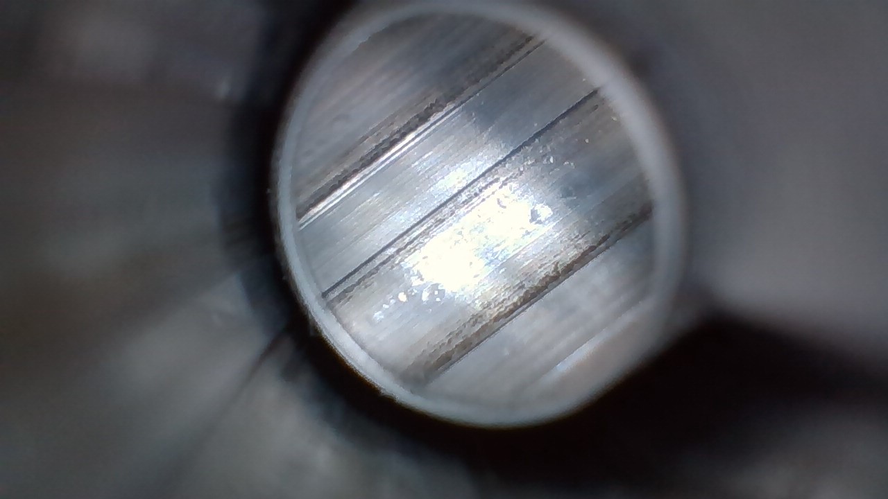

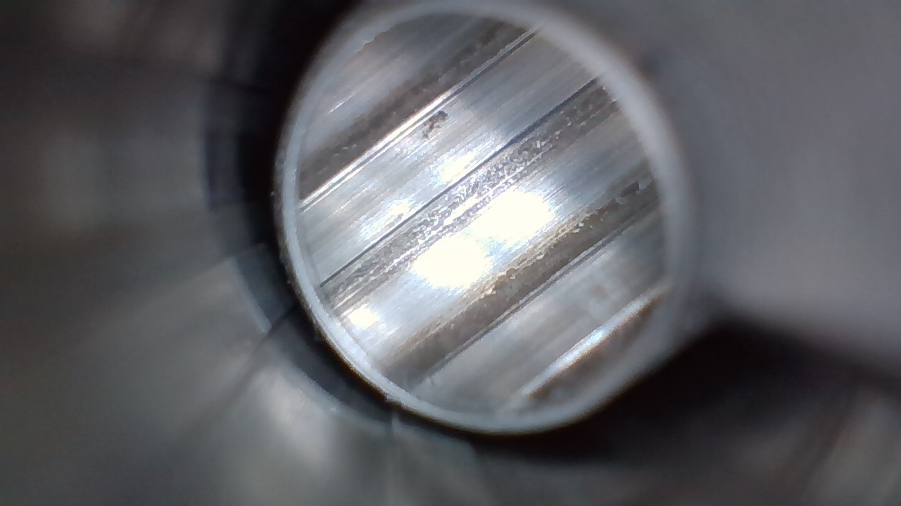

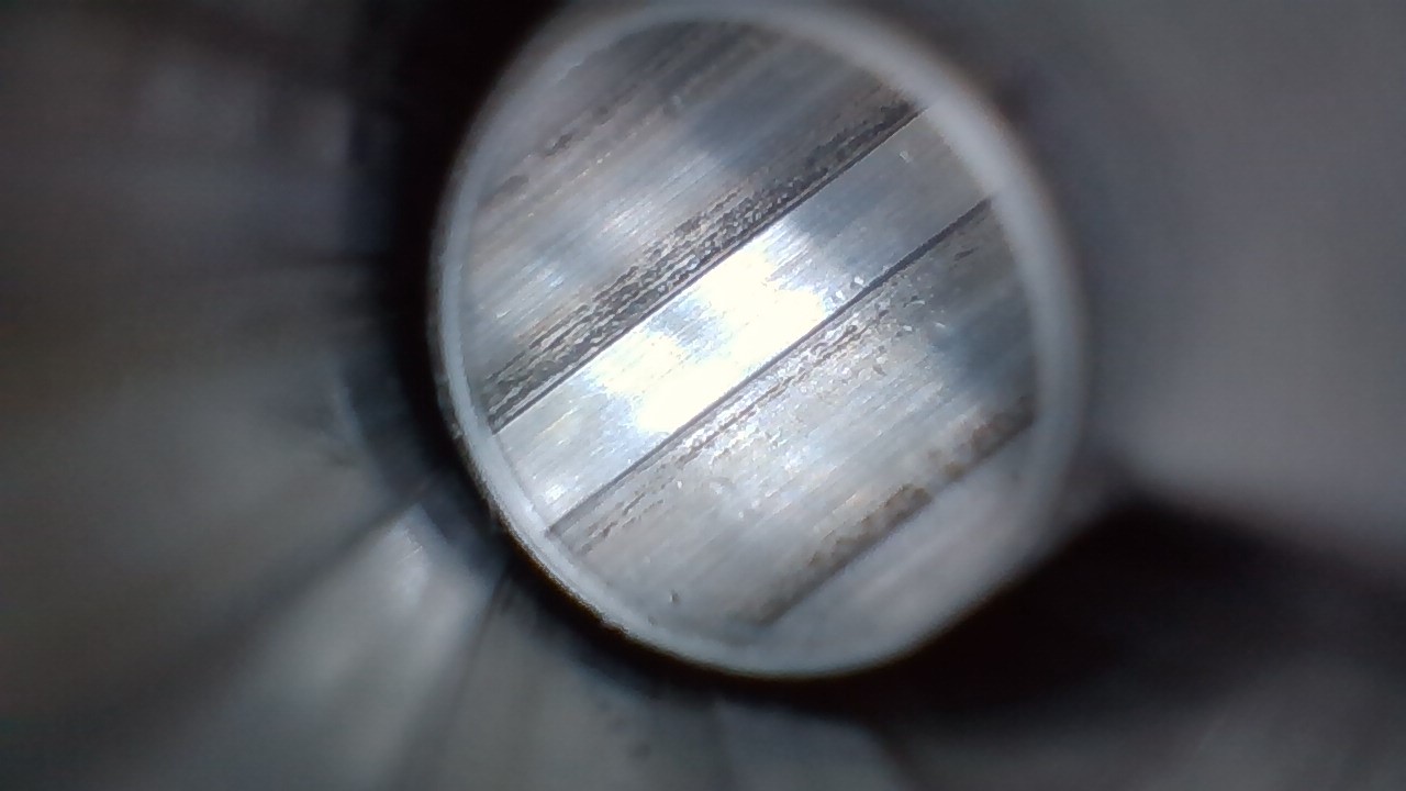

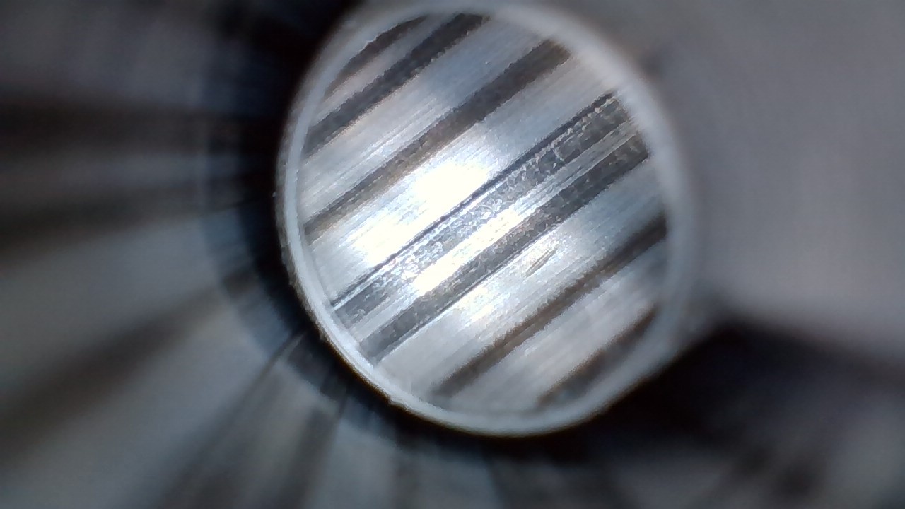

I have new hand lapped barrel chambered in 223 match (long throat) that refuses to shoot and during inspection with a bore scope I noticed a lot of denting and a few pits/gouges in the bore. This barrel has less than 300 rounds shot thru it and will not shoot any factory ammo consistently under 1moa and struggles to do much better with hand loaded ammo. I've tried several bullet/powder combinations and every now and then ill get a couple 1/2 -3/4moa groups but I can never reproduce those results with the same ammo/conditions on different days. I've sleeved and lapped the bolt (action previously trued) and re-bedded the gun twice to get an absolute stress free bedding job. Tried several proven scopes. I've ruled out everything but the barrel. Do the pictures below show a crap barrel or is that not out of the ordinary?

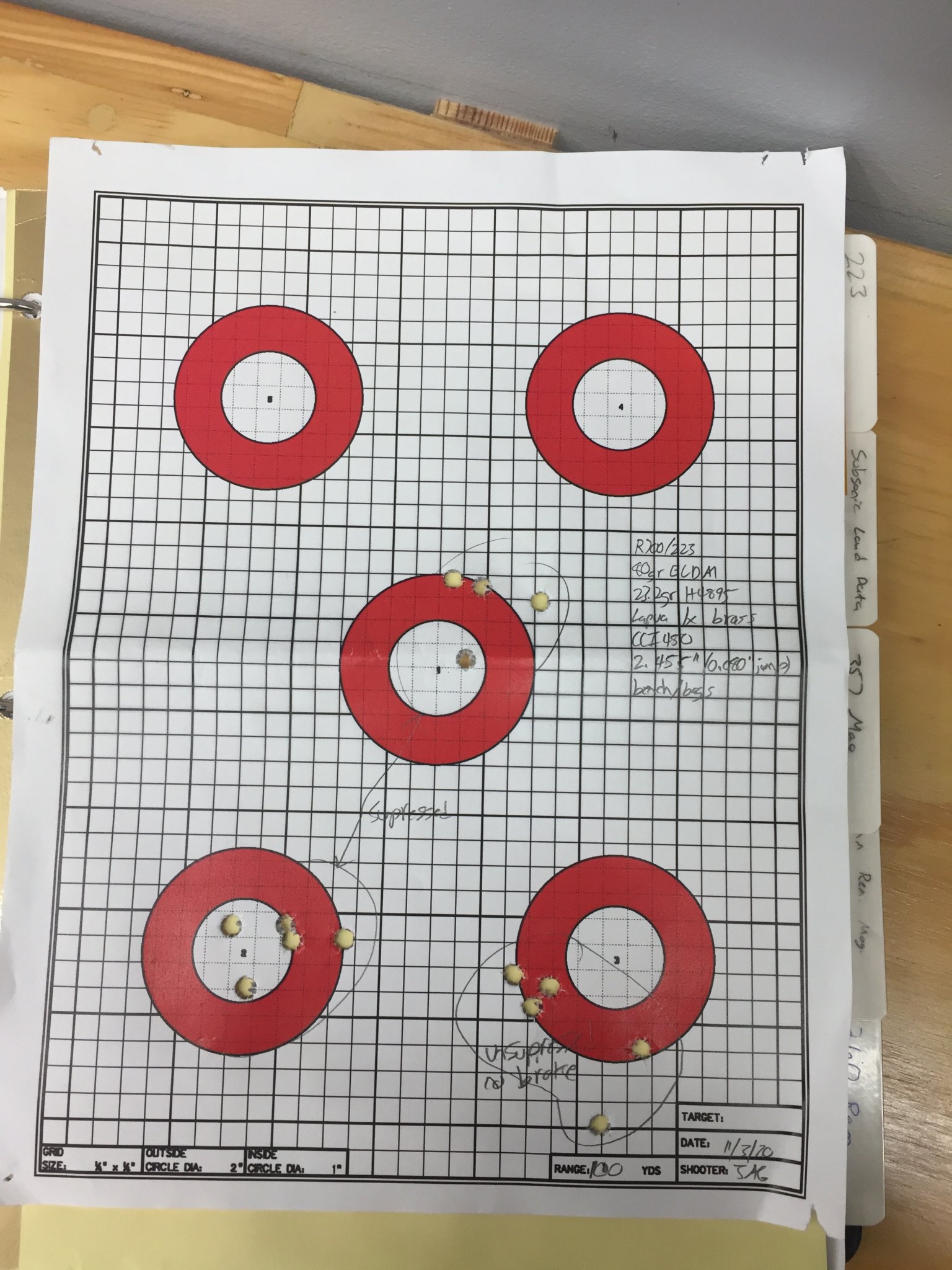

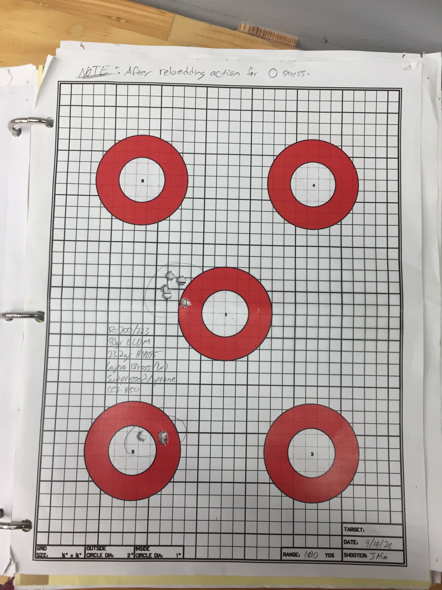

The first pic below was after I reinstalled the barrel and sleeved/lapped the bolt. Had a horizontally strung alternating poi so I redbedded the rifle and got 2 good 1/2moa groups. The next 2 range trips with the same load opened back up to over 1moa. It’s very inconsistent.

It’s not new new, it’s had about 250-300rnds shot thru it but it is stainless.
I didn’t understand why there appeared to be a shiny streak in some of the grooves. Idk I’d that was an optical illusion or there was a high spot or narrow land in that area?
see if your gunsmith has a set of .223 reamer bushings or gauge pins to push down the bore to check for tight spots or a reverse taper. I suspect two things that should be ruled out, a oversize bore at the muzzle from lapping or a crooked chamber. The first can be remedied by shortening the barrel and the second probably means a scrap barrel.
I have been considering getting a lead slug and checking for variations in bore diameter like Gordy Gritters suggests but I’ve never done it and I’ve been putting it off hoping I could solve the problem another way. I think I’ll have the gunsmith take a look it tho.
I had a Harrels precision radial brake installed by my gunsmith but I mostly shoot it suppressed. I’ve shot it with a brake, no brake, and suppressed but haven’t seen any difference in accuracy. The suppressor usually tightens up groups on my other rifles tho.
