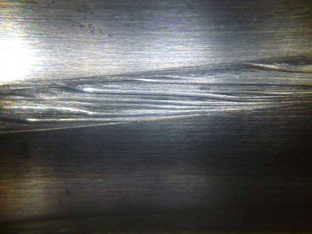

For the most part.... most barrel steels are in the upper 20's to low 30's on the RC scale.
Not using a bore/rod guide will enable the rod to drag in the bore. If using a coated rod it will lead to the coating getting damaged/rubbed off....if using a steel rod now you have steel on steel touching/dragging in the bore of the barrel.
Also think of this....the hard carbon particles in the bore of the barrel as you work that junk loose....they can and will scratch the bore as well.
Also think of how some shooters clean with abrasives and clean the bore of the barrel like they are trying to unplug a clogged kitchen sink or toliet! Sometimes no finesse at all! Just give'er!!!!!
Look at the attached picture....this is what a brush and an abrasive cleaner does to the bore. I've seen the damage start with only 100 rounds on the barrel and only like 2 cleanings on it.
WTF. did he use for an abrasive, Diamond dust?
wow, that’s chewed up. N
KG2 bore paste on a brush.
I've seen the same thing with Witch's Brew and a brush as well. One guy wrecked 3 barrels in 6 months. I told the guy (name and location of the shooter is with held :) and I replaced all 3 barrels. He argued with me the Witch's Brew is very mild and won't hurt anything. My reply back was you have to change your cleaning technique. Say what you want your wrecking the barrels. The last barrel was a 260IMP. Had 110 rounds on it and he already polished a full 001" out of the barrel and the gouges where already showing up on the lands. I told him if he called or sent another one in and it looked like these....I was done. I'm not replacing them for him anymore. Haven't heard from him since.
Fast forward like 2 years.....
Same guy....and this is funny!!!! Calls one of the bullet makers bitchin they're bullets are blowing up! Bullet maker calls me and wants to go over all the things that can cause bullet failure. So we got into cleaning. I bring up the scenario above....didn't say the guys name but said what he shoots in and what State the guy is from...bullet maker goes....is his name so and so? We just found our common denominator! Called operator error!

Well the guy was a good customer and had purchased quite a few barrels from us. So I was trying to help him. That's the only reason why. Once I pinned down what he was doing/what was going on and tried to talk to him about it....I hit a brick wall. He basically said that's the way he's cleaning now and he's not gonna change it.
That's when I was done!
