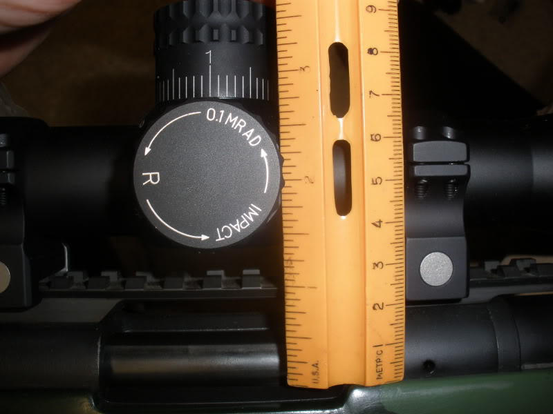

My rifle has a 40 moa mount and I have always determined bore height from the center of my front ring to the center of the chamber gas port. Is this method correct or should I be measuring from the center of the rear ring to the center of the bore? Thanks
I think most commonly it’s measured from center of windage turret to center of chamber. At least that’s how I do it.
Yup center of bolt/bore to center of the windage knob. Doesn't matter if it's a 40 MOA base. Takes about 5 seconds and no match with a ruler or calipers.
I've always done it by measuring from the center of the scope ring to the top of the bolt then adding the radius. I measure the diameter of the bolt and divide by 2 to get my radius, then add the radius to the overall length. Should be pretty damn close to dead center that way. :)
Similar, measure both diameter of chamber and diameter of scope, add the radius of both, then take easy measurement from bottom of scope to top of barrel and add that number to your diameters# and should be perfect.

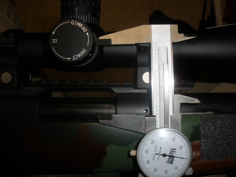

As a math nerd, I get my BH super precise using calipers. I open the bolt and measure total distance from top of eyepiece to the bottom of the bolt. I then measure the eyepiece diameter and the bolt diameter. Finally, I subtract half of the eyepiece diameter and half of the bold diameter. That gives you the precise measurement from the center of the scope to the center of the bore.

Better watch out math nerd in that on a base with moa the rear of the scope will be higher than the objective. Oh man your number is not precise to the 4th decimal point!!!!! Better do the objective side and then measure the length of the scope and figure out the center point and then get the average. Lol
