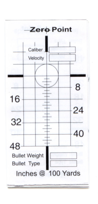

I think the reason Leupold gave up on their magnet illuminated bore sighter was people were just taping up their provided chart on a wall. Putting the elevation at line 8 is a typical 100 yarder. A cheap laser boresighter in the muzzle can be used for windage estimation. My experience has been within a few moa on the windage and 1 or 2 on the elevation.
