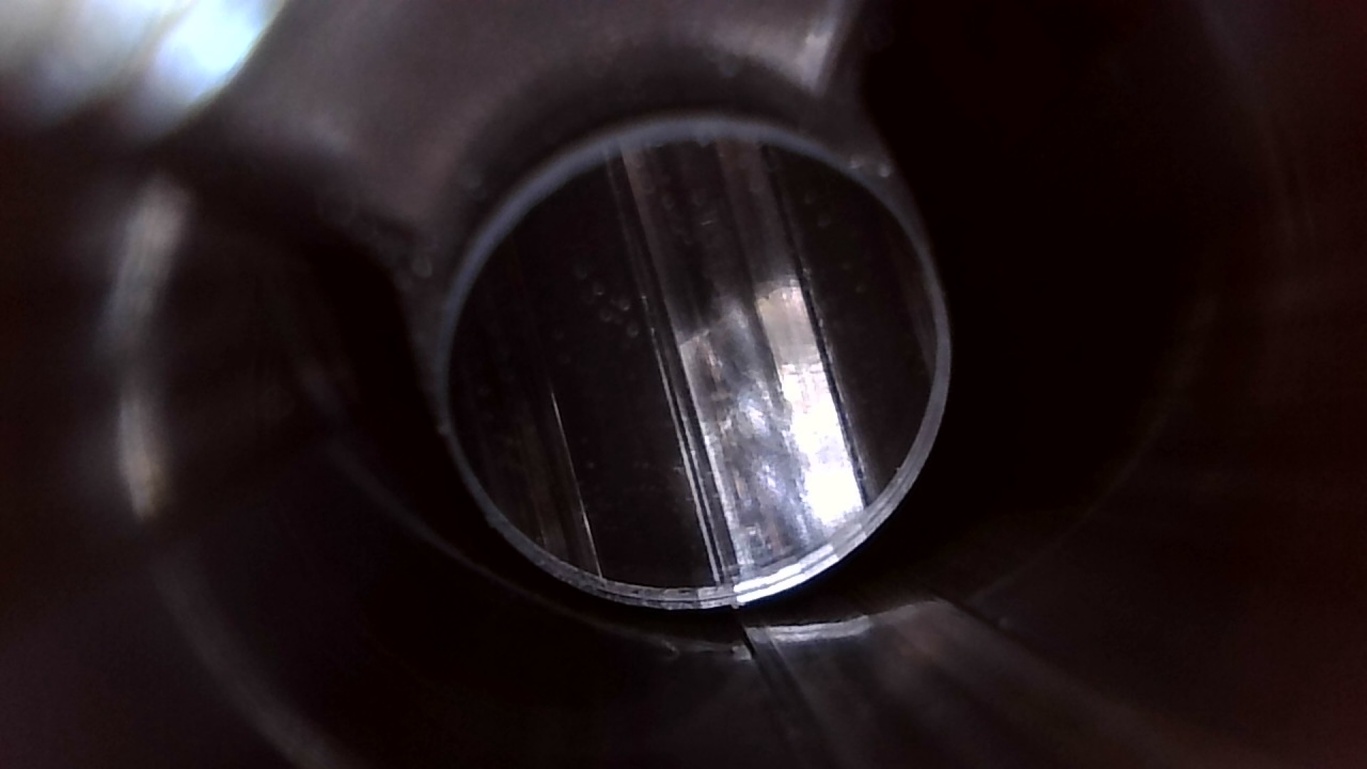

Hello, here is what the bore looks like after non-abrasive cleaning or brush use. It is a 6mm BR with moderate loads and a custom, hand-lapped stainless steel barrel .900" at the muzzle and 26" long. I broke the barrel in with the 1 shot, clean, 2 shot, clean, etc. and clean it with Wipe Out or Boretech eliminator every 30-35 rounds. The first picture is just where the lands start (no carbon ring noted), the 2nd is about 13-14" mark and the last about the 20" mark. I'm assuming this is carbon fouling. If it is, I may try CLR as the other two failed. Thanks,

I don’t see a problem with that level of cleaning and believe you are jumping a bit at shadows.
It probably shoots better than I can shoot it. Using new brass, I average 0.6 with a variety of powders and bullets. I'm narrowing down to 1-2 powders that aren't impossible to get.
If it shoots that well, I would warn against Borescope Hypochondria.
-Stan
I know right...my Tikka T3x UPR in 6.5 has scratches and a few gouges and it shoots just fine.
A good rule is to leave that damn thing in the closet unless you are seeing real accuracy or consistency issues lol
or...if you are the mind type that likes to investigate for details, then take a purely observational view. That is, NOTHING you see on that camera implies or means anything as far as shooting goes. As long as the rifle remains accurate and consistent, then your viewpoint remains observational only.
What is the question in this thread? What are you trying to accomplish with all of this cleaning? What is the use case for this rifle? Is this a cleaning schedule that is in line with the use?
If you want to get the carbon out of the land corners. Follow your current cleaning method with bronze brushes and a cleaner like Ed's Red, Hoppes or any other that isn't a copper cleaning solution. If the bore starts to get rough feeling, usually between 5-600 rounds hit it lightly with JB bore paste to smooth it out.
Lightly with the bore paste, scrub the crap out of it with bronze brushes. If the barrel has a little color, that's fine, if you can see rough chunks scrub them out. Don't try to make it shine like a new barrel.
You can work yourself to death trying to clean your barrel, don't. Find a happy medium place that you are happy with and stop. Barrel should feel smooth when you patch it out.
I've gathered there are 3 schools of thought on the subject, 1) clean to bare metal every time, 2) clean in moderation and 3) rarely or never clean. I think I'll pick 2. The photos were included to show even a custom, hand-lapped barrel with <200 rounds, broken in w/1-shot, clean, 2-shots, clean, etc and then cleaned after every 30-35 rounds, can still look kind of crummy despite use of products that "remove copper and carbon" but evidently not completely.
