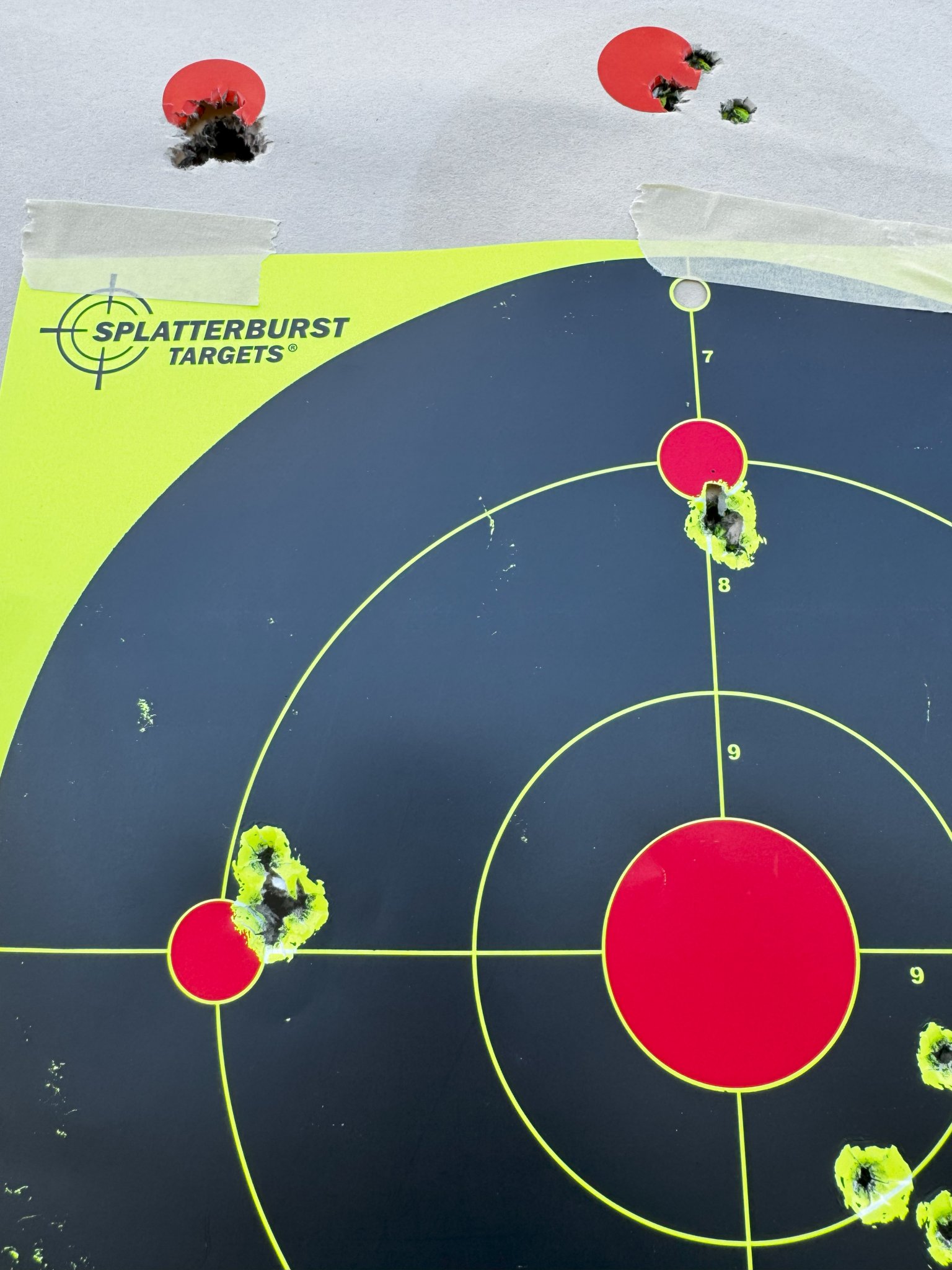

When I first started using this method I didn’t have as stable of a setup and skill and sometimes had to use the shoot at the corners but worst case was 5 shots to get on paper.

My last time bore sighting - newly rebarreled 308 - 100 yards:
The first three rounds are the lower right.
Bore sighting ain't difficult, and using this method means one less piece of equipment to worry about.
