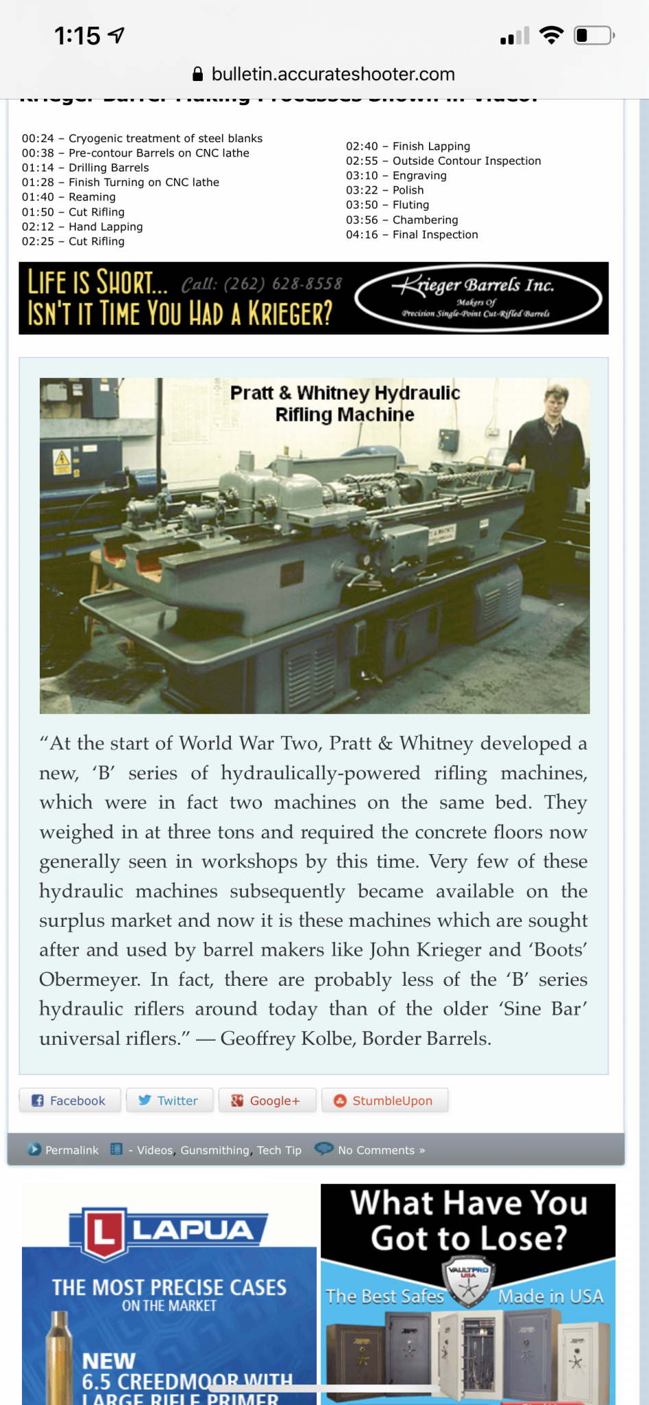

Says who? So your bores are all perfect? What do you mean “non modern” barrel making?
Here’s a screen grab of one of the Pratt and Whitney sine bar rifling machines used in Kreiger’s shop. It’s about 90 years old so somewhat less than bleeding edge of technology I’d say. Probably step motor controlled by now, but iron is iron. If you’re lucky enough to have a Kreiger, there’s a good chance it was rifled on one if these. Would you cull a Kreiger?
Even if you have a barrel flawlessly rifled with alien technology, you’re still going to have an ape like me jam an imperfect reamer in it and remove said perfect metal in an imperfect manner, careful as I might be.
