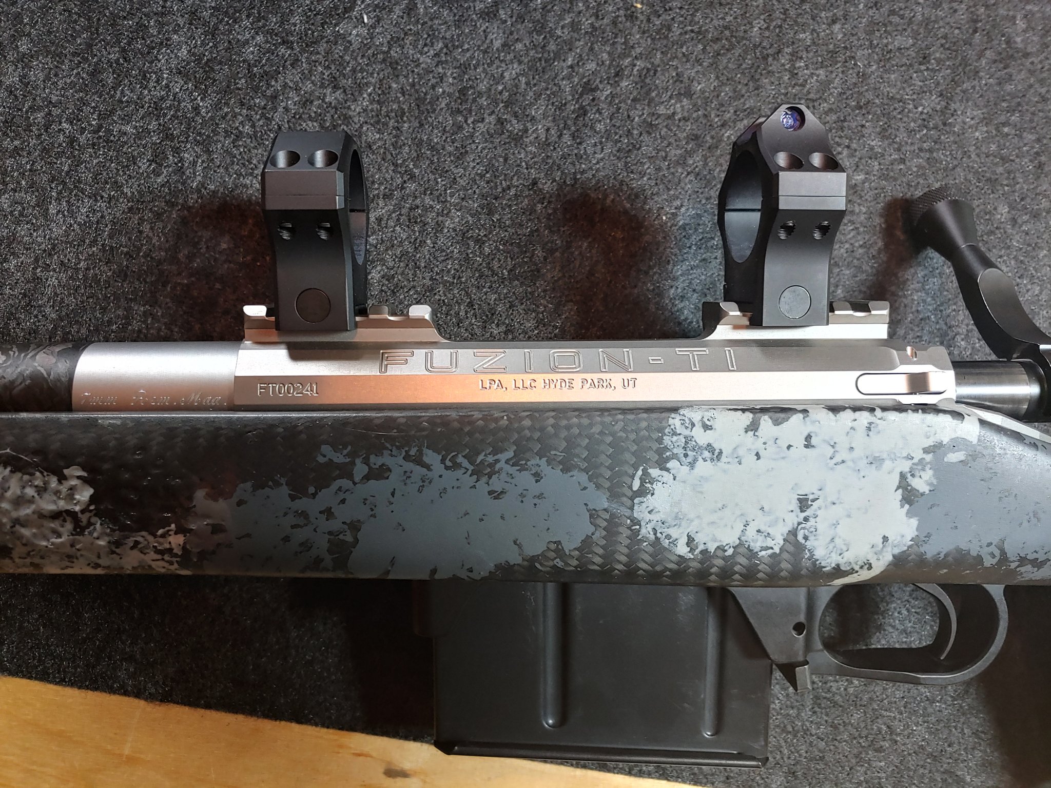

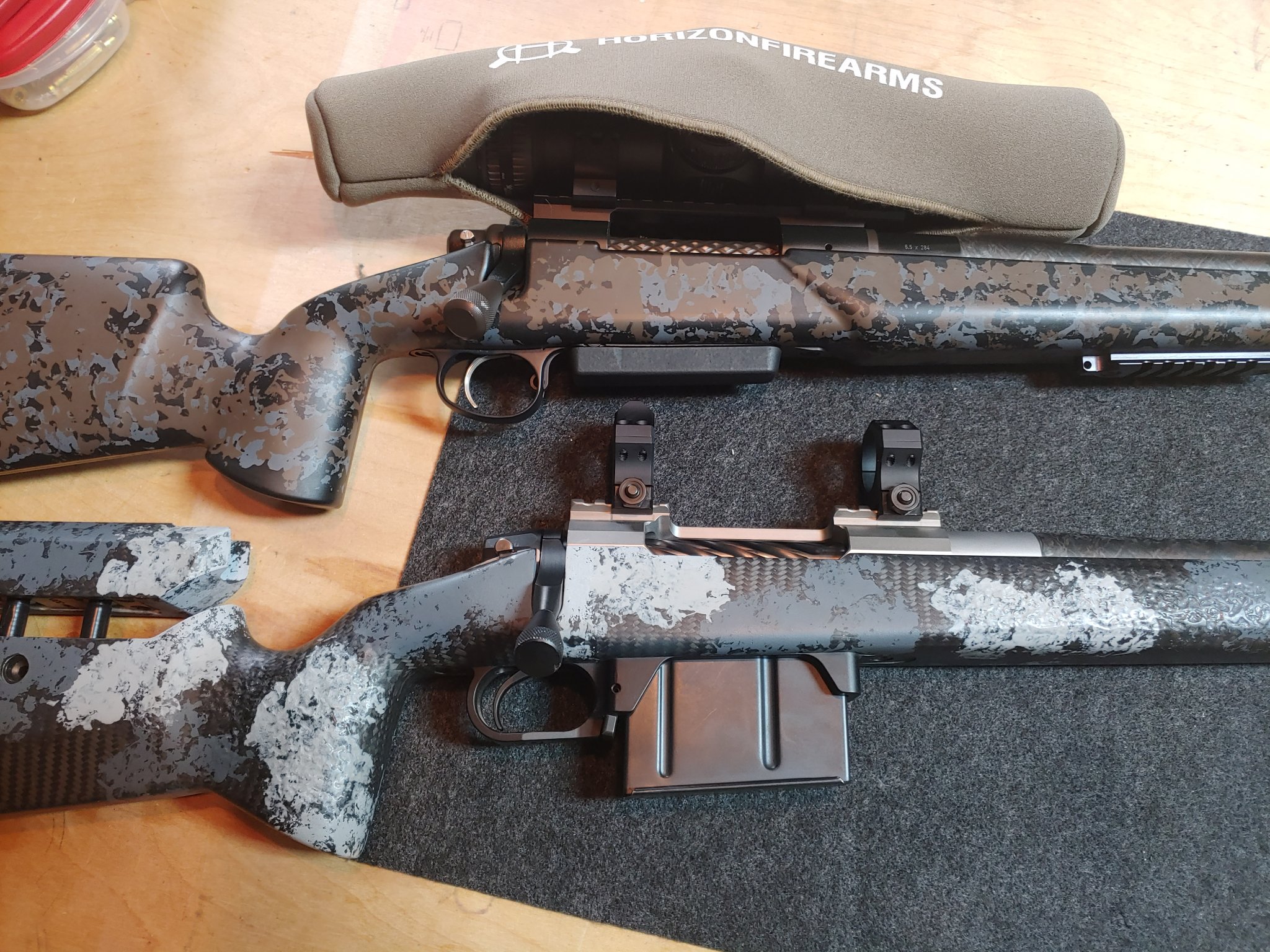

In the pics you can see 2 of my rigs side by side. The flush mount mag has a HS-Precision bottom metal set up. The AI Mag set up is in a Surgeon bottom metal. I prefer a more flush mount style mag with less "rattle" as this gun will be used primarily for hunting.
What are my options here?
Does someone make a smaller profile mag for this bottom metal? Or can I change it our for the HS-Precision? I believe someone told me that inlet is diiferent?

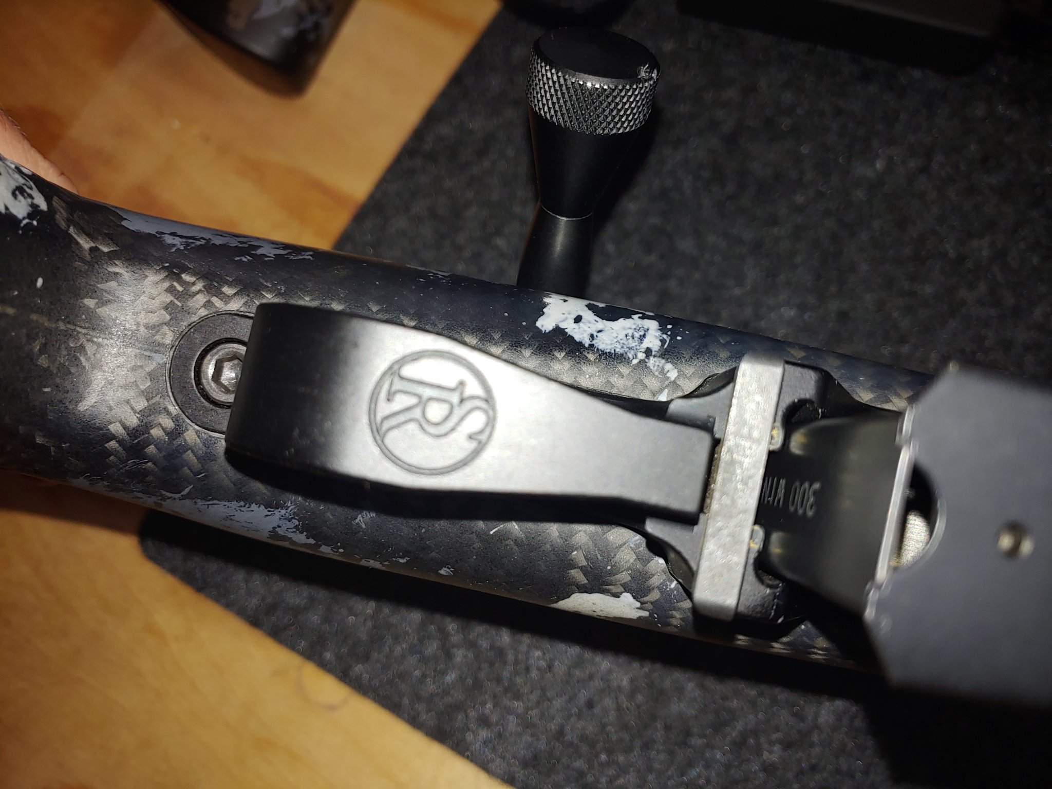

Got it. I emailed HS and they told me there bottom metal fits a factory 700 bottom metal. So i guess the question is how much do you have to enlarge them to fit the M-5 style bottom metal? I wonder if i can swap it out and its a matter of filling a small gap?

The bottom metal will not interchange between the two you have.
Two issues.
1: The "footprint" or outline of the Surgeon and H.S.Prec are totally different. The Surgeon is a good bit larger so it is not a matter of opening up the Surgeon to accept the H.S.
2: The Z-Axis offset or pinch points between the two are different as well. This is basically how deep the inlet extends into the bottom of the stock. Each DBM style bottom metal will have specific (very specific) target dimensions for this that must be met in order for it to properly present the magazine feed lips to the bolt path. That offset dimension is almost never the same from one style of DBM to another.
