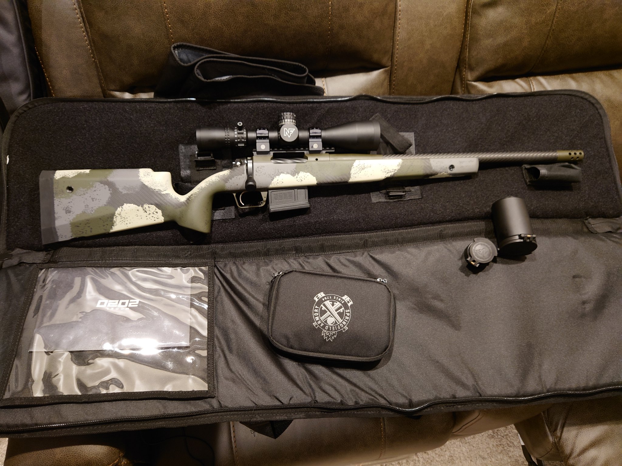

Took the Waypoint out Saturday : Fired 10 rounds each, 5 min cool down at 38-44 degrees between groups of 5.
175 FGMM, .62. And .59
168 FGMM, .72 and 1.3 ( 1 flyer?). 61 not counting
168 HORNADY MATCH. .45. and .48
175 WINCHESTER SMK MATCH. .90 and .85 ( the Winchester SMK loading were 30-150 slower than the FGMM 175. NOT IMPRESSED with the weight disparity of the 20 rounds as weights were all over on my grain scale.
I need to upload the target. Soo far I have been shooting without the brake for a baseline. I will try with the brake and suppressed with both Omega, harvester and TB ultra. Hopefully before Xmas.
Also, I don't care for the grip on the AG stock. It is too thick to hold like I am used to. The distance from the swell to the trigger is also more suited to a bench gun than a hunter. Others seem to think it's fantastic. To each his own... I called AG and inquired about sanding it down and was told the carbon is too thin and would probably get into the "fill'.
I work in a hospital so the outbreak of COVID in my area slowed down my shooting. Better late than never... Here are my thoughts so far:
Waypoint 2020- 260 rounds so far. It is a solid 1/2 MOA rifle. Short word descriptors, solid, reliable, consistent. The action is excellent, slick, little movement, controls the rounds well moving out of the box, light bolt lift. The trigger tech is really good. The carbon barrel is consistent without stringing when it heats up. Something that is seldom mentioned, the pic rail on the receiver is pinned for recoil as an added measure. This is something I have only seen in the hard kicking big bore customs. This will be my go-to for most of the hunting I do.
It does not like Winchester ammunition. The 168 win match is 1.3 moa.The 168 ELDM is the most accurate factory round. I have fired many sub 1/2" groups with 168 ELDM and Amax hand loads. 175 gmm is .65 MOA at 200yrds but .95 MOA at 100. My current load is 168 Amax, imr4895 39g cci 200 @2650.

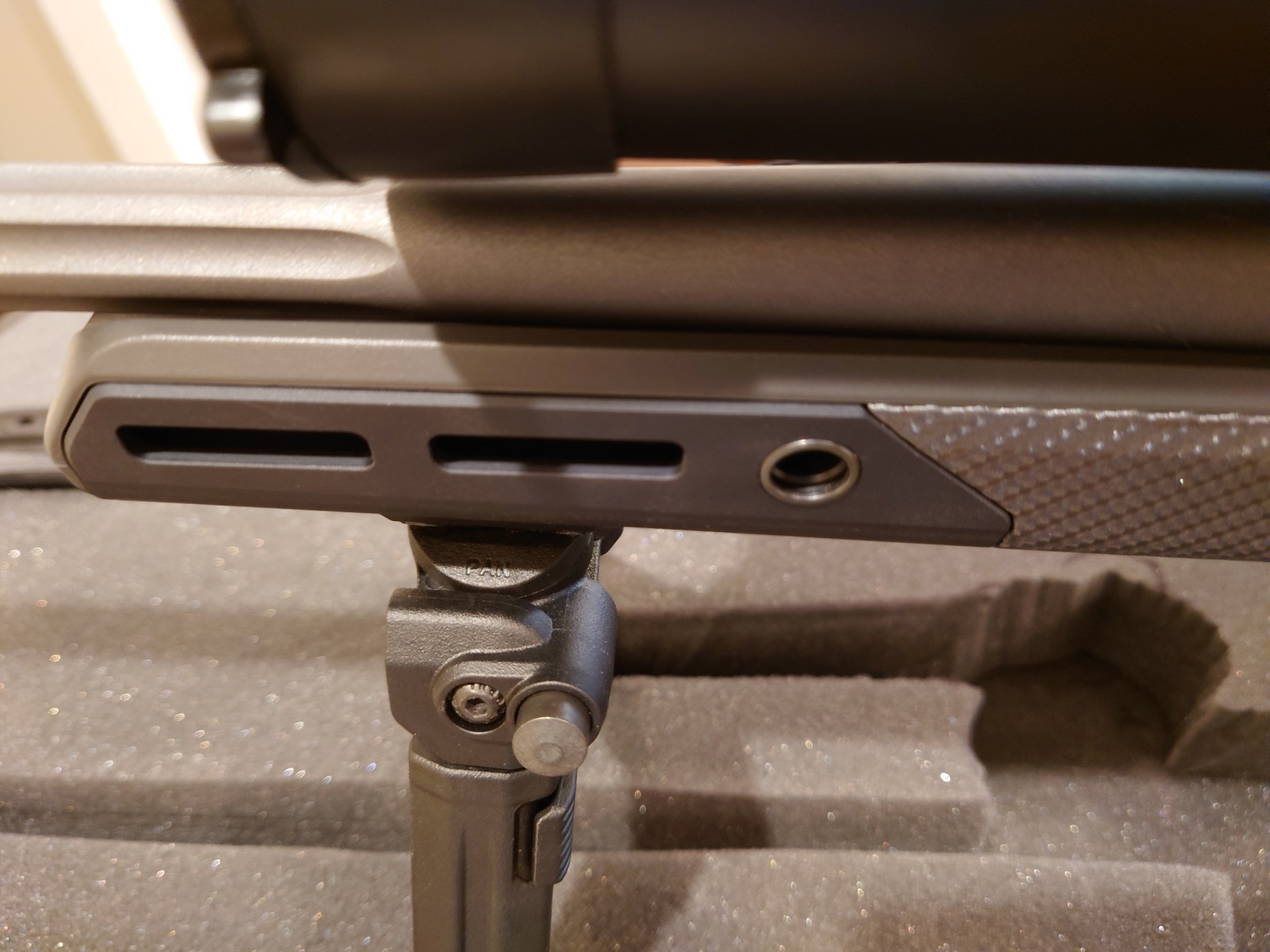

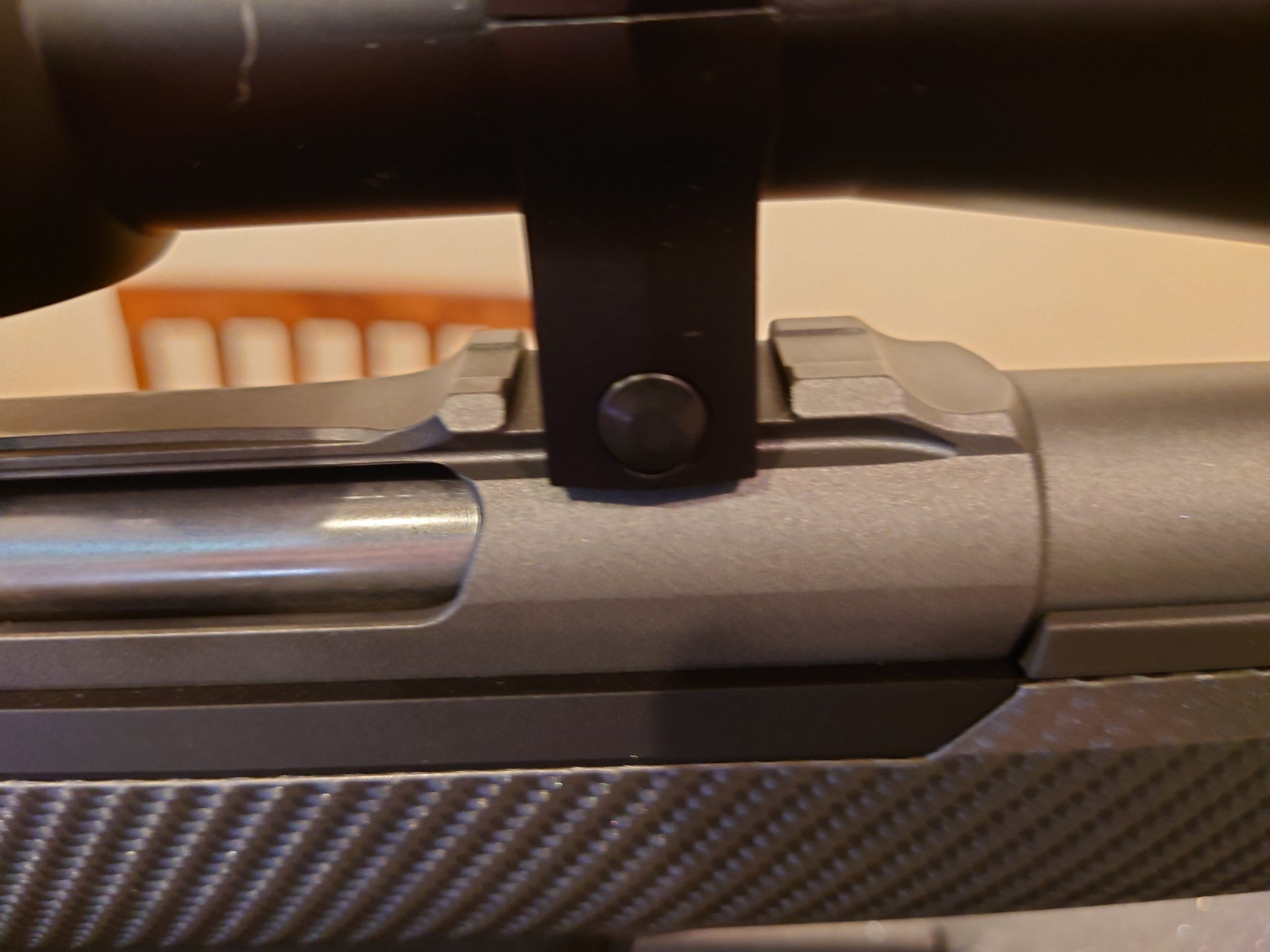

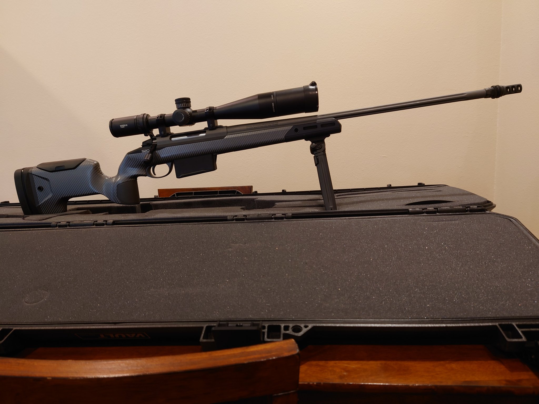

Next up is the SAKO S20 in 6.5prc..
This one came into the fold just recently. I'm so impressed with it I had to include. I am just amazed at the quality you get for 1500$ this rifle could sell at 2500$ and be a good deal.
The SAKO comes in 2 versions, hunter and precision. The stock to swap is 179$ and a 2 min conversion. My dealer has a promotion so the other stock is free. My hunter stock has been ordered. This rifle is 7.1lbs on my scale. It is either a takedown or modular, however you want to label it. It comes with a tool that allows the rear portion to slide off and the fore end to lever off. The stock is meant to be a selling point but actually seems to be a detractor for many. It is plastic... It does however have a full length chassis underneath. The qd sling mounts front a rear and the recoil pad are mated to the chassis. The receiver is bolted to the chassis in 3 locations and is rock solid. The outer shell has zero structural duties. The shape is fantastic and I prefer the grip over the AG. The grip is interchangeable as is the entire fore end. The pic rail is machined into the receiver and is perfect. The dimensions are spot on so properly spec one piece mounts fit without issue. The bolt is typical SAKO, slick and tight. 3 lugs, and a mini lever under the safety that allows you to work the bolt with the safety on. The firing pin is mechanically blocked when on safe. I took the rifle out of the box, bore scoped it. (Bore looks like glass) chamber shows fine cross hatching. Just superb machining. The stock fits the barrel perfectly. The barrel channel is interchangeable and rest on the anodized chassis. Mine has a 22" fluted stainless barrel with Tungsten cerakote. I took the rifle out and mounted a Viper pst2 I had on a shelf using Warne mountain rings. I cleaned and lubed it. Took it out on a windy day and fired 3 Rounds of H ELDX 147gr. To get sighted. Rounds 4,5 and 6 are shown in pic. I finished off the box cleaning with 2 patches between each group. (At home it took 3 patches to thoroughly clean. Zero copper when bore scoped prior to cleaning 6.5prc ammo is nowhere to be found so I have brass on order. The H ELDM is easy to find due to the Creed being so popular. If I had the ammo this would be my favorite to shoot at distance. Longer, heavier than the others but a true pleasure to run.

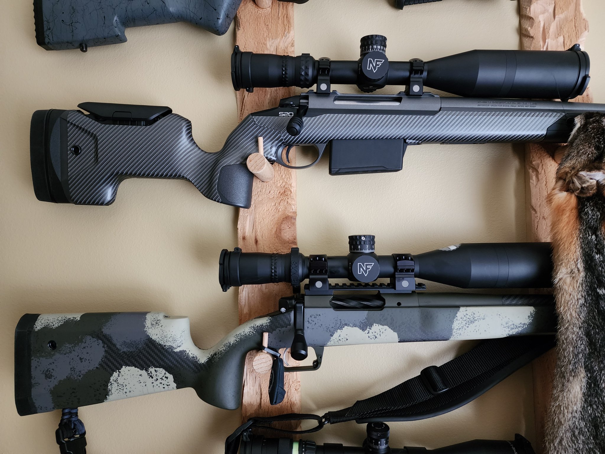

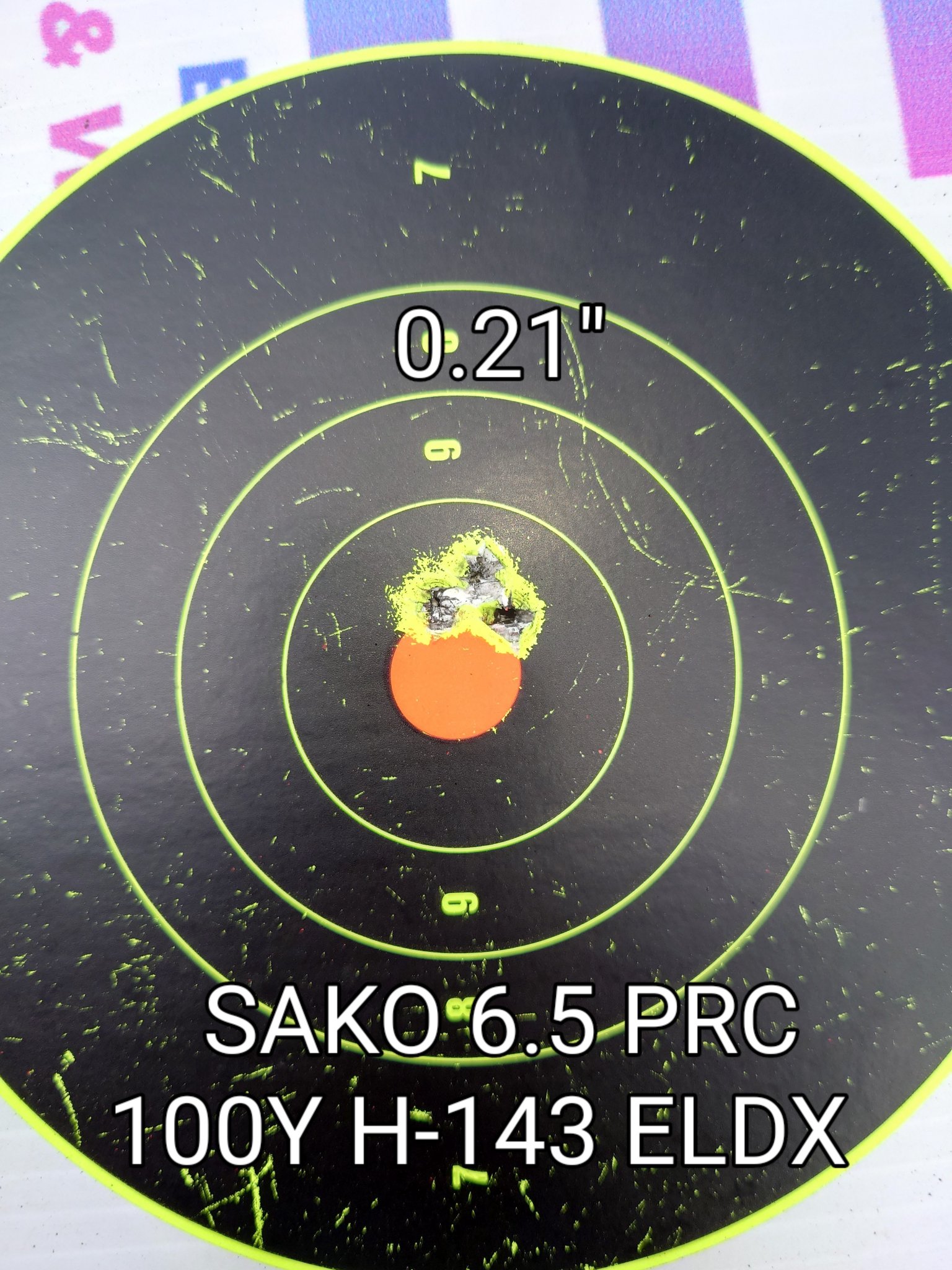

My favorite shooter, the SAKO S20.. I ended up buying a second in 308. It and the 6.5prc are both 1/2" or better with factory ammo. The prc favors the eldx over the m.
The 308 shoots anything under an inch and best with the 168 a max.
Euro op has had them on on sale stupid cheap lately. Worth double the asking price.
My favorite box stand rifle is the waypoint. It favors the 175 smk and 178 eldm.
