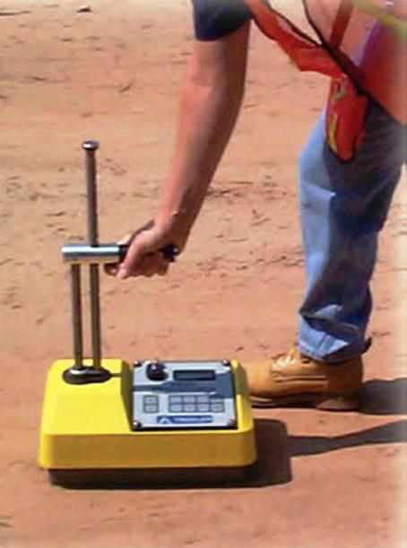

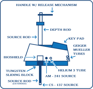

Pound a hole in your just compacted lift. Lowering the rod with CZ137 on the tip, and the computer knows how much radiation gets back to the sensors to judge compaction level on a curve.
Lack of compaction. Backfilling in greater than 10” of aggregate without full 100% compaction intervals with a nuke test on each level.
the approach pavement should "bridge" the aggregate next to the bridge as compaction is harder to obtain against the vertical surface of the abutment. would you suggest adding nuke testing at the approach footing and slab?
Reactions: Bender
Nuke testing should be used on all roadways and foundation substrates.
