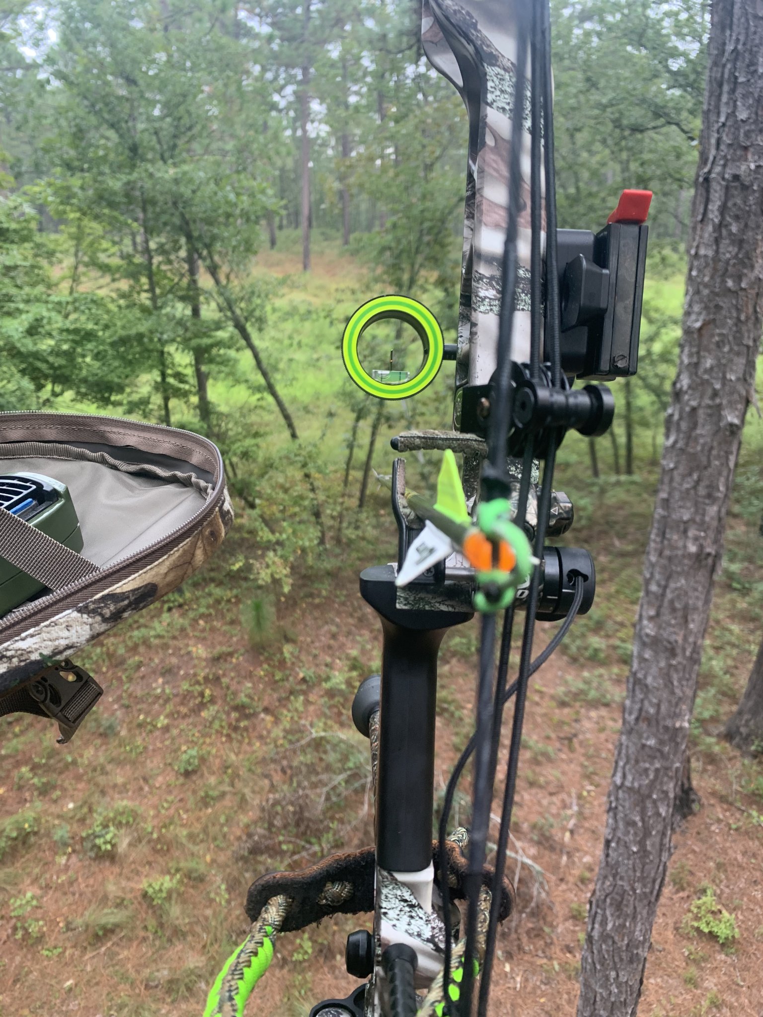

I love my Spot Hogg sights. Bullet proof. I went a single pin setup that has a second pin right below it. Puts me at 20 yards and 38 when my sight is dialed for 20. Won’t Go back to having 5 pins.

Nice. Guess it depends what your hunting and where. Tree stand and deer, I see eye to eye with your selection. Hunting elk in CO, I would never use anything but a 5 pin. Your shot can go from 5 yards to 65 yards in about 2 seconds. No time to mess with anything.

For sure it matters. I don’t touch it if the animal is 5-40 yards. After that I dial the sight. Took some getting used to. They make a great multi pin sight I used for a while called the Hogg it I believe. I definitely want to get back up in the stand! Been about 2 weeks and I’m having withdrawals
