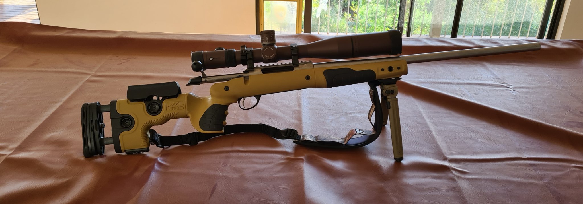

GRS Bifrost.
They have LH options.
Very nice to shoot with.
