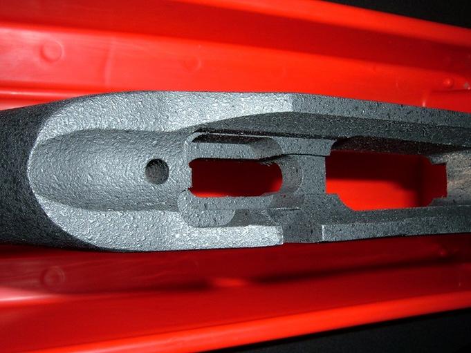

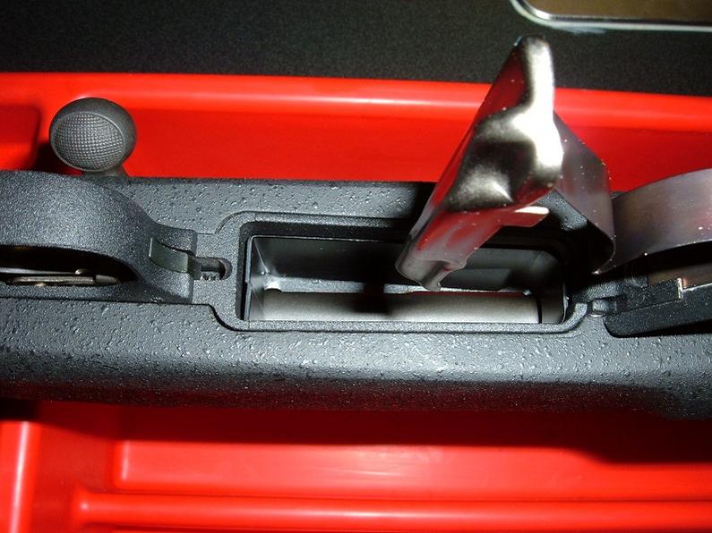

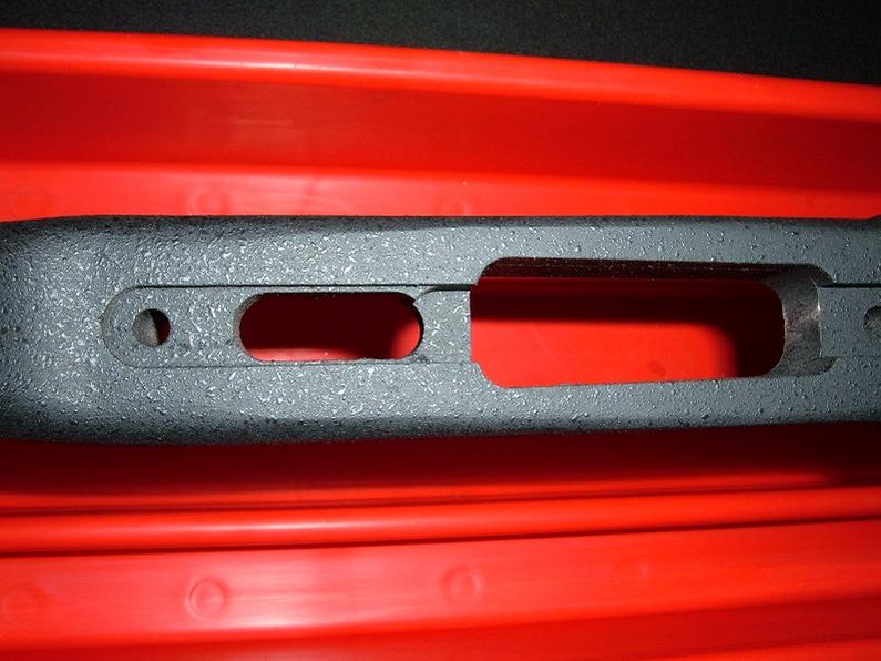

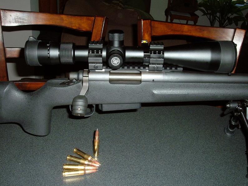

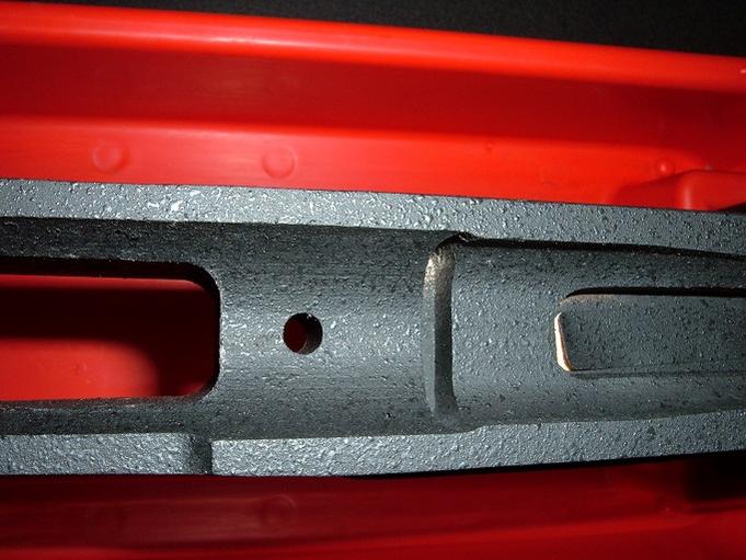

In my search for information I found practically nothing on this stock with regards to a 700. People ask the question but no answers is typical, just references to the rimfire versions. So I was impressed enough to put this out there for anyone else who may have given this a thought.
This is my 3rd stock from Boyds, one Thumb-hole stock on my daughter's Marlin and my Savage Mark ll TR came with a Tacticool stock. I was debating between a B&C Medalist Style 2 and 3 along with this stock. Being partial to wood, I kept coming back to this. So let's get started...
Most people normally comment on the soft wood that you find on the rimfire versions and I can say you don't have that here. Yes it's a laminate, but much beefier/ heavier as well. Unlike the rimfire version, you get a Monte Carlo comb, you get a different forearm (rounded beaver tail that feels good in my hands). The tang area is different also, like a McMillan. The inletting was very clean, very snug on the bottom side. Someone made a reference to the wood being a heavier(read thicker type) grade on a different forum, certainly feels that way but I have no spec sheet to say otherwise.
I was able to drop in the action and bottom metal without any trim work at all, that impressed me. The stock for my daughters rifle was that way as well. The barrel was floated and not touching. I could fit 2 sheets of paper w/o issue under it. This stock was designed for a bull barrel so my heavy barrel was right at home. The only thing I did was bed the recoil lug area and about 1 1/2 in front of the lug to give a little extra support in that area.
Tomorrow I'll take it on its maiden voyage. I reload for 223 but don't have all my gear yet to do 308 so I have some 150gr SP Monarch Brass ammo that I'm going to run through it for now. Aside from that I added a mag-extender, 20 MOA base, and a bolt lift kit. I'm impressed with this stock.
Hope it helps someone out.
700 SPS Varmit 308
Blackhawk 20 MOA Base
Burris 30mm Rings (med)
Bolt Lift Kit
Mag-Extender
Vortex Viper 6.5-20x50
Blackhawk Pivot Bipod

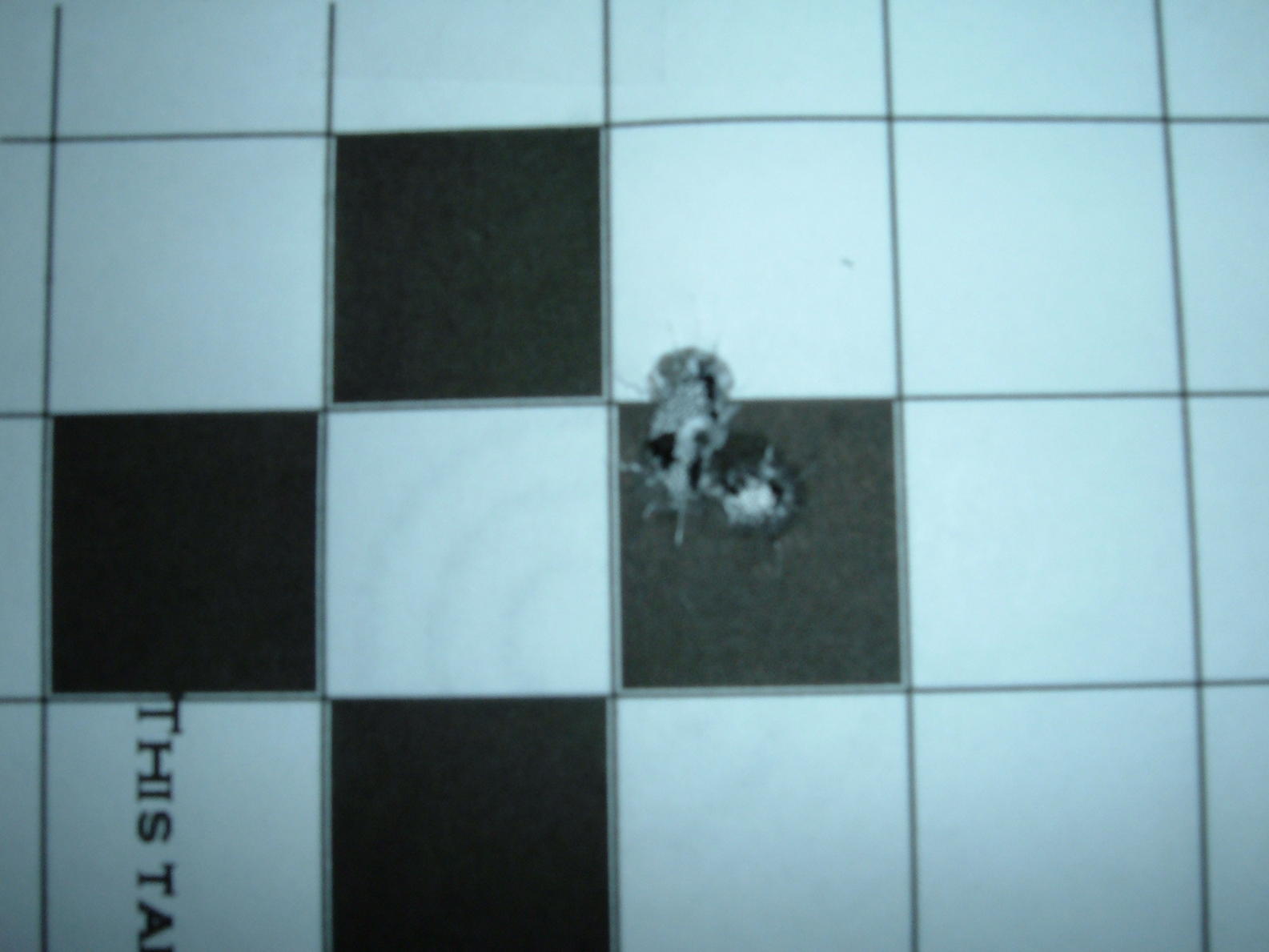

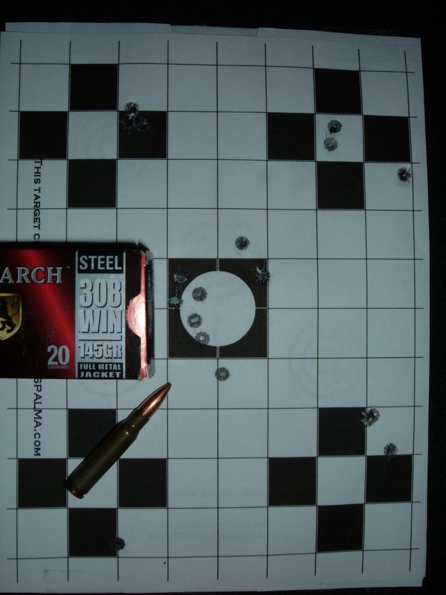

I finally got to take it out Saturday and find out how my bedding job turned out and the day turned into a surprise. My club (Bayou Rifles Inc) had a HP Palma Match 800/900/1k that day that I wanted to sit in and just spectate. I wasn't sure if this was the type of match I was looking to get into and there were only 6 guys shooting that day. A championship match took place this morning that I didn't attend.
I only had 145gr Monarch ammo with me that day and I had done a rough zero at 100yds earlier during the week but ran out of light so this rifle had around 20rds through it. The match director surprised me when he said he would let me get in after the 800yd leg was shot while one set of guys fell back to the 900. I felt/was out of league with the ammo I had but that didn't phase anyone there. It seemed to challenge them to find some dope that would be close for this round considering velocity wasn't printed on the box.
Well Barry(Match Director) took on the role of spotter for me and had me on paper at 800yds in 3 rounds. I don't know what ballistic solver he used and was too excited to ask (just shut up and learn something). Winds were terrible, full frontal, 7-9mph average with gust up to 19mph. With regards to the other shooters, I was surprised to see what I had been reading come to pass, the 155gr Scenar was king that day and being able to make bulls-eye hits in that wind was incredible, guys with good support especially. Anyway, when we got to 900 my 145gr wasn't reliable. Barry told me the cold bore barely made it but after that I was hitting the lane number so that's where we stopped.
I went and shot a few more rounds after the event to establish I had a good zero and then shot a few 3 round groups at 100. The results are below in the pic. The middle I basically used for sight in and then the top left/right and bottom right were the groups with the Monarch ammo.
I'm impressed with the way this turned out. This was the 2nd time out with the rifle, cheap ammo, no established dope but getting to shoot it at 800yds was incredible. I didn't mention the name of the bedding kit I used and it is Pro Bed 2000, picked it up from Midway.
I'm definitely ready to do some hand-loads for this rifle and see how it turns out. I have a 20" AR that's sub-moa at 100yds and 200yds using Varget with Hornady 55gr SP BT's. I'm looking for similar results and better from this 700.
